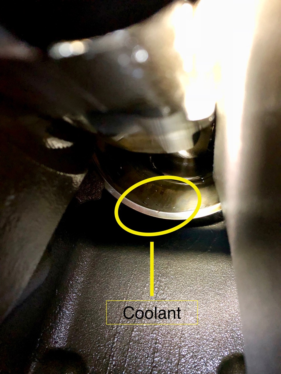

More than likely you have fretted a liner, mine did the same from a crap in frame from a dealership. Coolant was dripping into the #5 cylinder, the only way to find it is to drop the pan, pressurize the coolant system and bar the motor. Messy job, and may take a day or two to show itself.
Here is #5 cylinder in my truck from a few weeks ago, in frame is nearing completion. 2nd one, almost two years to the day. Sad.

Pressurize the coolant system to 20-psi and let it sit for a day. Check the EGR cooler + look for any external leaks. Non found? pull the oil pan and look for internal one(s). if you loosing coolant then it is going somewhere, and if it is going into the oil pan,.. you are rapidly destroying your engine if your still driving it. - it only takes a few Oz of coolant to start washing out crank bearings in a hurry, and gallons? -- It will not last long like that at all.
If you suspect it is still the compressor,.. you will see the coolant seeping out of the bottom of it when the pan is off,.. same thing with the turbo or anything else. It is not rocket science and it can be found. i still stick with my initial guesses though considering you most likely have a bad de-mandate.

Been confirmed today that #5 cylinder is leaking. Inframe in works. Truck has 650k on it.
