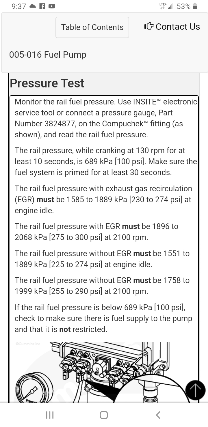

[attachment=6460]
I am not sure how I mixed this up..... under testing the fuel pump it tells you to check the pressure where I did here.....
https://youtu.be/n-QwD6wRa84
Well I've got between 200 and 300, although its sporadic, which may be because the trucks running like shi#t!
I've been measuring the fuel pressure up at the pump itself. Maybe I'm a idiot here lol. Fuel sensor in the morning to start I thinks. Wont solve my running rough issue but itll narrow down where I need to look.
might help the running as the computer is trying to compensate for supposidly 9psi of fuel.
You are checking for pressure at the gear pump inlet - That test point will show lift pump pressure with the engine off, but once you start it, there will be a significant vacuum there caused by the gear pump. Your pressure gauge has likely been ruined or at least pulled out of calibration by the vacuum.
Test gear pump outlet pressure at the fitting on the front of the pump below the ECM cooling plate feed pipe.
Check rail pressure at the bottom of the IFSM right up the front. The fitting points down.
ya, I think in that first video you are measuring pressure on the vacuum side of the gear pump bud. there should be another fitting on the front facing side of that gear pump, on the pressure side of it. I would have to double check a flow diagram again to be 100% though. That would explain why you had your 10 psi with the priming pump and it would be more noticeable with a guage that wasnt reading 0-400 psi.
