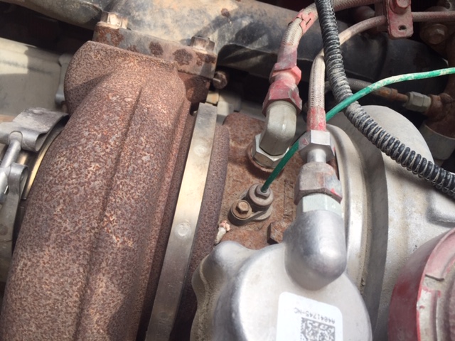

Here are the things he found wrong that needed correction. Drag link, passenger side tie rod end. Carrier bearing, All the brakes are good except the left front shoe has a crack. So a set of shoes for the front. oil in rears he said rear was clean, the front was a little dark. Transmission was clean. Brakes all in correct adjustment. slack adjusters all looked good. The oil line that feeds turbo has a leak. shocks all good. All in all, I`m more than happy with his checkup. His main comment was the truck was well maintained. All three remarked that it was a dry motor.

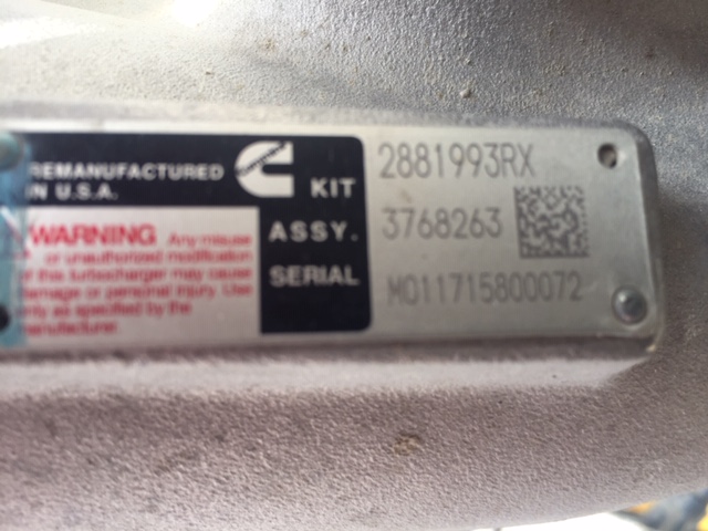

I have an appointment in two weeks. I am having them do the carrier bearing, ( no place for a skinny old man to be crawling around under) and a new oil line to turbo. The turbo looks fairly new. Has a Cummins reman tag on it. I don`t think I want to be replacing the oil line either.

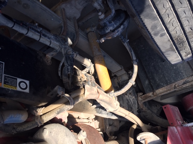

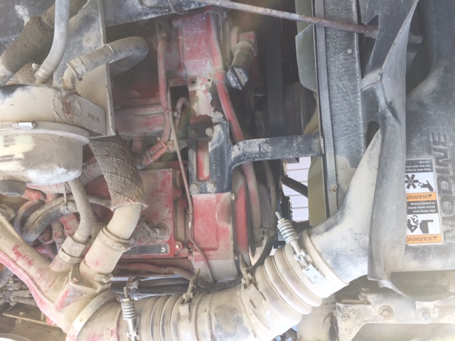

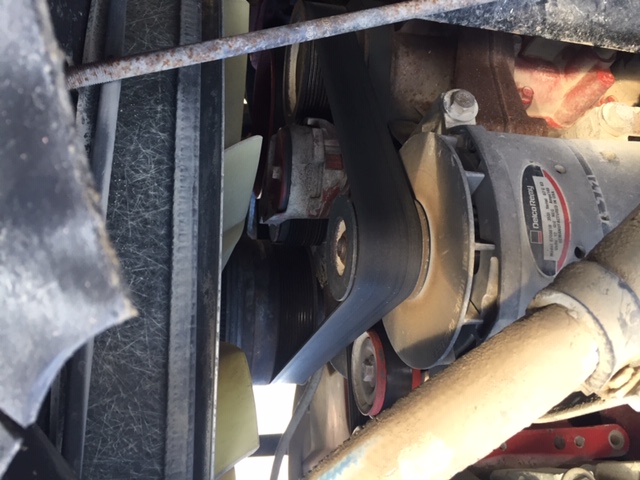

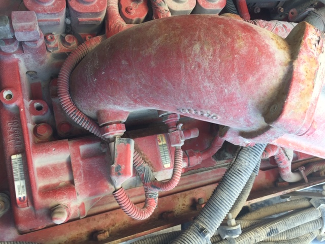

So lets see if I can post pics[attachment=7632][attachment=7633][attachment=7635]

2. I see factory red paint on the front pulleys. Pull the belts of the front and give all of the pulleys a spin and wiggle test. I'll bet you find some that are shot. You'll hear grinding, see wobbling and/or feel movement. Don't hesitate. Just replace them. The can be found for really reasonable prices.
3. More factory red paint on all the sensors all over the engine. Check out Rawze video on an egr tune up. You'll all most certainly find that all of those sensors are due to be changed for 1 reason or another. They are very important. Just change them and don't look back. Link to rawze videos. https://www.youtube.com/channel/UCZ08qn4...LSQ/videos
Scroll down till you find the 6 part series for the EGR tune up. You don't have the exact same engine but you'll find similar sensors in similar places.
The EGR being unplugged is a YUGE red flag. You really need to inspect the cams, that soot is going somewhere. If the EGR valve is an issue, they can sometimes be removed and cleaned, it may still be operational. I would do that, make sure it is operational.

If it's got the stock program in it, the egr being unplugged shouldn't hurt it. I think It just runs a different strategy (chi4) with a little bit of a derate.
As far as the egr valve goes, I would just demandate the thing right now and forget about it. The 870 egr valves weren't a great design and it seems like they only last about a year. That was my experience with it anyway.
