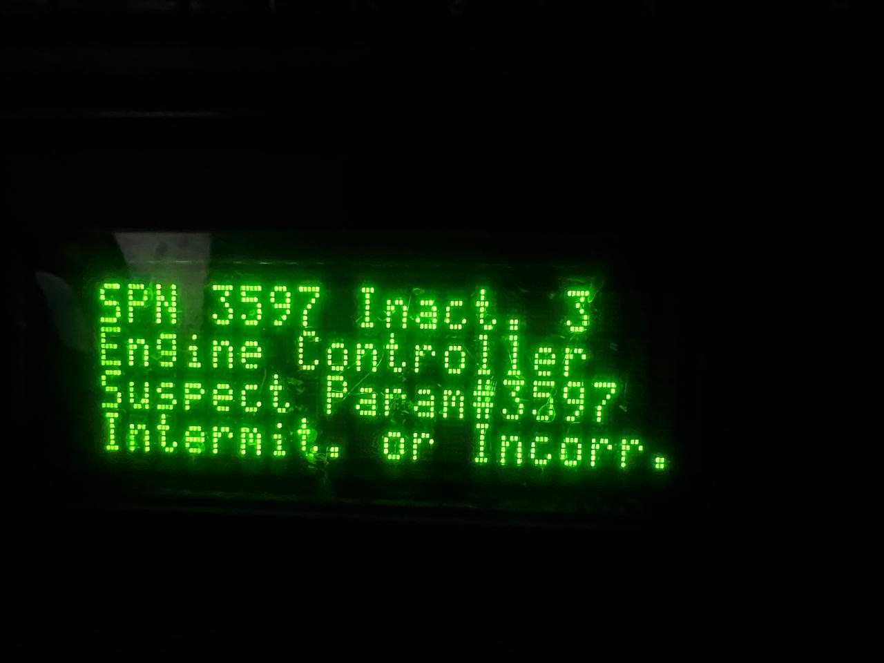

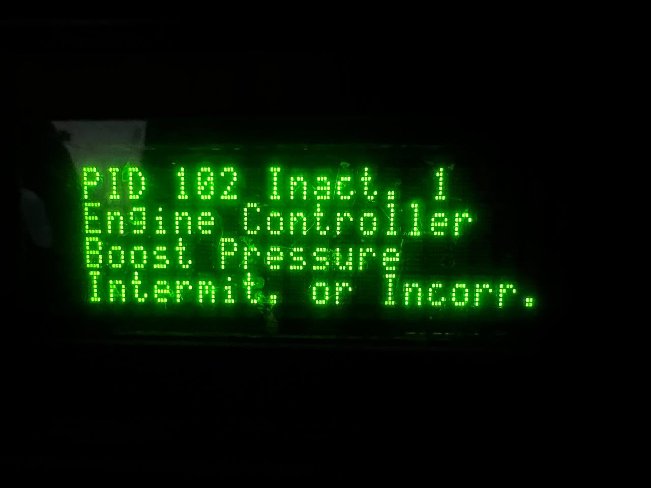

I was on Interstate 5 Southbound, going up the grapevine when my boost gauge dropped to 0 and started hearing a hissing sound. The check engine light came on, don't remember if it came on during or after I noticed the boost gauge. Pulled off to the side and looked for anything that looked out of the ordinary, everything looked fine. I would only hear hissing while in motion so I assumed the gauge was powered by air, my tanks remained at capacity and at that point the engine brakes still worked. When the hissing stopped, the engine brakes stopped working. I got the following error codes but seem to be inactive.
[attachment=8377]
[attachment=8378]
What could have caused this? Is this a safety measure from overboost?

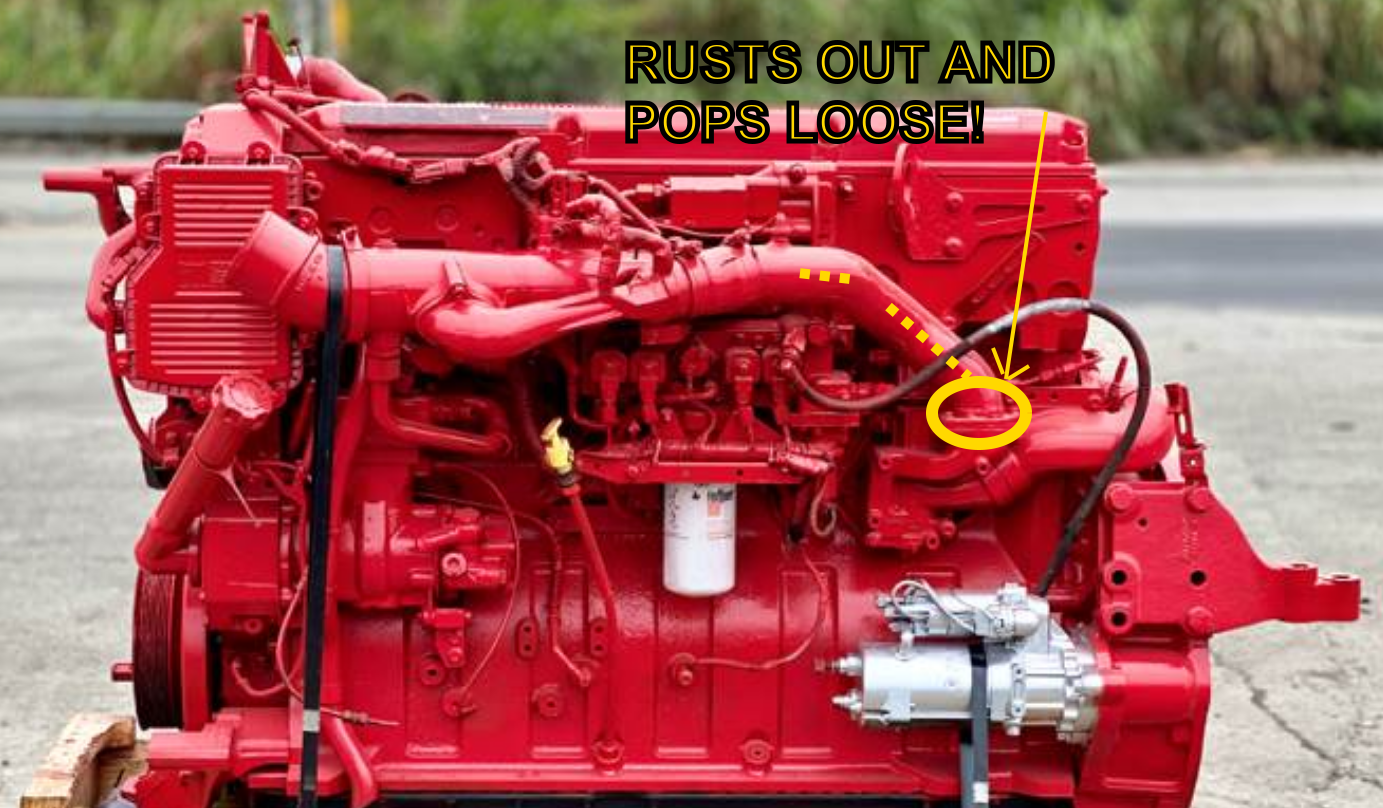

It being a CM871, give the EGR pipe on the intake side a good yank. The pipe that connects the top of the EGR valve going up towards the intake. - Those things are notorious for rotting out over the years where they meet the top of the egr valve, then popping loose like that in a hard pull.
[attachment=8380]
Well, I guess I'm blind. I checked the clamps and they all seemed fine. The boot popped off just past the first clamp after the CAC and I missed it. Thanks
