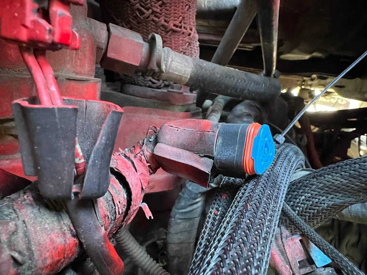

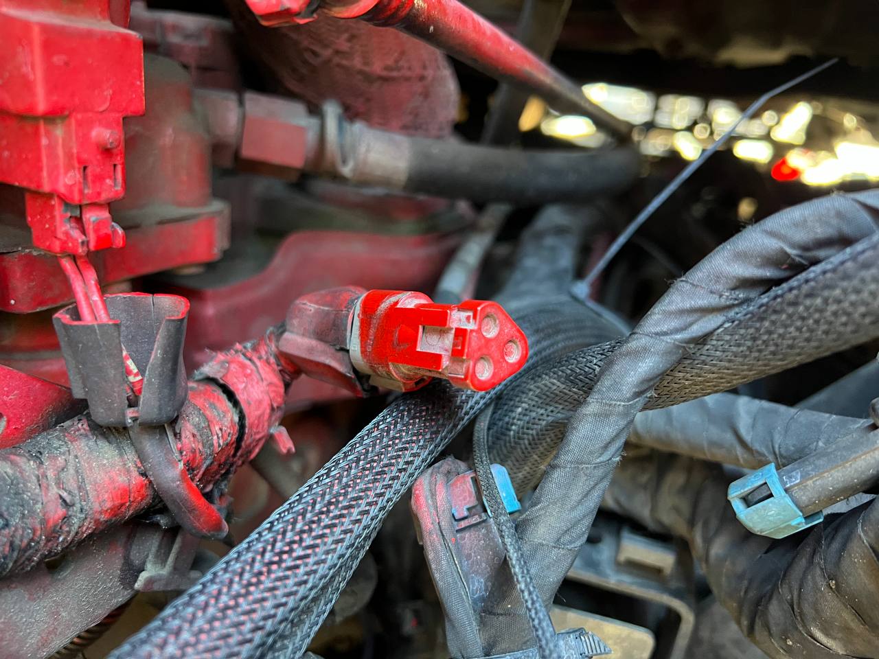

(08-10-2022 )RMezaJr Wrote: [ -> ]...
You're referring to this connector correct?
Nope.. The Weather Pack connector on the CM871 is this one. It should only be checked after the engine/truck has been shut off after 2+ minutes or more and all communications has stopped...

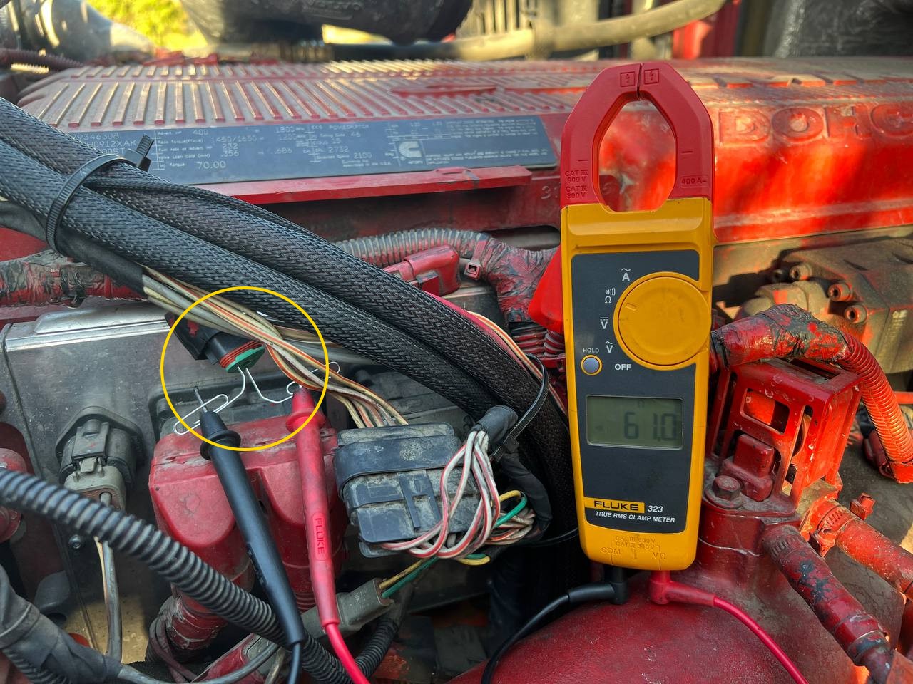

Found the connector, it was hiding. My test leads were too thick and didn't want to damage the connector so I used paperclips.
[attachment=9013]
(08-12-2022 )RMezaJr Wrote: [ -> ]...
Next this to do is a proper turbo inspection. Also look closely at the wiring to ensure there is not a broken or rubbed thru wire in the harness somewhere.

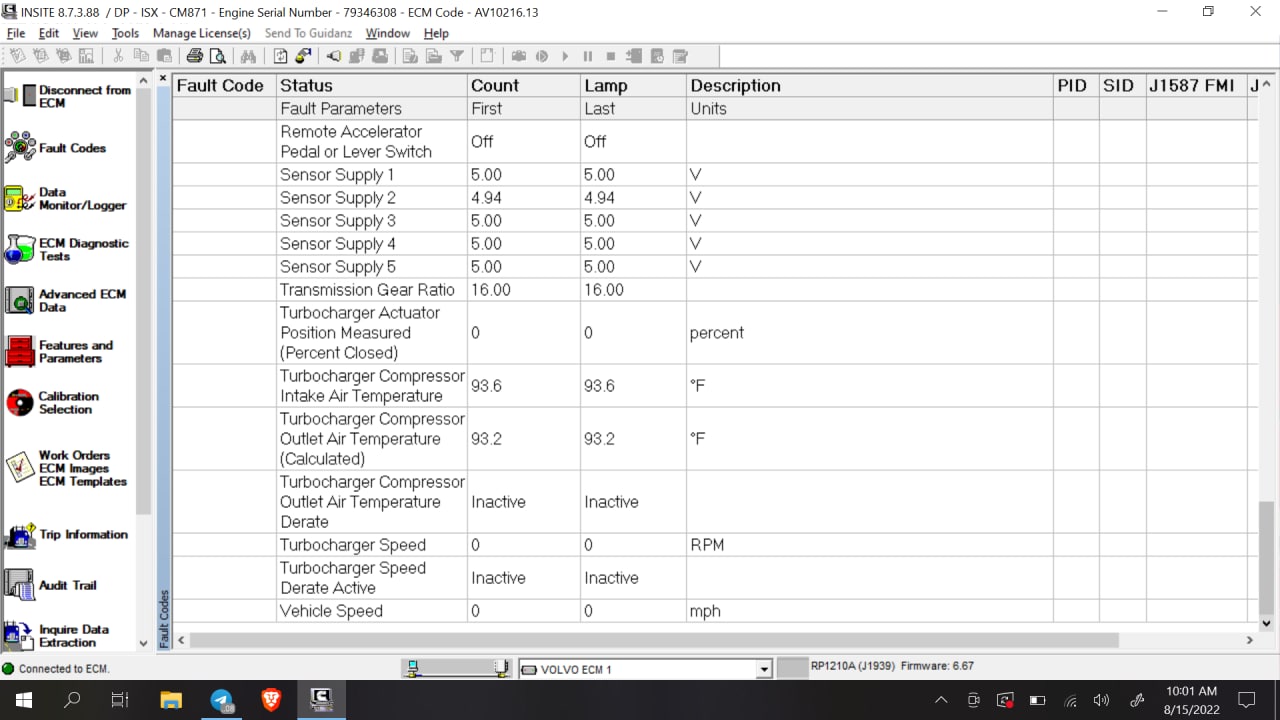

It wasn't the turbo's speed sensor. Curious if the slight voltage drop could give a hint as to where the short could be. I was looking at the data connected to the fault code and saw that Sensor Supply 2 isn't 5 volts.
[attachment=8511]
The actuator was malfunctioning, I replaced it and there is no more issues. Thanks!
