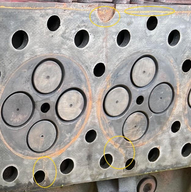

(06-11-2023 )Dieselboy Wrote: [ -> ]...
Based on the pictures of the head do you believe it needs to be replaced or is it still usable? Also, the pics of the cylinders and top of the pistons? Does it need new liners and pistons? The reason I ask is I would love to take your professional opinion to the folks at Cummins and perhaps argue as to why it needs all that, if you don't think it does?
Taking a very close, second look, zoomed in ...
In the pics you provided.. THERE IS EVIDENCE THAT SOMETHING DID GO THRU CYLINDER #1 at some point, but it does not look so much like metal, rather than carbon chunks or just heavy pitting due to coolant intrusion, who knows. I have seen coolant intrusion do that to the bottom of the head before.
The valve(s) themselves are not beat up, usually indicating no actual metal chunks were in there. --> . It is somewhat hard to see in the photos ... but You can see that something got into the cylinder and damaged the bottom of the head at some point if you zoom way in and look closely.
Something DID damage that cylinder.
It also looks like the liners have been dusted at some point .. like some idiot ran the engine for a while with no, or an improperly installed, air filter on it.
After taking a harder look.. these things become quite obvious, and it points right to some kind of engine abuse by someone some time in its past.
(just a heads up for people reading this thread)...
A PERSON ABSOLUTELY CANNOT RUN A COMMERCIAL DIESEL ENGINE WITHOUT AN ADEQUATE AIR FILTER ON IT!! ... NOT EVEN FOR A SINGLE DAY NONETHELESS FOR ANY EXTENDED PERIOD OF TIME!!!. Even simple dust will wash out cylinder cross-hatching real fast on one... and several cylinder liners, especially towards the back, look just like someone did exactly this at some point.
(I edited my post(s) above to reflect these new findings, so that others reading the thread in the future do not get mis-directed).
Garbage-can OEM stelaers$it aside ...
As far as the damage to cylinder #1.. who knows what went thru it.. could have been carbon chunks from the EGR cooler.. like mentioned above.. or it even could have been from some complete moron running the engine with a damaged or missing Air filter on it. Maybe a missing intake boot between the turbo and the air cleaner?... who knows.
That would be my thoughts after taking a really close, second look.
Yessir. What Rawze said. Just make sure they set your liner height correctly. Most people don’t even check height after liners are dropped in, make sure the head bolt holes are cleaned properly and the head is torqued to spec, engine sits over night and the head bolts re checked at 375ftlbs the next morning, and chances are with 55k miles the rods aren’t hurt but the bushings in the ends of the rods need to be checked thoroughly if not replaced. It’s always recommended to replace the rods or at least the bushings but at 55k miles I can understand not changing them if they look new. (Just my opinion others may disagree)
Afterwords I would have the ecm code checked and make sure the file in your ecm indeed does match the esn of your engine. Make them do a good….extremely good egr cleaning, every pipe, component, and port.
It’s obvious that something was neglected at some point in this engines life. Might as well make its second run worth it. Don’t be afraid to ask questions and demand perfect work from them. If they have an issue with answering questions or f*** you around instead of answering them, won’t show you the why’s and how’s and you are spending 15-20k with them then they don’t need to be working on your shi#t.
The more I stare at the pics, especially at cylinder #1, it looks just like it blew the head gasket at one point... and then someone likely stuffed some kind of radiator stop-leak or something else in the engine?. What is that crap in the pic at area 'A.'?. -= is this signs of a blown head gasket???.. or the reflection of light for whatever gunk is on the head?. -= hard to tell.
[attachment=8967]
Also... THIS HEAD must have sat outside in the rain or something?? -- The photos show that it was NOT freshly pulled off the top of the engine!. -= You can see signs of rust on it as if it sat outside or something, and then rusted up before the photos were taken...
[attachment=8966]
The rust where each of the liners mated to the bottom of the head happened AFTER the head was removed.. not before. There is also rust buildup indicating that the head was laying on its side too, while wet with water.
-== OR -=-- Was some godd#$amn complete idiot use mostly/straight water in the radiator system??... and not actual ELC red???..
Also, WHY is there signs of 'green' coolant in the one photo??. -= THAT IS THE WRONG type of coolant to run in a commercial wet-liner engine.. ESPECIALLY IF IT SAT A LOT!!!!>>>
-== Something is quite suspicious about this set of pictures of the head if you ask me ... or is it the beers talkin'?.
Edited
