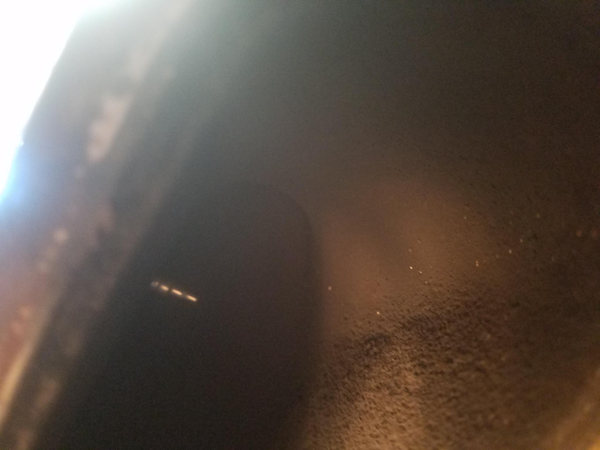

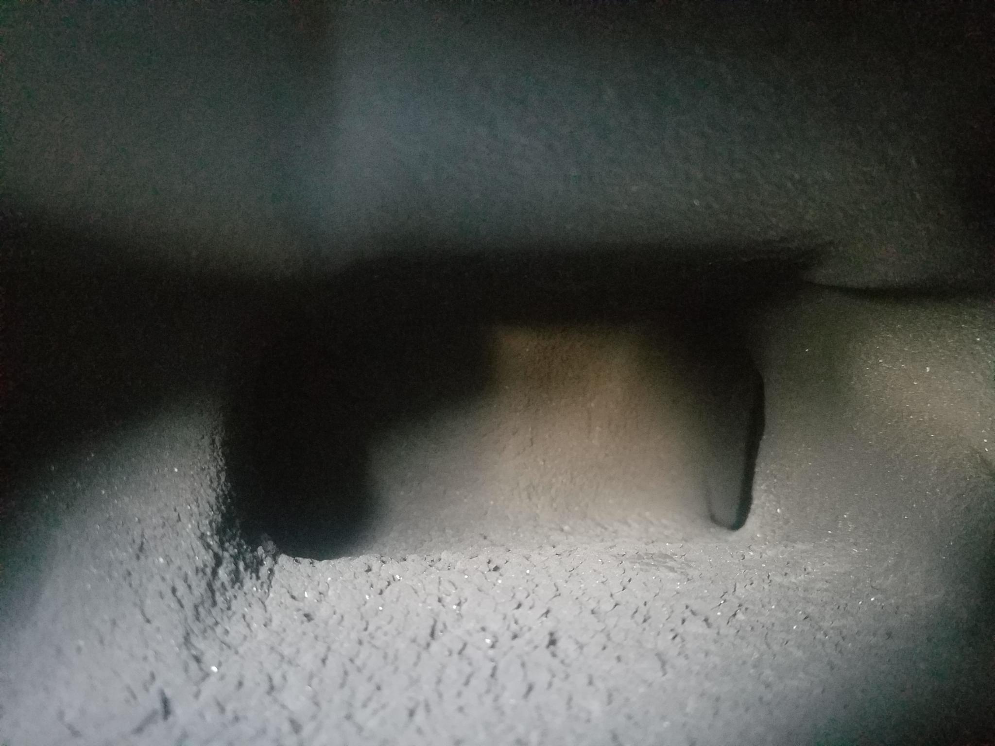

Took the intake off and I think all these little white specks are aluminum because it doesn't sparkle in the light, I'm thinking that's from the compressor wheel.it goes through the manifold as pictured and into the motor also pictured.I could see some very very small sparkles in there and I'm thinking those are probably steel pieces?? They are so small though that I hope it's not gonna be a problem. I didn't see any big chicks.
Also took the valve cover off and everything looks intact, I wiggled all the valves and they are tight. I'm about to drop the pan and I'll let you know what I find. Am I on the right track here?

Yup, you're doing fine. When you took the intake off you may want to have a vacuum cleaner handy. All that dirt and black soot that's built up in there you'll want to suck out if it becomes dislodged or loose. Be very very careful not to disturb a whole lot in there. Any pieces left behind that are loose will go straight to the valve into the cylinder andback out the exhaust may cause all kinds of problems.
RE: CM 870 turbo - Chamberpains - 01-26-2018
Also if you think you have steel particles throughout things, you could always get a strong magnet and wave it around in there to pick them up. But then again be very very careful not to dislodge all that carbon and junk
