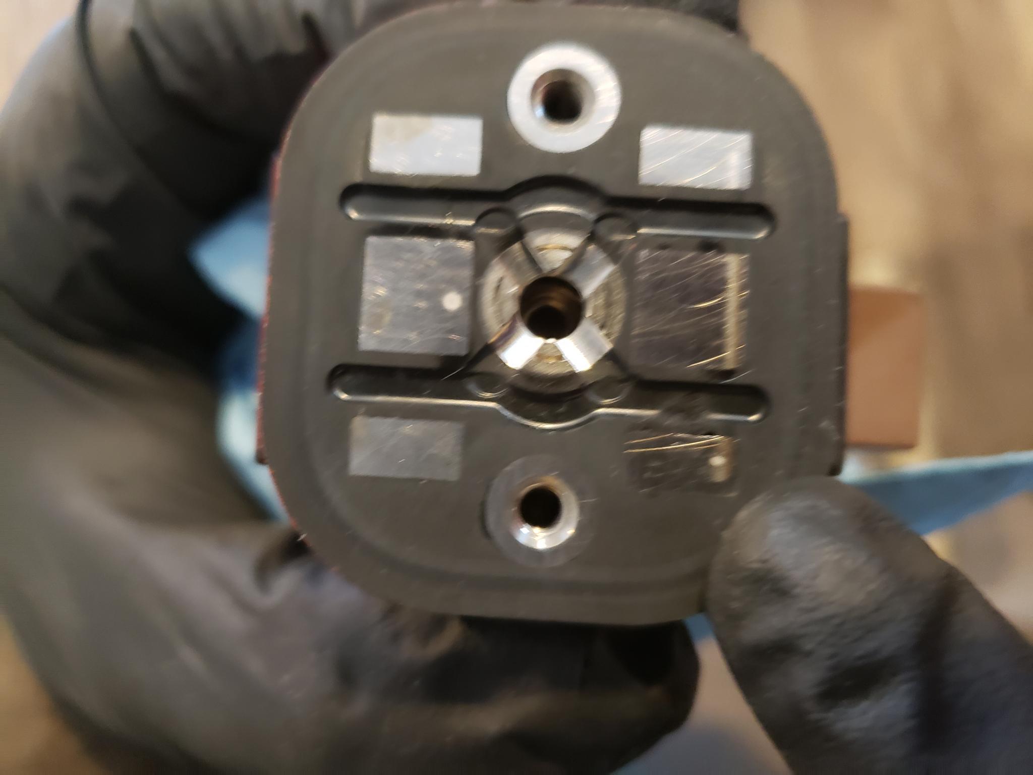

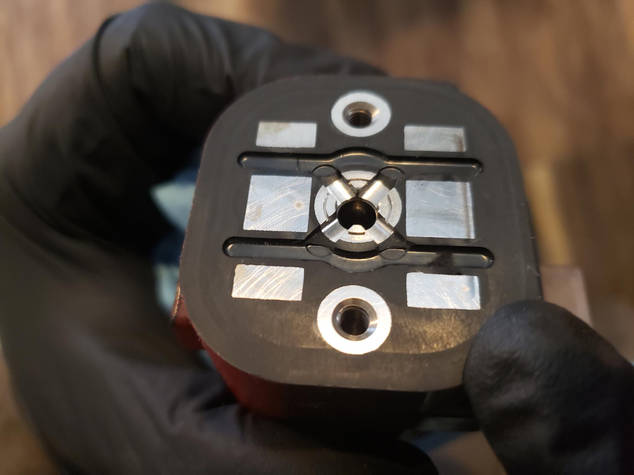

You also mentioned that your problems started after you "cleaned" intake sensor's. Are they reading correctly? Did you damage them with a brush or cleaner? You need to monitor them to see what the ECM is receiving not thru dash gauges.

how do you clean them? I lightly used a small wire brush and electrical cleaner. So yeah that's probably one of my main issues.

I also noticed some wear on my rear metering actuator while cleaning it. I don't have a precision tool to measure the movement but it is considerably more than the lead actuator.

(02-16-2019 )Mluper7 Wrote:  how do you clean them? I lightly used a small wire brush and electrical cleaner. So yeah that's probably one of my main issues.
you don't -- you replace them. Solvents on old sensors make the read incorrectly after they are cleaned.

RE: CM870 vibration and black smoke - Mluper7 - 02-25-2019
Well so after everything I went through it was just my boost sensor.
