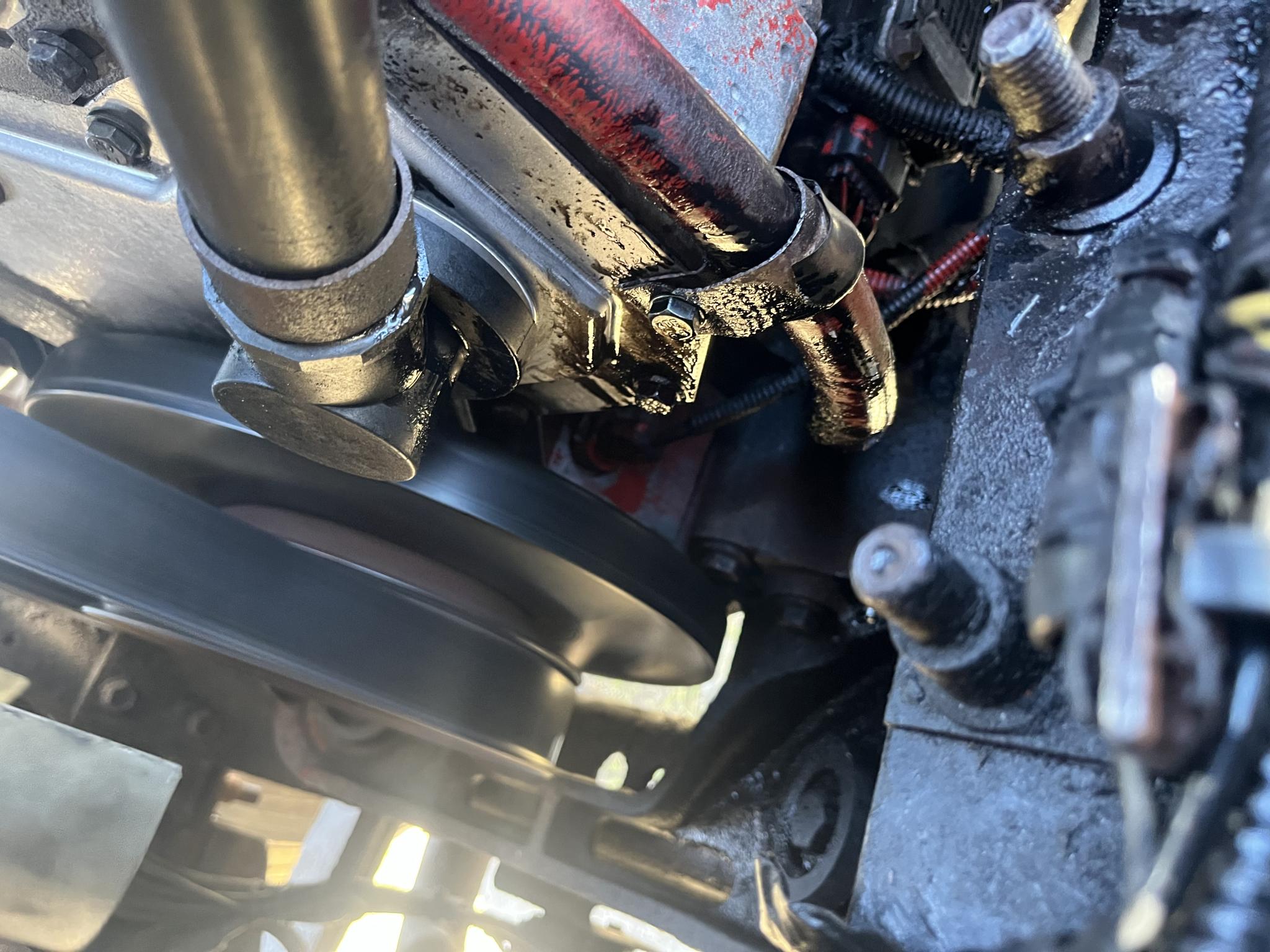

Update: oil was washed and truck was driven 7 miles back and forth. This is the image of how it looked after the drive. The oil leak started from the oil filler section.
RE: Isx leak - tree98 - 12-20-2024
Yep, dripping on the balancer and slinging it everywhere.
RE: Isx leak - SquareOne - 12-20-2024
(12-20-2024 )3406E Wrote:  Update: oil was washed and truck was driven 7 miles back and forth. This is the image of how it looked after the drive. The oil leak started from the oil filler section.
Yep, I'd say ya found a pretty severe leak. With that much oil in so few miles, that would be one helluva mess on a regular trip.

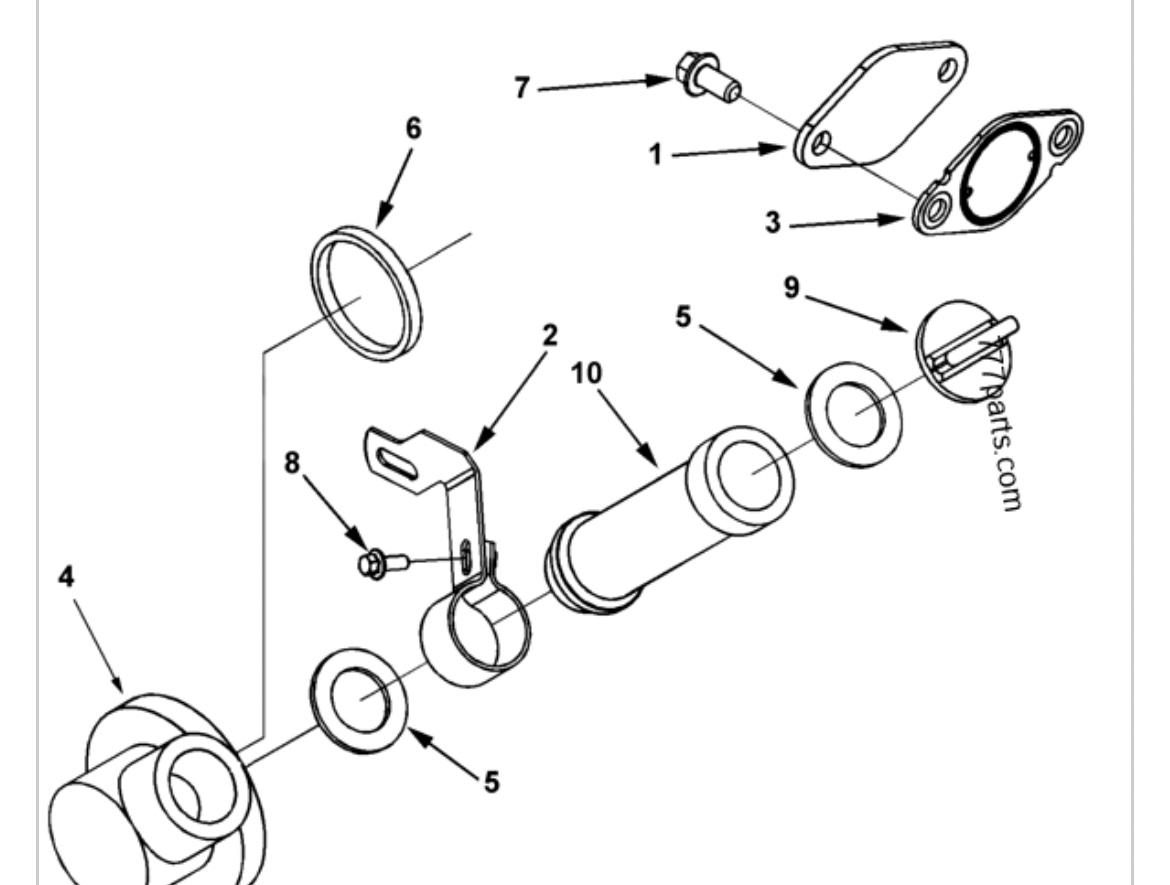

Looks like you can replace the elbow or the whole filler neck and have it knocked out.
RE: Isx leak - 3406E - 12-20-2024
Bought the whole assembly
