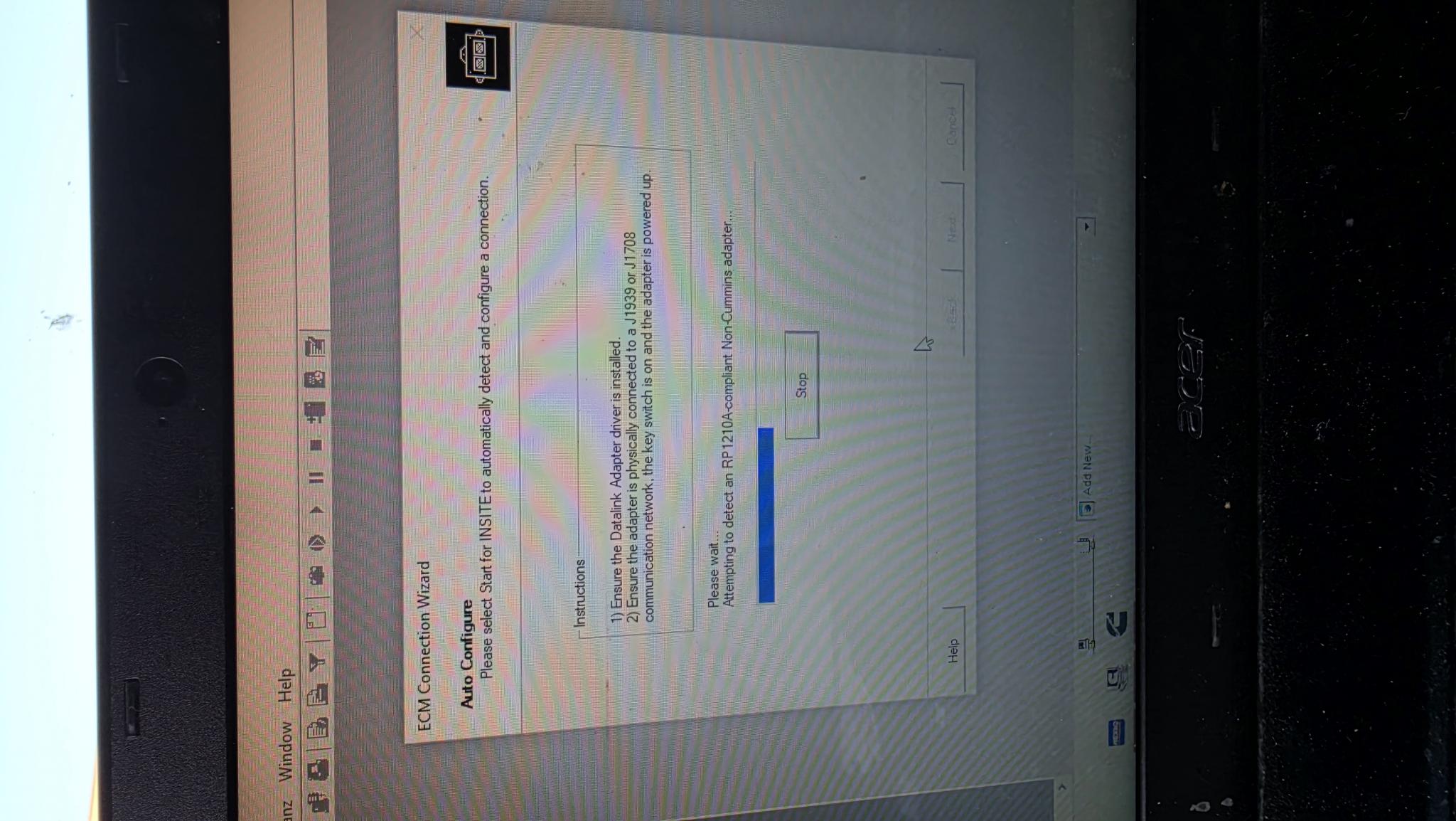

hi yall,
i have a cheap chinese nexiq link 2 bluetooth adapter that im trying to connecting to cummins insite.

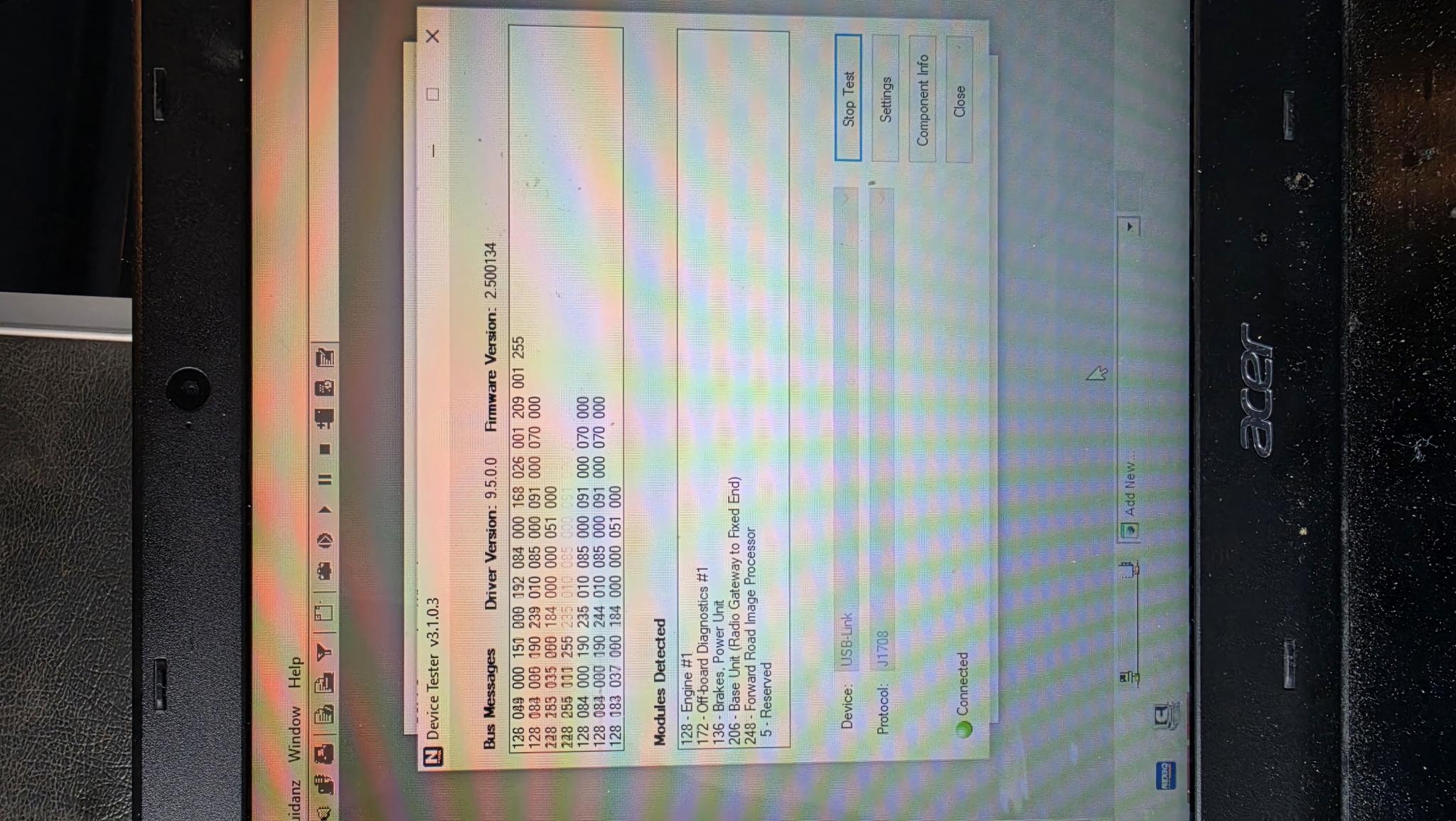

the adapter is connecting to the nexiq device tester app and runs well showing connected status
but does not connect to insite
insite says error code 5202, which means your computer cannot talk to your data link adapter
so insite not connecting but does connect to the nexiq device tester app
the power light and and data transfer light is on when running the nexiq device tester .

The 1st generation nexiq was pretty awful to begin with... the Chinese versions are even more awful, and rarely work or hold a steady/reliable connection in order for insite to communicate properly. worth a shot checking all your protocols, J1708 looks like it works in your photo, make sure J1939 Chan-1 does as well in device tester, and make sure insite is configured to communicate with "USB-Link", not USB-Link 2 or 3, and make sure its set to "auto-detect" instead of J1708/J1939...
