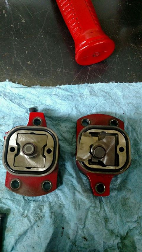

Broken fuel actuator....picture - preacherboy24 - 12-16-2016 Here is a fuel actuator that was working while it was on the engine. It was putting metal in the fuel and taking out injectors. They decided on replacing the actuators......so they took them apart to see what was going on. This is what they saw. |
