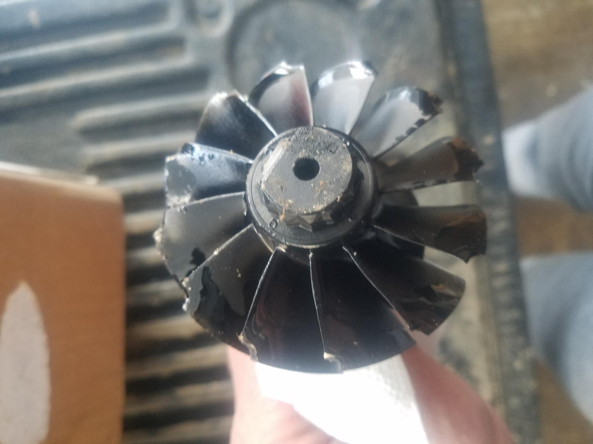

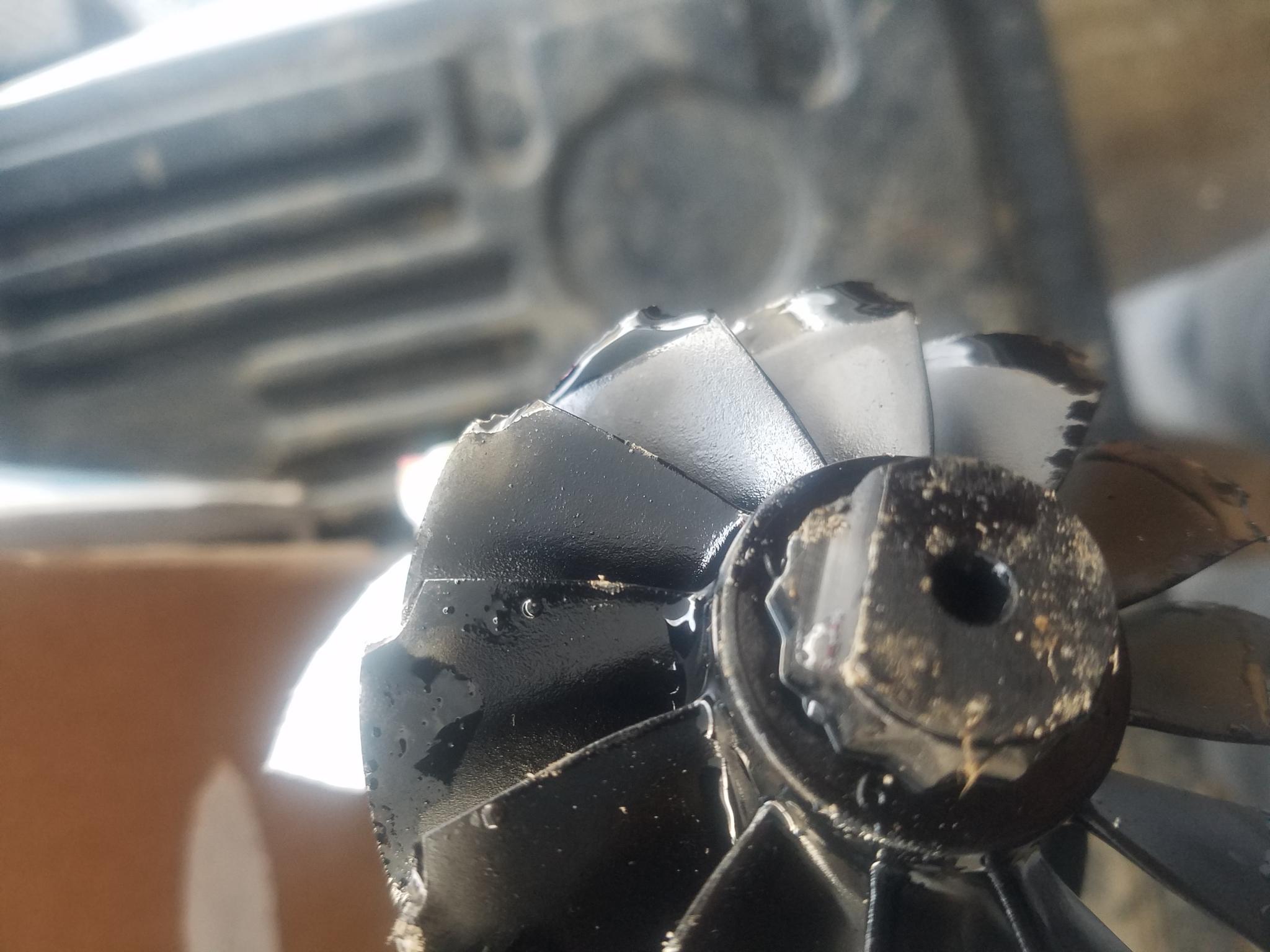

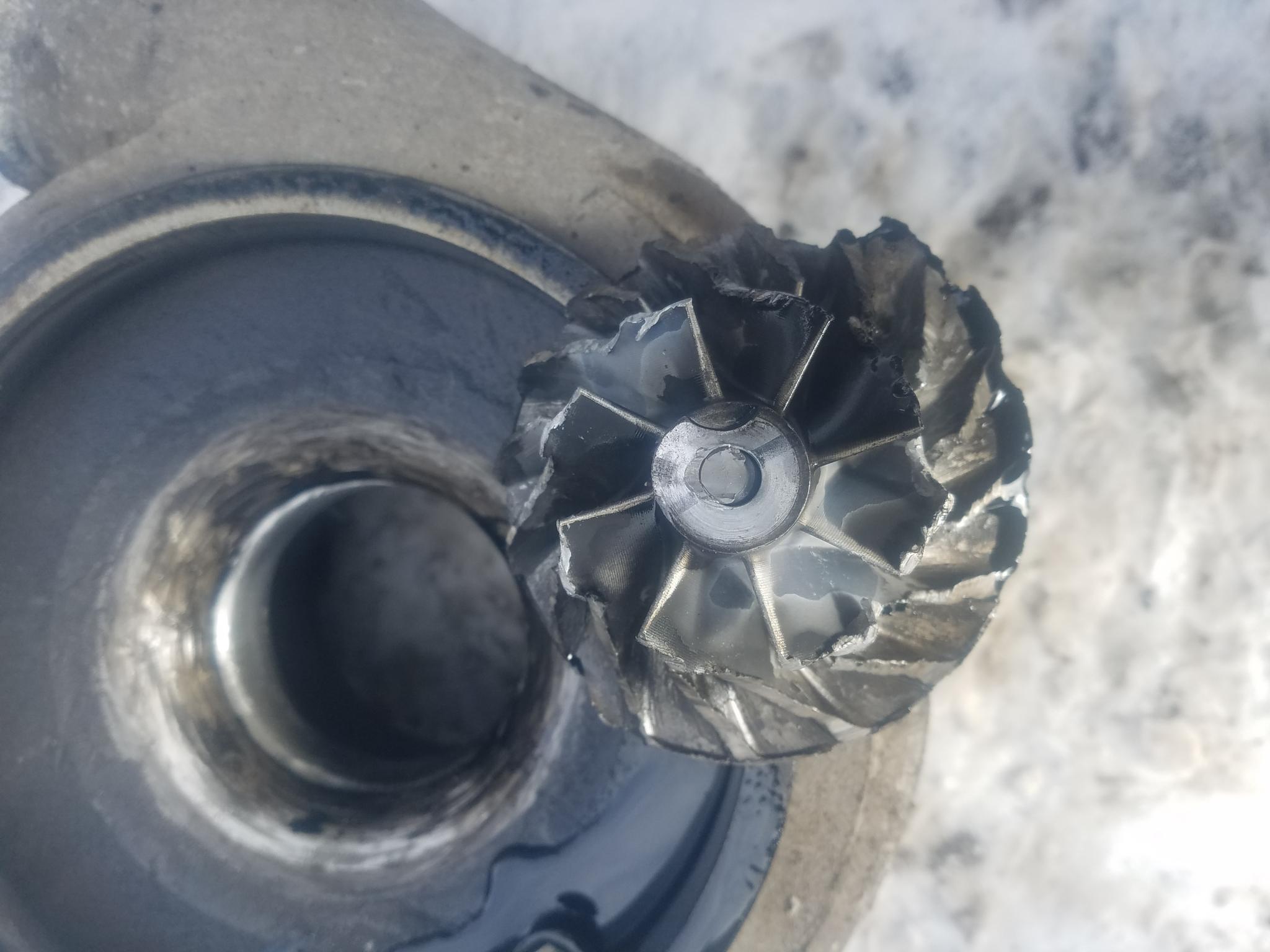

Took it apart today, like I thought the turbo failed. I'm just wondering what made it fail? Was it a bearing inside that let loose or was it something inside the motor that failed and went through the turbo? I'm about to put a new turbo, intercooler, oil/ coolant lines etc. etc. a ton of money in parts and I don't want the same thing to happen again if something let loose inside the motor. I attached some pics so maybe you guys can get an idea of what happened?? I need to get this truck back on the road tomorrow if possible, i can post more pictures of the parts if you want to see something specific.
[attachment=3474][attachment=3475][attachment=3476]
RE: CM 870 turbo - Blake - 01-25-2018
From the last photo, looks like the fins got chewed up.
RE: CM 870 turbo - tree98 - 01-25-2018
the top 2 pics are the turbine (exhaust side) the bottom pic is the compressor side (intake side)

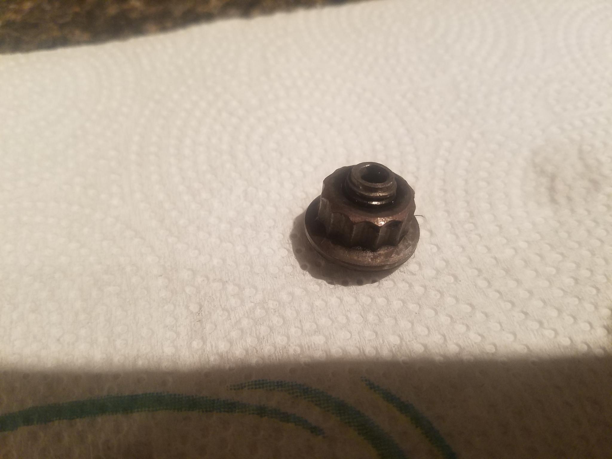

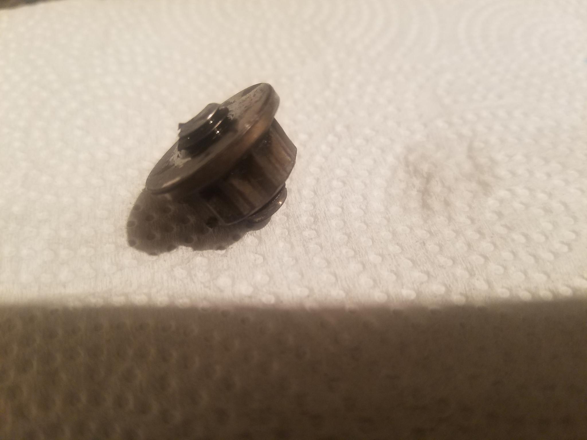

I found this broken stud with a strange looking nut on it inside the turbo. Was that part of the turbo or did it come out of the motor?
[attachment=3477][attachment=3478]
RE: CM 870 turbo - Wiseman - 01-25-2018
[/quote]
This is the compressor wheel retaining nut with snapped portion off the turbine shaft still in it . Have you lugged when this ting happened? Be honest.
