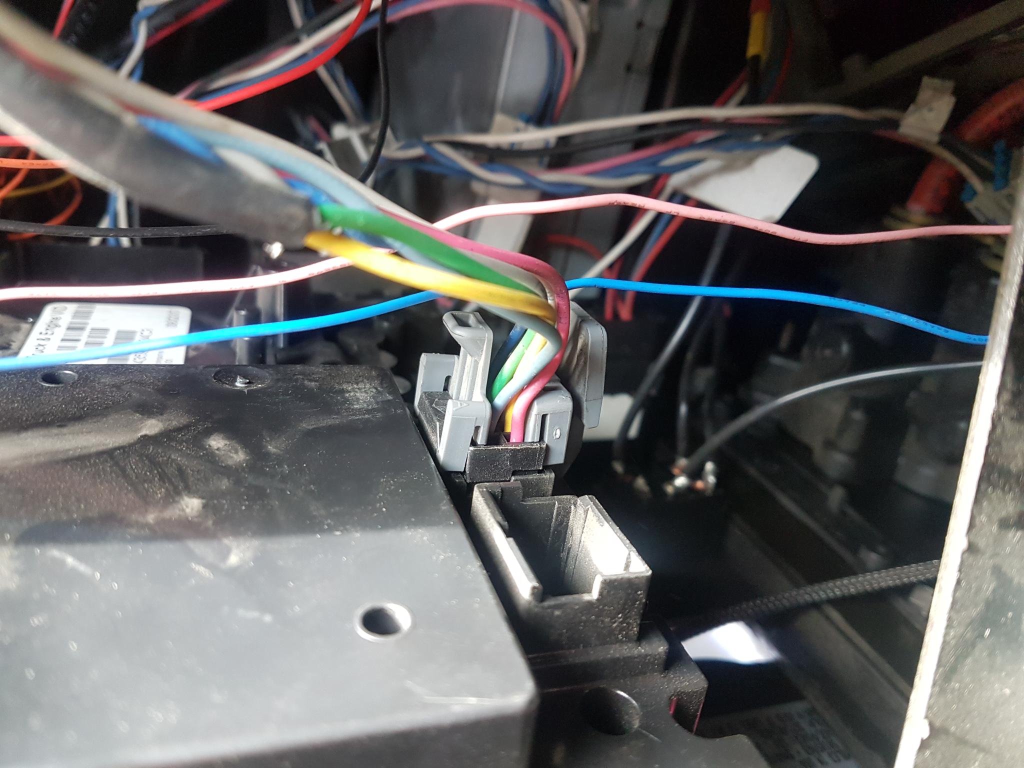

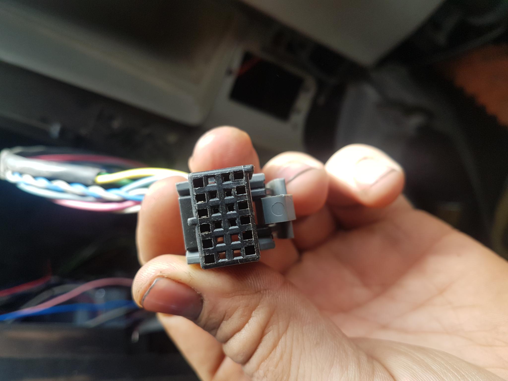

Please do. I notice your interior that you have that montior, computer dash unit. If you still have your truck apart could take a pic of the plugs in the back? I have had my dash apart and notice i have srrval plugs that do not plug into anything, i was hopeful that it might be for that in dash unit.
RE: Finally bringing Prostar home to fix.... - Brock - 05-10-2018
(05-10-2018 )74bassman Wrote:  Please do. I notice your interior that you have that montior, computer dash unit. If you still have your truck apart could take a pic of the plugs in the back? I have had my dash apart and notice i have srrval plugs that do not plug into anything, i was hopeful that it might be for that in dash unit.
[attachment=3918]
[attachment=3919]

Thanks Brock, what all can you do with that unit?
