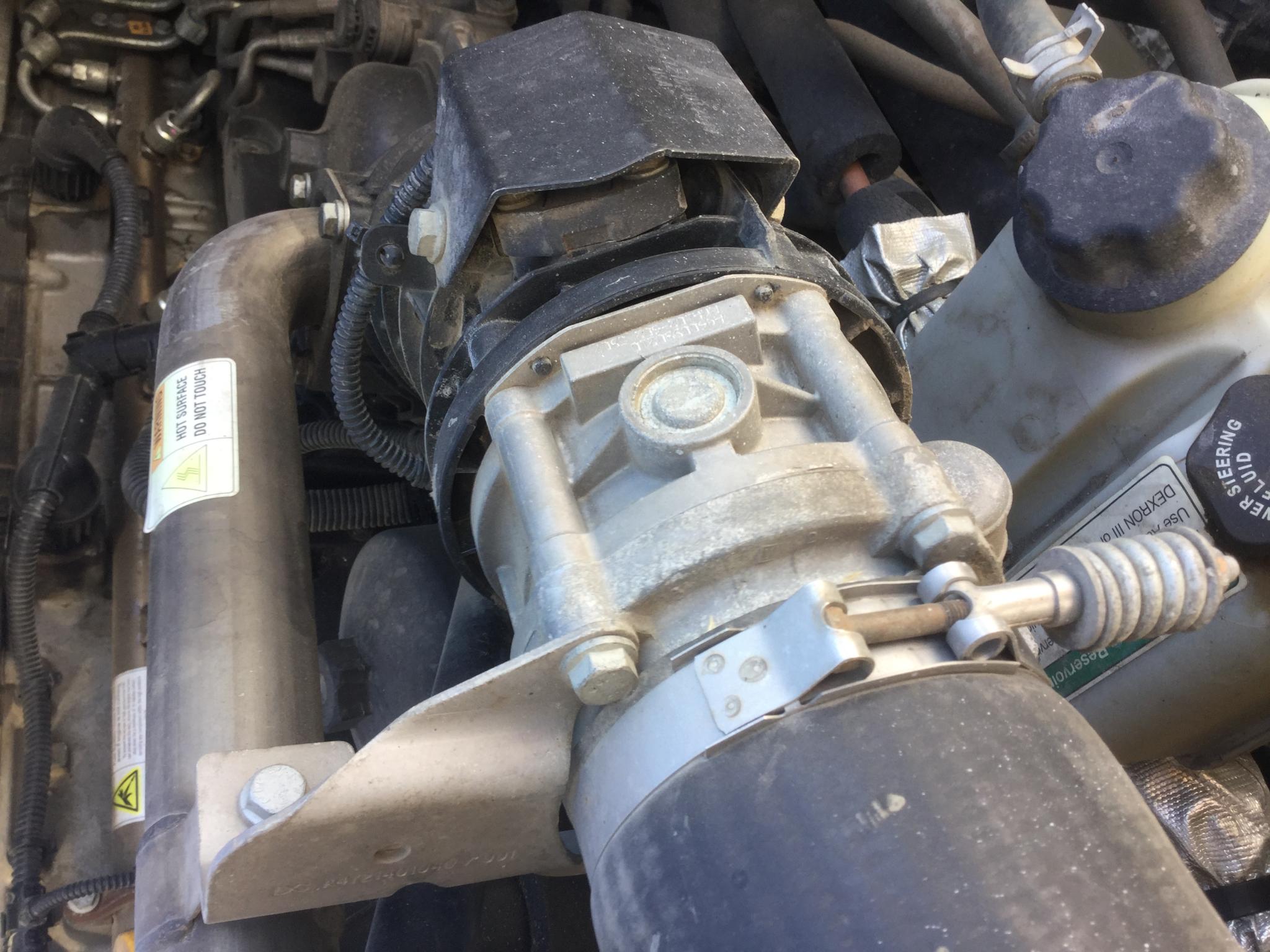

The factory boost and charge air cooler temperature sensor is located on the drivers side.
Located under the black metal cover in my picture, with the plastic wire loom coming out of the back and top of it.

Rotate photo 90 degrees clockwise.

Is there a way to connect this directly to the gauge or do i need to take it out and insert the sensor for the gauge here? Also, I haven't bought a gage yet do you think i would be better off buying a pyro or something or should I ask the dealer for one.

The engine ecm requires this to be left alone, it needs it for its own use.
The data to read from this sensor is available on the J1939 data bus.
The fastest and cheapest way to read it would be to purchase a ScanGauge D. It will show boost and many other gauges that are on the databus.
https://www.scangauge.com/products/scangauge-d/
You could also just get a boost gauge from Freightliner, they just plug into the gauges databus daisy chain. But it may require the dealer to activate the gauge.
