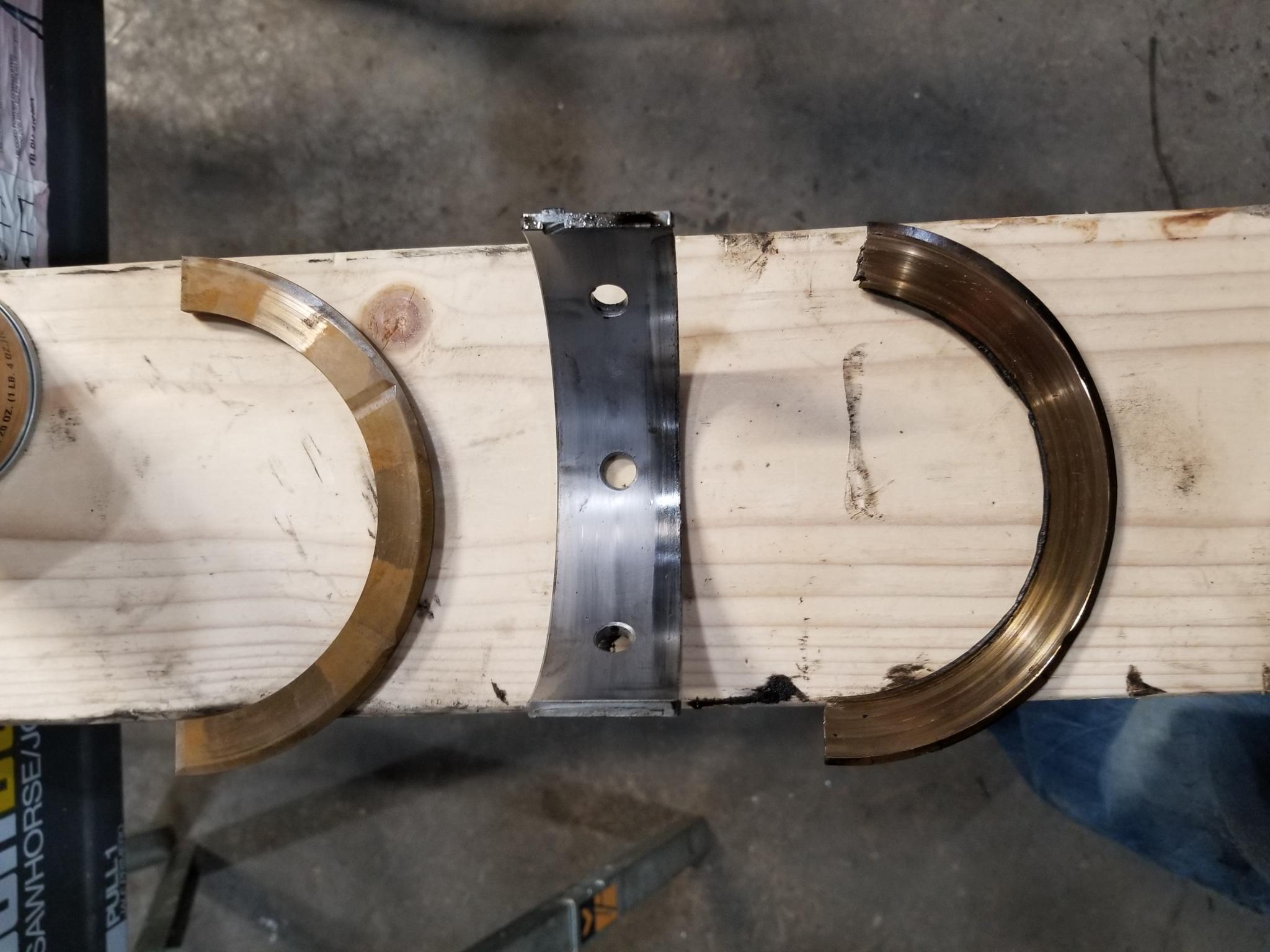

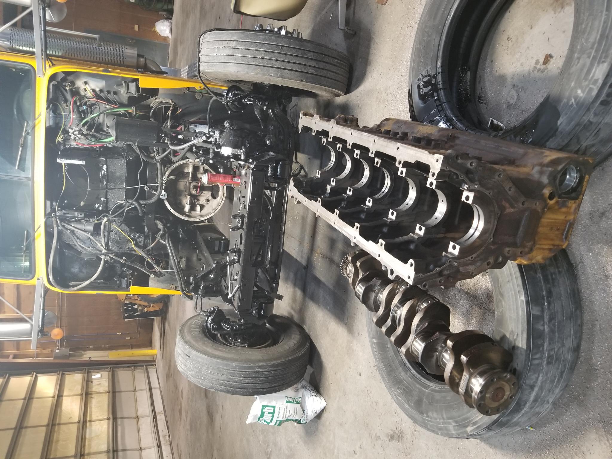

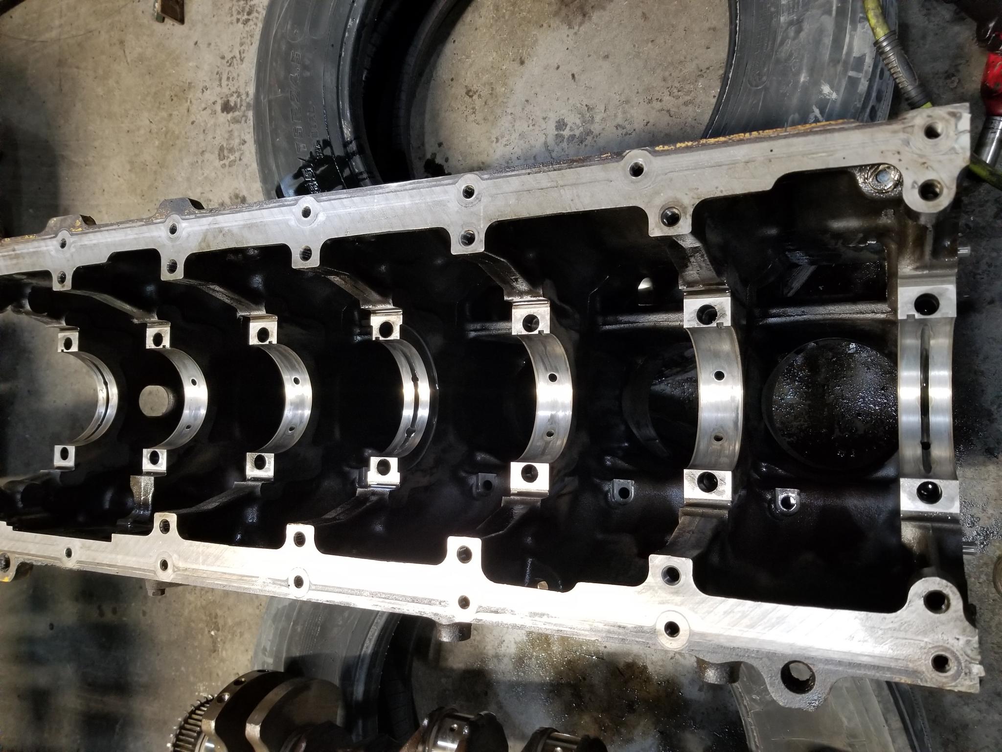

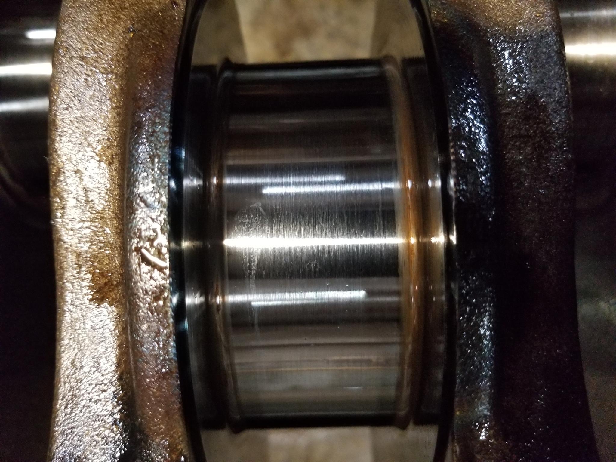

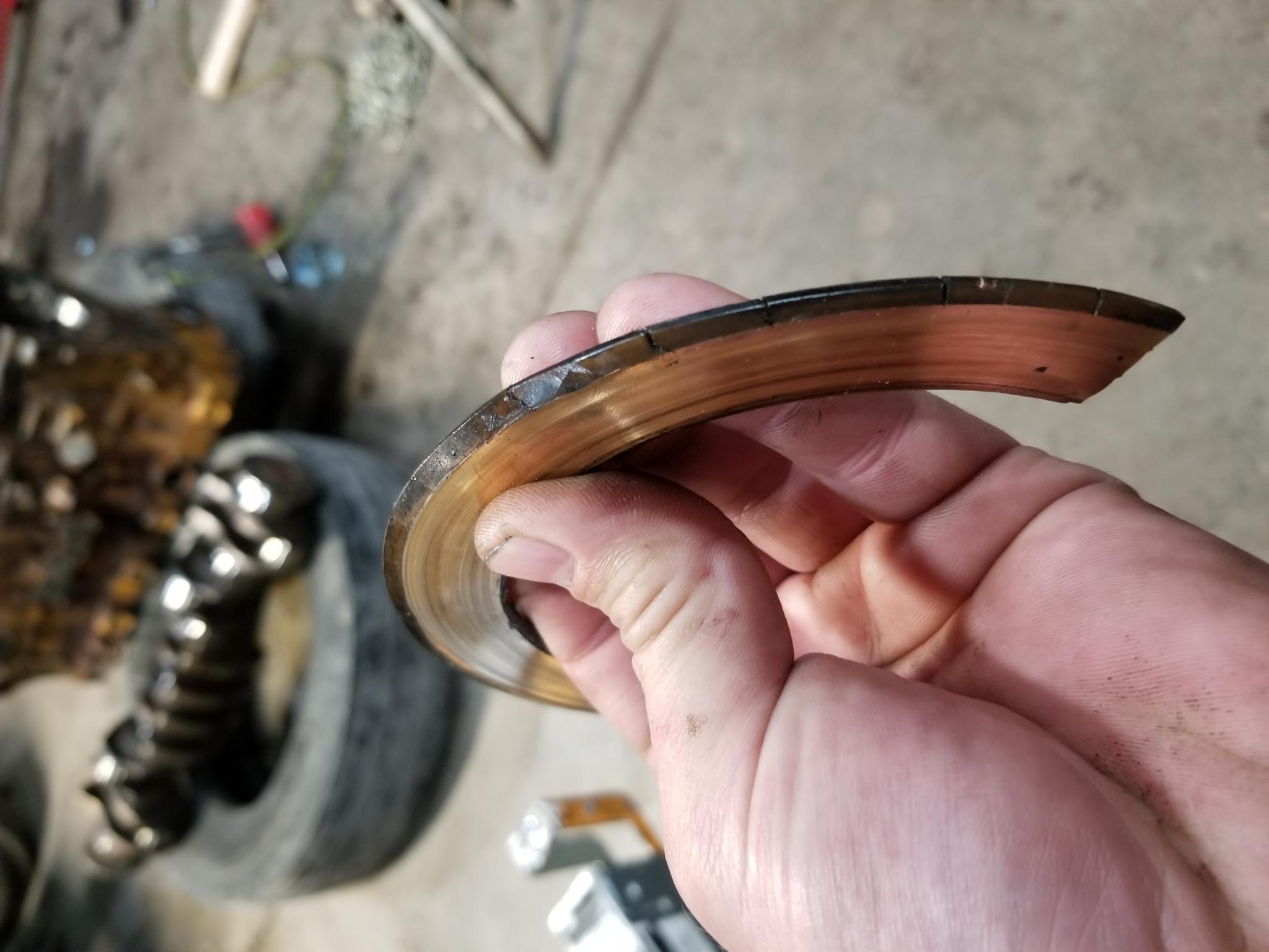

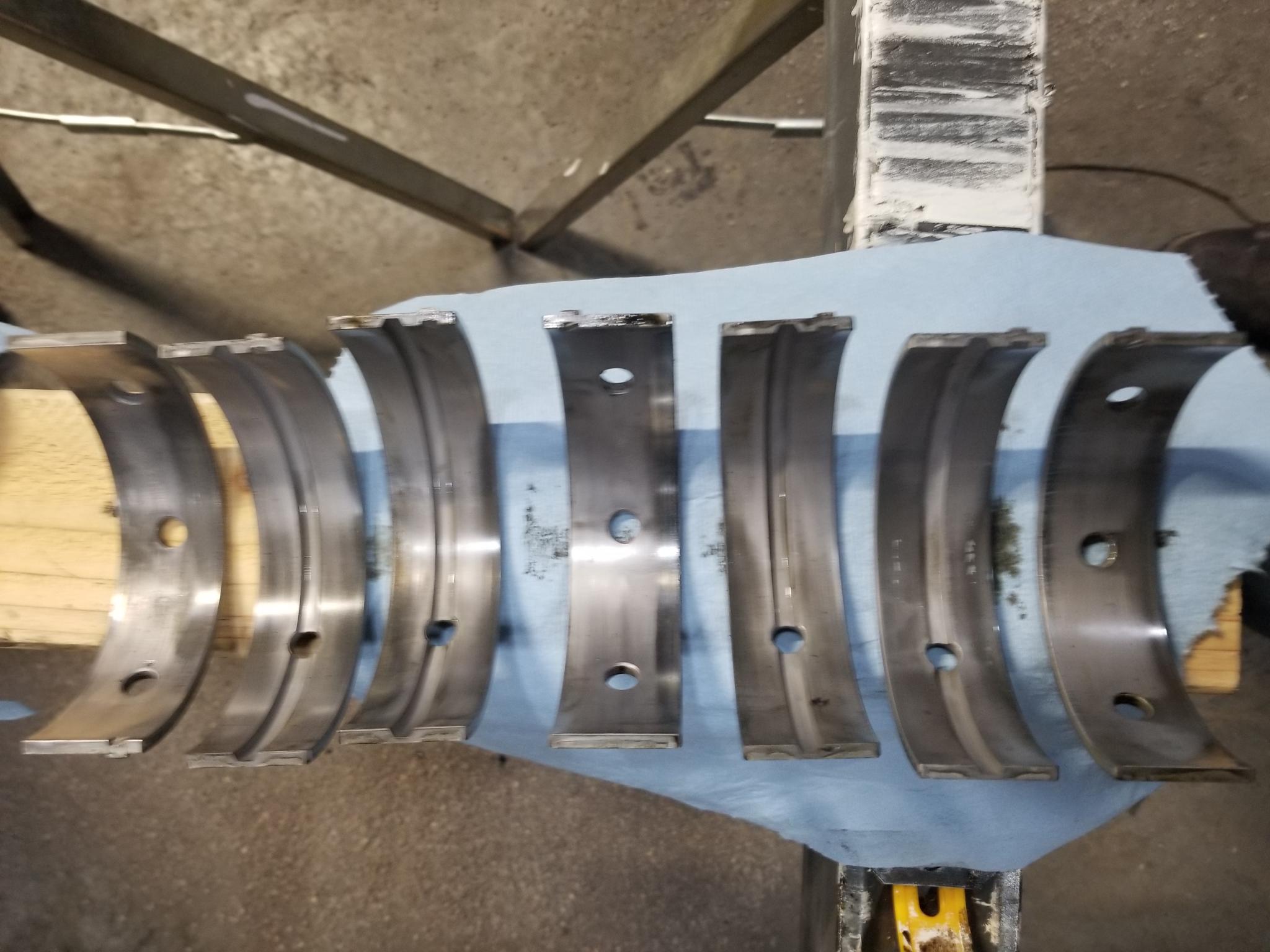

| RE: Crankcase pressure  So I figured since I was this far I would pull crank out of block. The thrust bearing was junk. The bearing is also showing wear on one side. And every main journal were there is no slot connecting the 2 holes were plugged with gunk on the cam side. The crank turned over fine, didn't feel any drag but that thrust bearing that bad makes me wonder if it's bent. Or maybe the line bore is messed up now. The end play was Def out. The gauge showed.040 | |||

| RE: Crankcase pressure  something is definately wrong. That amount of wear is not normal at all. Also make sure the crank is not being pressed inward by the transmission or clutch assy. It can cause those problems too. If the truck has an idle shut-down feature, some drivers are known to put a stick on the clutch pedal to defeat it. That can cause issues like your are showing too. A clutch improperly adjusted where there is never any play in the pedal will do it too. User's Signature: ->: What I post is just my own thoughts and Opinions! --- I AM Full Of S__T!. | |||

| RE: Crankcase pressure  I am taking to a machine shop that cat takes there stuff to in the morning. Guy at machine shop said same thing, said sounds like it has foward pressure. There going to check line bore etc etc, going to take the head in to see if it's rebuildable. It needs new cam bearings anyways. And a cam and cam followers lol it doesn't end. Everything in and on the motor will be replaced. I get the planning for a overhaul. But in my head I feel like I'm half assing it if I don't get new /rebuilt everything. I guess I can advertise it as pre eld truck and ask 100k for it. Lol jk I'm never going to sell it now. But the cat platitum kit is still almost the better deal, as it comes with injectors etc. Hopefully the block is good. Anyone know of a good place to buy a engine stand that's not 5k? I got everything cleaned up but my old tire engine stand isn't going to cut it when it goes back together. Lol | |||

| RE: Crankcase pressure  They said crank needed welded were thrust bearing rides. They weld then grind it down. I told them I would just get a different crank. Or is welded OK? They said they do a cpl a year like that.  | |||
