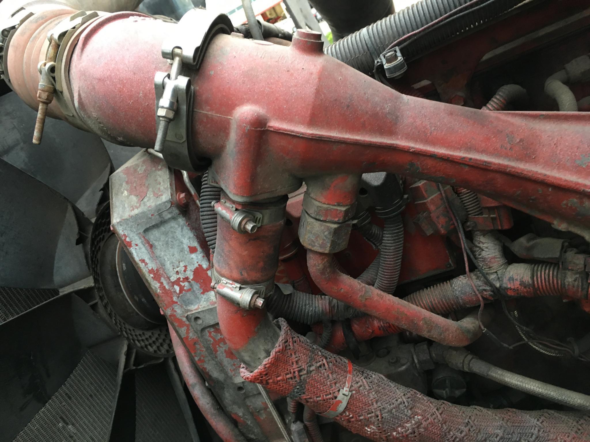

I ordered an IMAP, the rear exhaust pressure sensor, and the differential pressure sensor today. I asked about the second sensor on the intake and he wasn't sure about it. The two in the first picture, the one on the right is my IMAP? I'll find out when I pick it up but I'd like to order the other one.

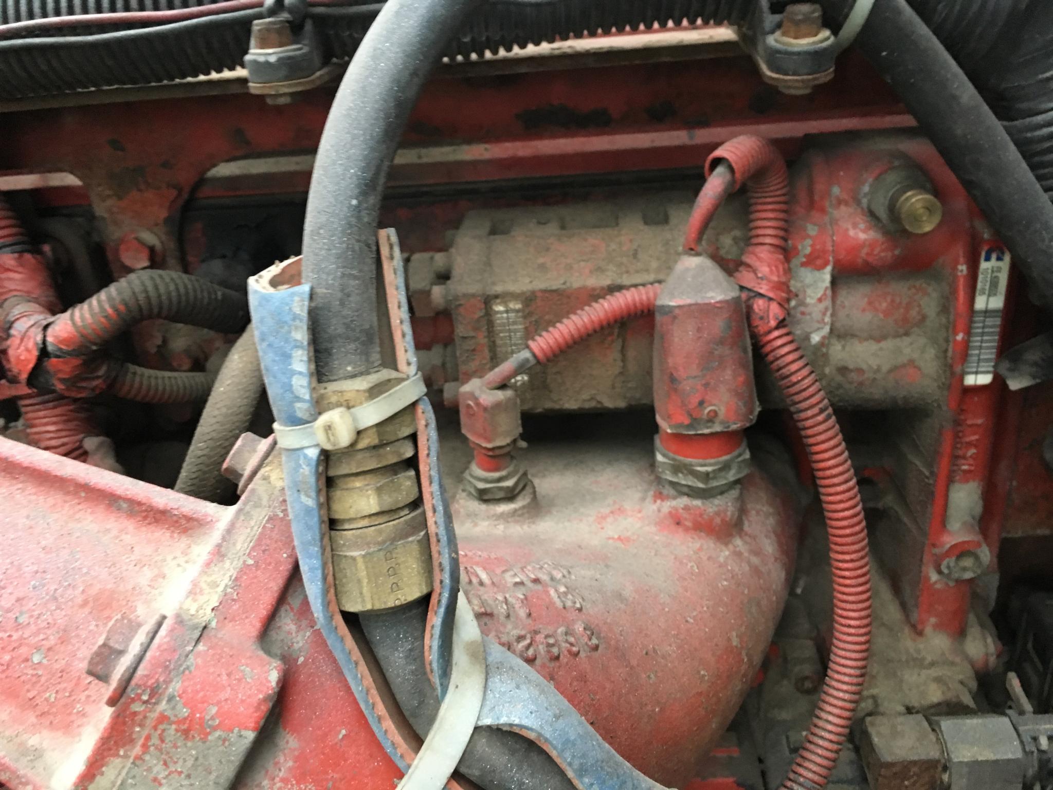

On the second photo, what's the larger pipe going straight down? I believe the other one is to the AC compressor.

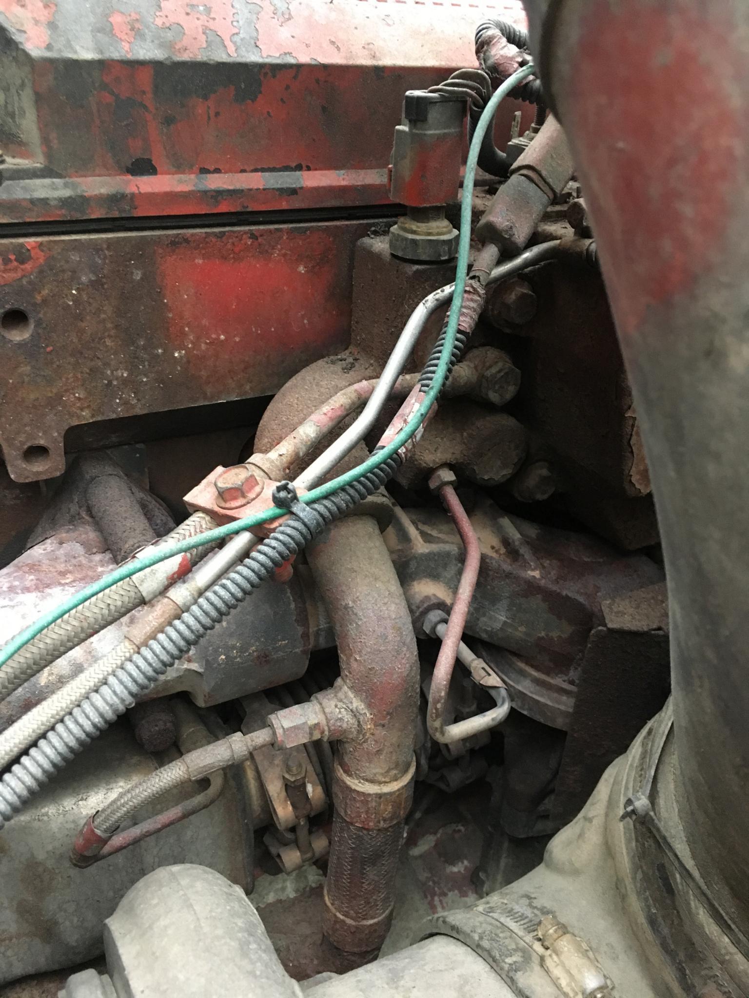

Third pic, their are two lines going over to the exhaust pressure sensor. Take both off to clean or just the one steel one?
