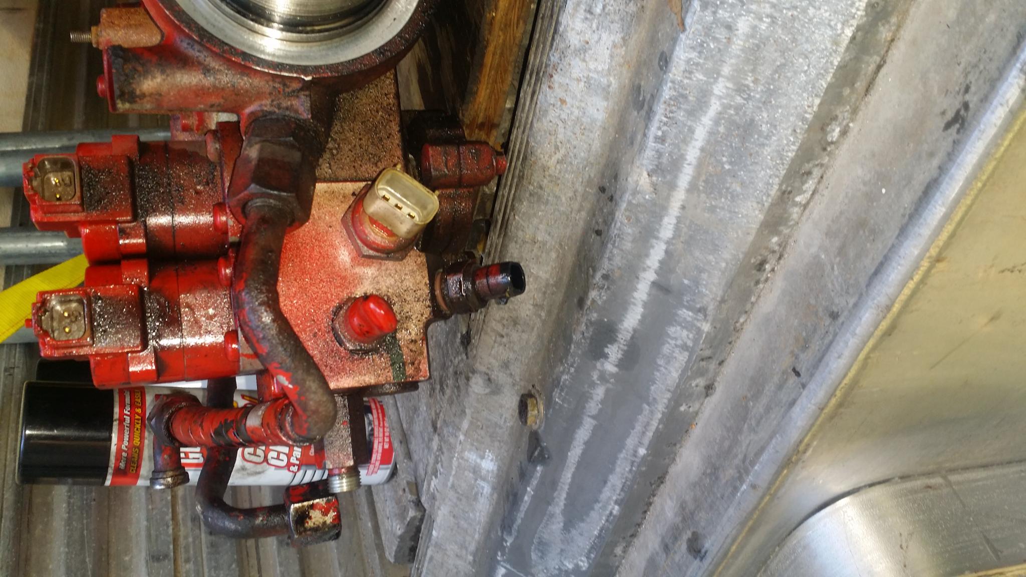

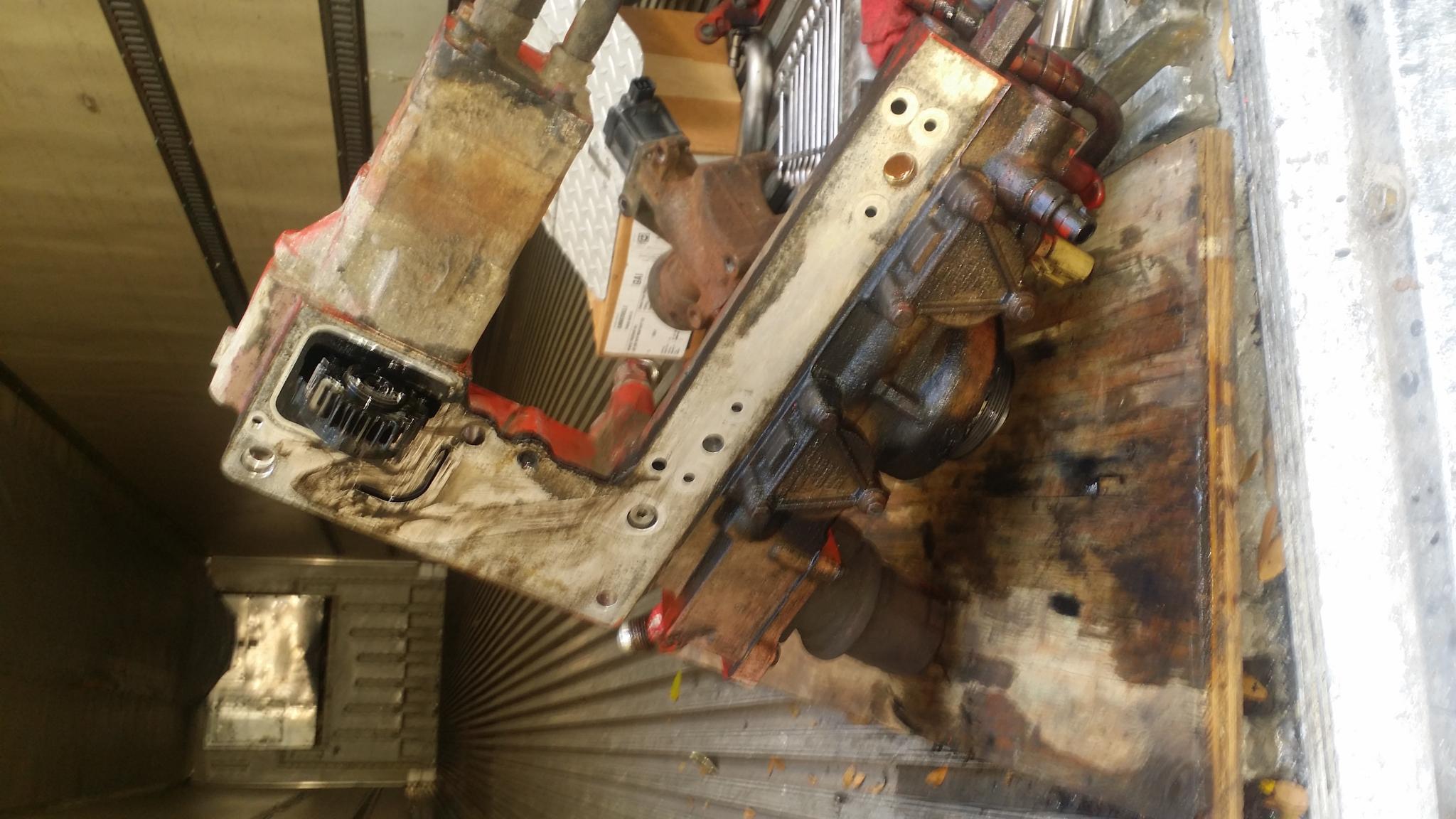

RE: CM 870 hard start issue (04-04-2018 )Evotrucker Wrote: Hey guys I finally got all the gaskets n o'rings in today. I'm disconnecting all the sensors n lines right now. How do I disconnect these two lines? I fucked up on one of them.... help?... The lower one is supply and upper is return. That style of hose connector is unfamiliar to me. I assume you already tried a crescent wrench on the hex fittings? Fyi if you're pulling the pump off, you'll want to replace the flange gasket between it and the head. its a large metal one you'll find when you remove it. #1 on Rawze's pic Also 58 and 59. 58 is on the back on lower left in pic. 59 is plug inside above the compucheck fitting next to temp and pressure sensors. hand tight when reinstalling as its soft brass. second picture | |||
