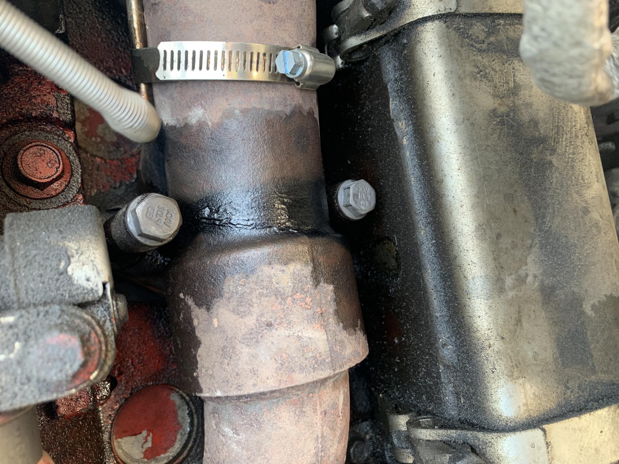

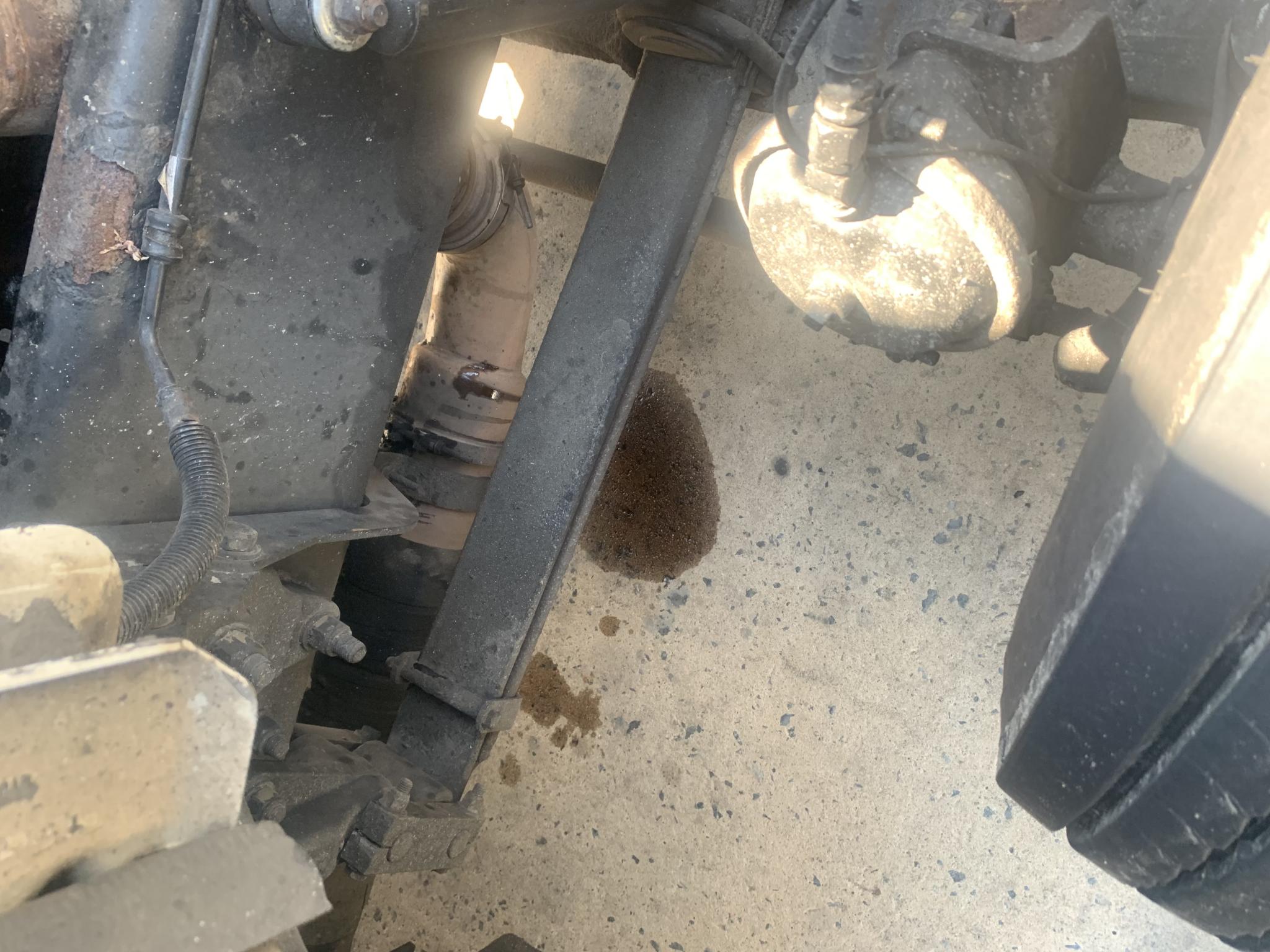

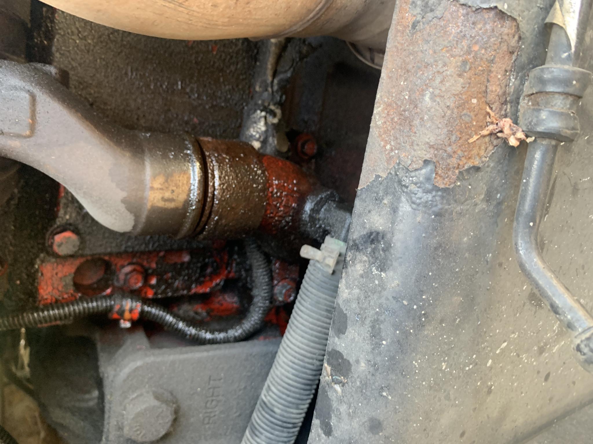

| Wet exhaust manifold I’ve got a cm2250 @m*m^2 delete with 798k I’ve noticed in the last couple days I’ve been smelling a slight burning smell (oily) that’s more noticeable when pulling grades I’ve also noticed a little smoke from under the hood Truck seemed to be a little down on power when I was on my way home fully loaded the last 10 miles or so Friday night Yesterday on the 4th I went under the hood to check my cac and noticed my exhaust manifold is wet around cylinder 5 Also the egr cooler is wet around the rear coolant port (also oily) and there’s a puddle on the floor Also oily The hot side of the turbo doesn’t show any wetness just soot recent work to the truck include Reman turbo new manifold gaskets egr cooler seals etc And a new cyl 6 injector I installed a week ago The truck doesn’t have any noticeable smoke out the exhaust except for right after I changed the injector it smoked until it was warm And no crazy blowby our the oil cap | |||
