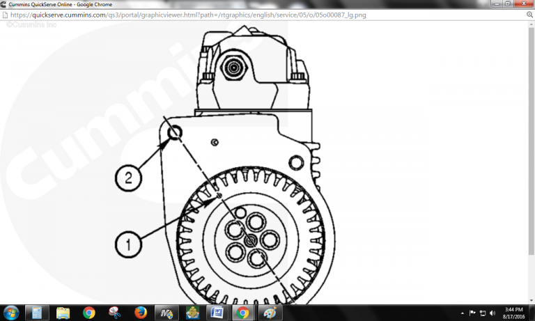

(08-17-2016 )sbtrucking Wrote:  Got a new fuel pum for my cm2250, how does the fuel pump go in the gears does it need to be timed? I see a dot on the gears
The engine needs to be in the "PIN" position on the crank. After that, this is how the gear should be aligned during the install.
It is to prevent excess engine vibration.
