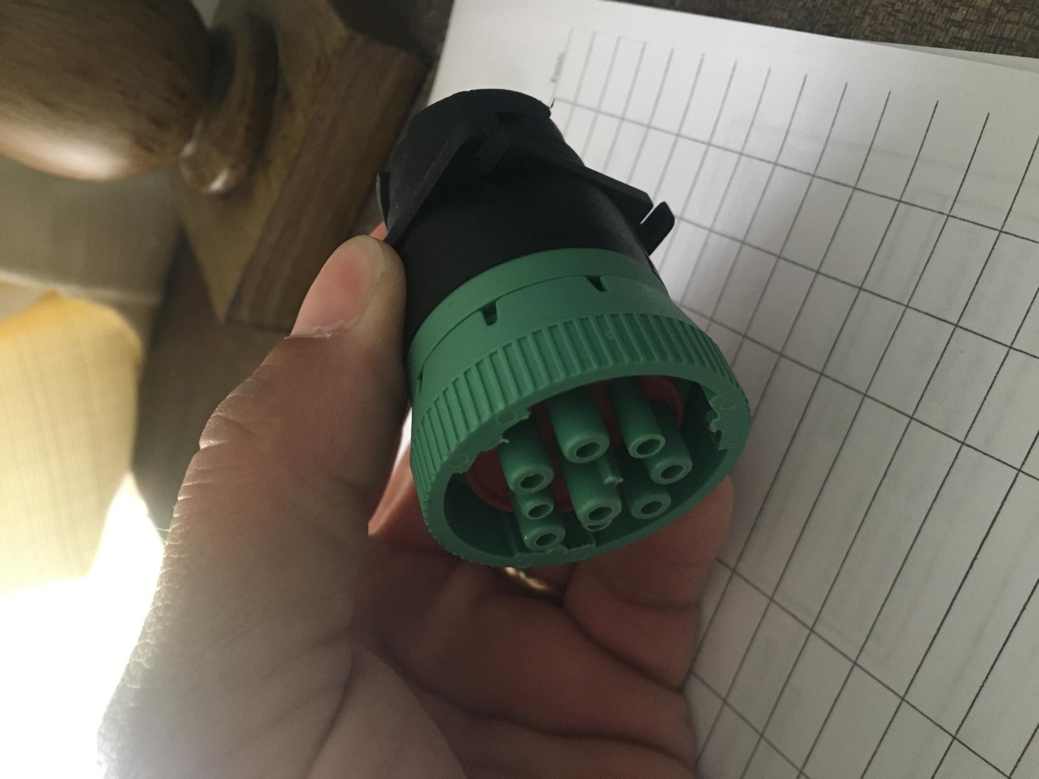

| RE: EPA21 X15 Ok so here’s what I’ve found out. 7.6.2 does indeed work with my 2450a!!! Additionally my inline 5 with a CAN1 to CAN3 adapter (pic below) hooks right into the dash and works great. I’ve changed the speed limits and jake delay as well as checked the aftertreatment history(only one so far). But now I’m at a loss, as I thought the jake on/off and clutch switch wasn’t programmed properly from the factory. It seems as if the jake comes on at lower speeds regardless of the switch being off. I realize it could be trying to build heat with the turbo position for the SCR but I’ve driven it almost 300 miles and as soon as I get in stop and go traffic it seems the turbo and/or jakes will engage slowing the truck down. Is this “normal” for these engines? It sure makes it a PITA to navigate through town for sure. User's Signature: That’s pronounced, /ˈs(k)izəm/ | |||
