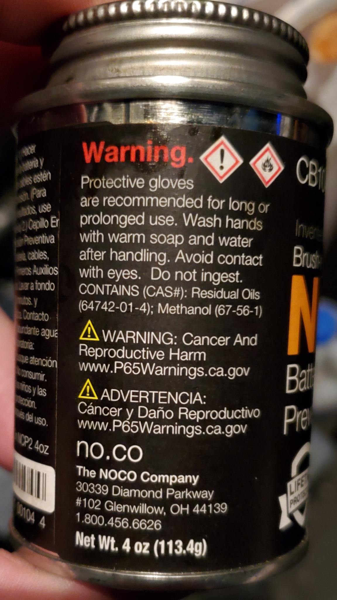

I see that NCP2 stuff says its oil based. Doesn't oil burn? I've had and seen many batteries cook so hot they catch fire. Recently had 1 on my truck that I soaked in water after knocking the cables off of it to cool it quicker because it was starting to melt. Wouldn't oil be adding fuel to the fire? Does it say anywhere "nonflammable"?

(12-04-2019 )Chamberpains Wrote:  I see that NCP2 stuff says its oil based. Doesn't oil burn? I've had and seen many batteries cook so hot they catch fire. Recently had 1 on my truck that I soaked in water after knocking the cables off of it to cool it quicker because it was starting to melt. Wouldn't oil be adding fuel to the fire? Does it say anywhere "nonflammable"?
I would think that if a battery got hot enough to catch a bit of oily (or tar-like) terminal protectant on fire, that would be the least of your worries at that point.
It's got the flammable placard.
It's a cancer aid and has reproductive harm...hmm maybe this should be a substitute for sweet and sour sauce for California.
The diesel is flammable the gear oil is flammable, the hair spray is flammable, and generally the contents of the trailer are flammable.
Fun fact, wd40 is flammable also.
I get what your saying, I don't have dielectric grease in my truck...yet.

My concern wasn't that you shouldn't carry flammable stuff. Hell I have a butane and propane torch in the truck at all times and carry two 3 gallon cans of gasoline.
My curiosity was with putting an oil based product in an area that can cause it to burn or even expedite a burning situation if the batteries short out.
Rawze kicked a hole in my stupidity. It's all good.
