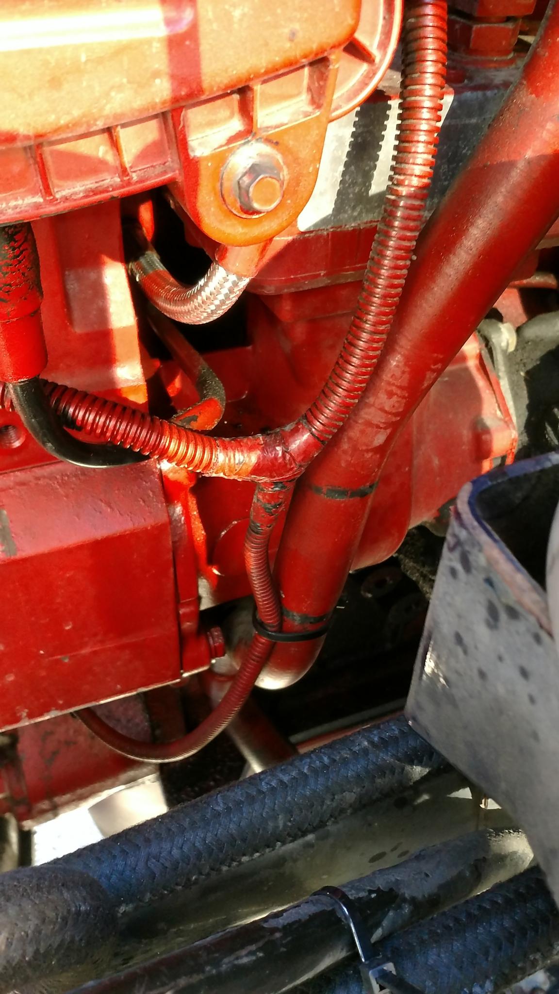

| 12-11-2017, (Subject: Excessive crankcase pressure? ) Post: #6 | |||
| RE: Excessive crankcase pressure? Driver front User's Signature: 2010 T2000, CM871, 13spd, 1.173m, tanker yanker Overhauled @ 927k | |||

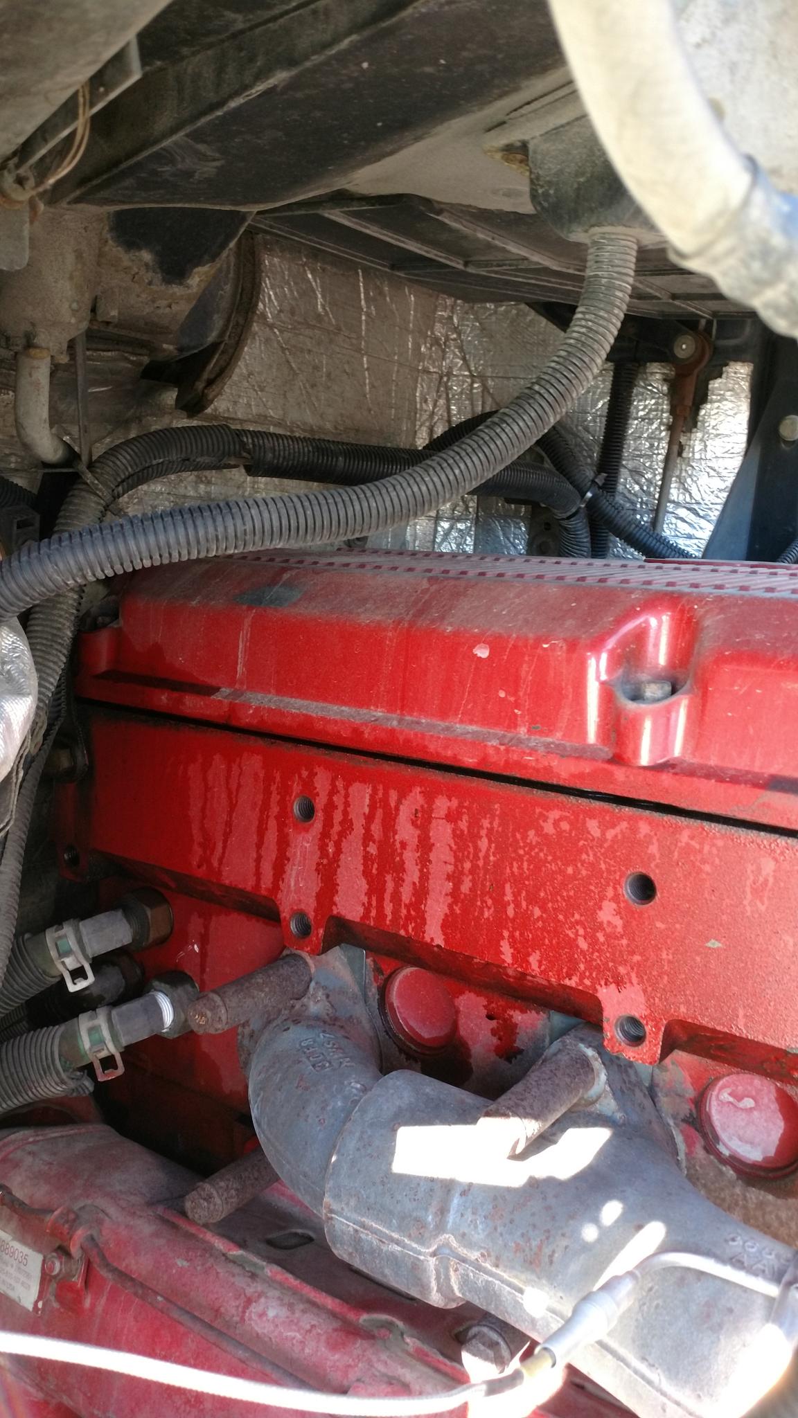

| 12-11-2017, (Subject: Excessive crankcase pressure? ) Post: #7 | |||
| RE: Excessive crankcase pressure? Passenger front User's Signature: 2010 T2000, CM871, 13spd, 1.173m, tanker yanker Overhauled @ 927k | |||

| 12-11-2017, (Subject: Excessive crankcase pressure? ) Post: #9 | |||
RE: Excessive crankcase pressure? (12-11-2017 )dhirocz Wrote: ...already have the new element. MY take on it is when the bearings in the head are shot,... so it the head. Leakage down the side of the engine cover is something else. make sure the gasket is good and it is torqued properly. User's Signature: ->: What I post is just my own thoughts and Opinions! --- I AM Full Of S__T!. | |||
