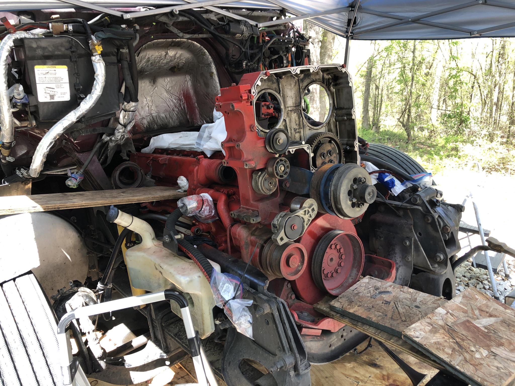

04-11-2018, (Subject: ISX-15 pushing coolant out of reservoir tank -help- ) Post: #18 | |||
RE: ISX-15 pushing coolant out of reservoir tank -help- Drop the pan and pressurize the coolant system! Don’t be an idiot like I was! I can nearly 100% guarantee it is not your compressor. I just went through all of this less than two weeks ago. Everything you are describing is a bad head or head gasket. I am getting to be a pro at this stuff, now I am in framing my own damn motor in Rawze’s driveway! Here I am, 2 years almost to the day after doing what you are planning on doing. I just took this photo on my phone, like 1 minute ago. | |||
