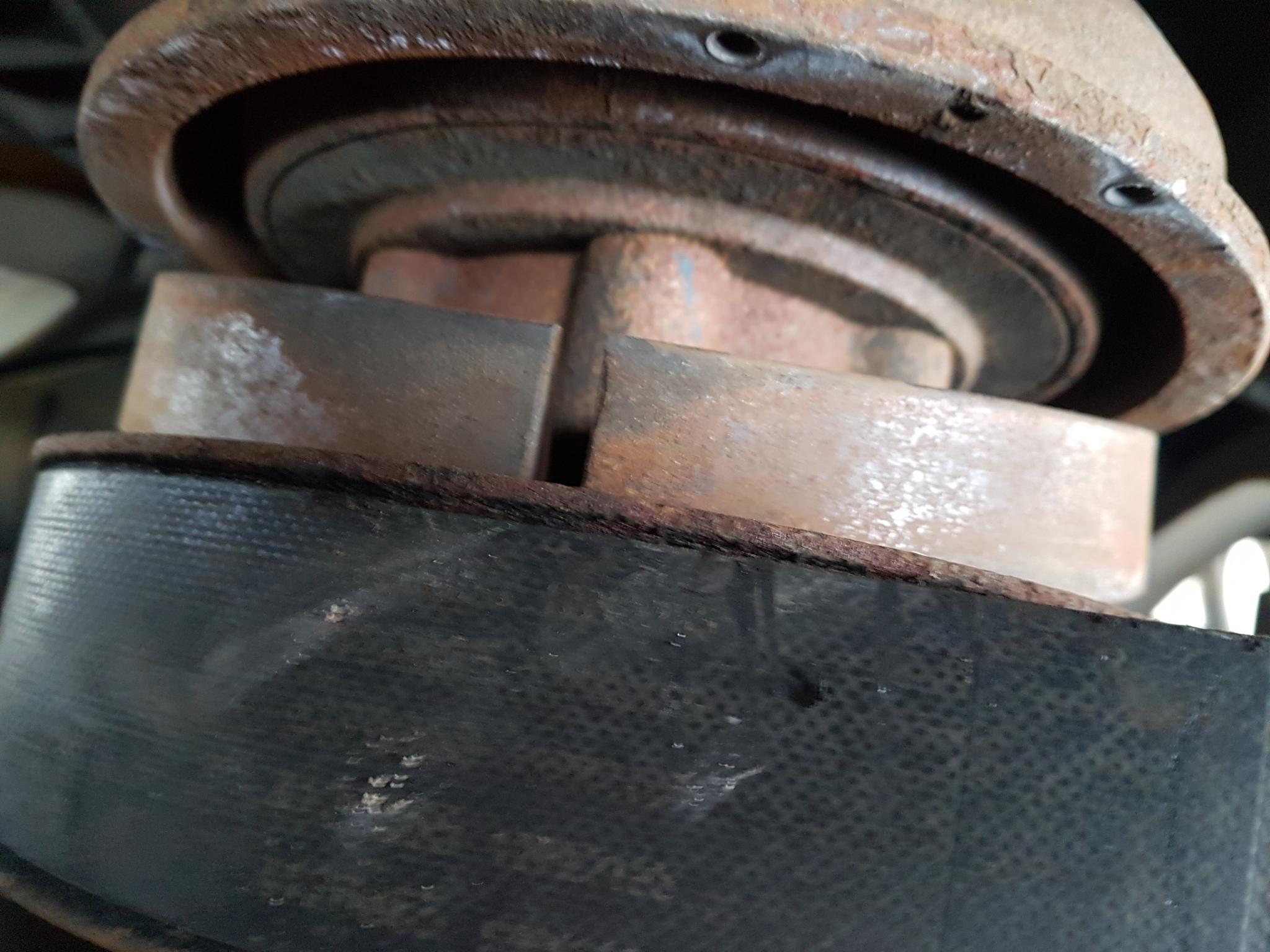

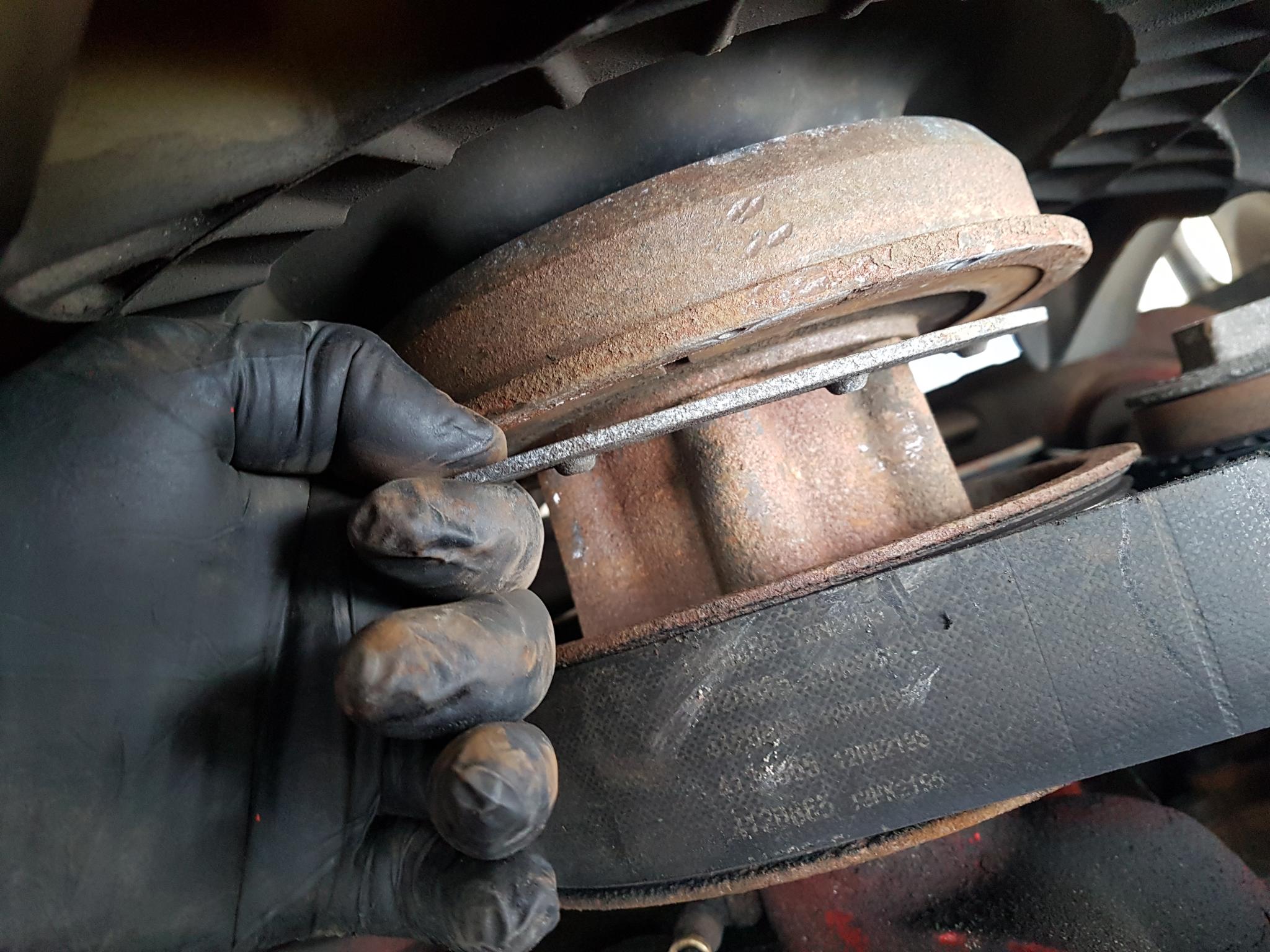

RE: Finally bringing Prostar home to fix.... Update: I fixed my fan issue and it was unrelated to my ecm ignition power loss. From sitting so long, there was some rust buildup I needed to take care of. I unbolted the 3 plates on the back of my 2 speed fan hub pictured here.... Then turned the ignition on so there was air going to the hub and lightly tapped it with a hammer till I felt the fan pop loose. I then got the centre ring out as shown and gave it a bit of a cleaning before putting it back together. I should have known right away this was the problem because my fan hub was not free spinning. When I would turn my fan by hand, the hub base and pulley spun also. Before I disassembled, I confirmed there was proper air pressure getting to the hub. Now to try and get this ecm code back so I can figure that out.......... User's Signature: I'm no mechanic, I'm just a guy that breaks down enough to know a bit. | |||

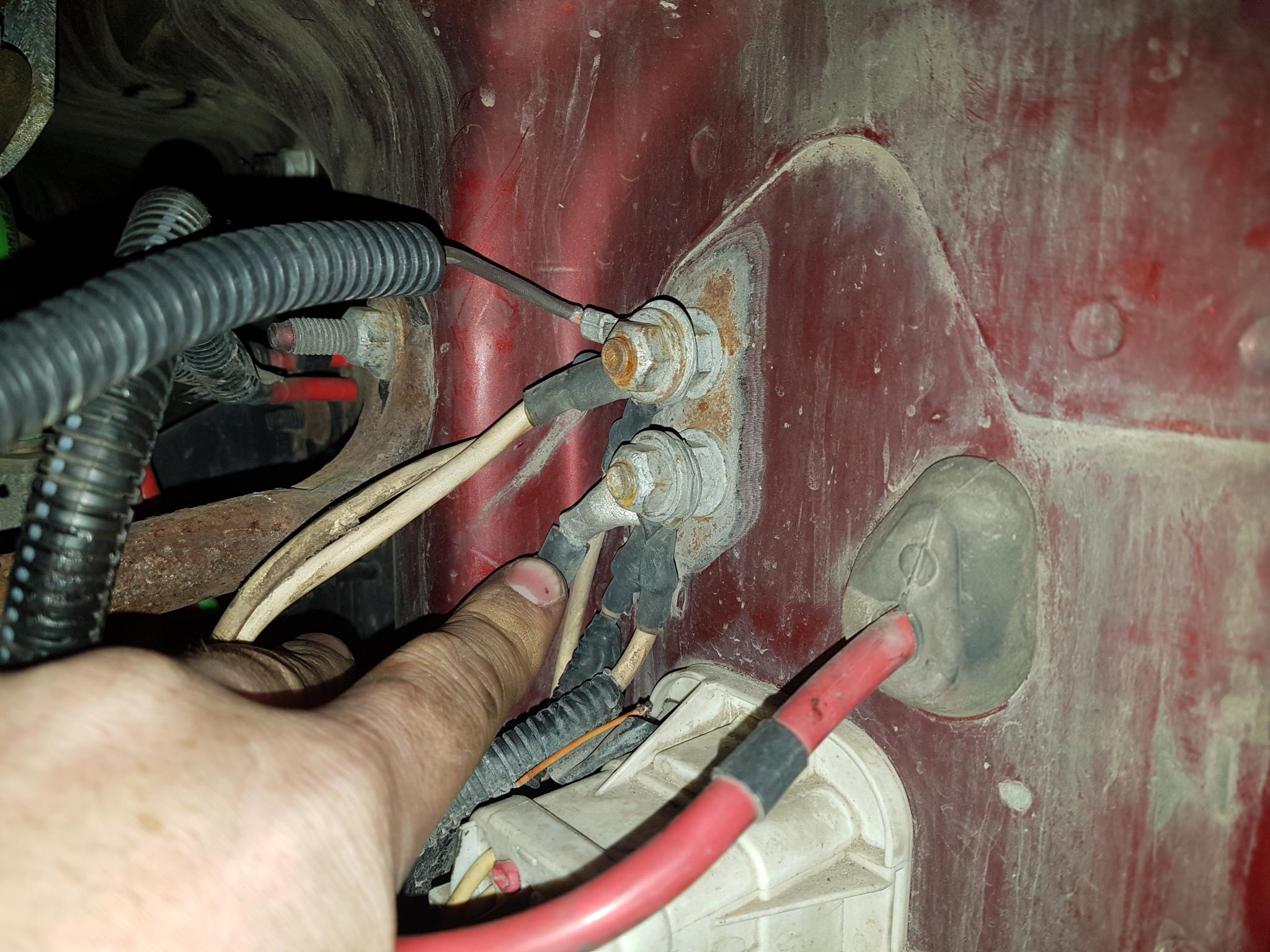

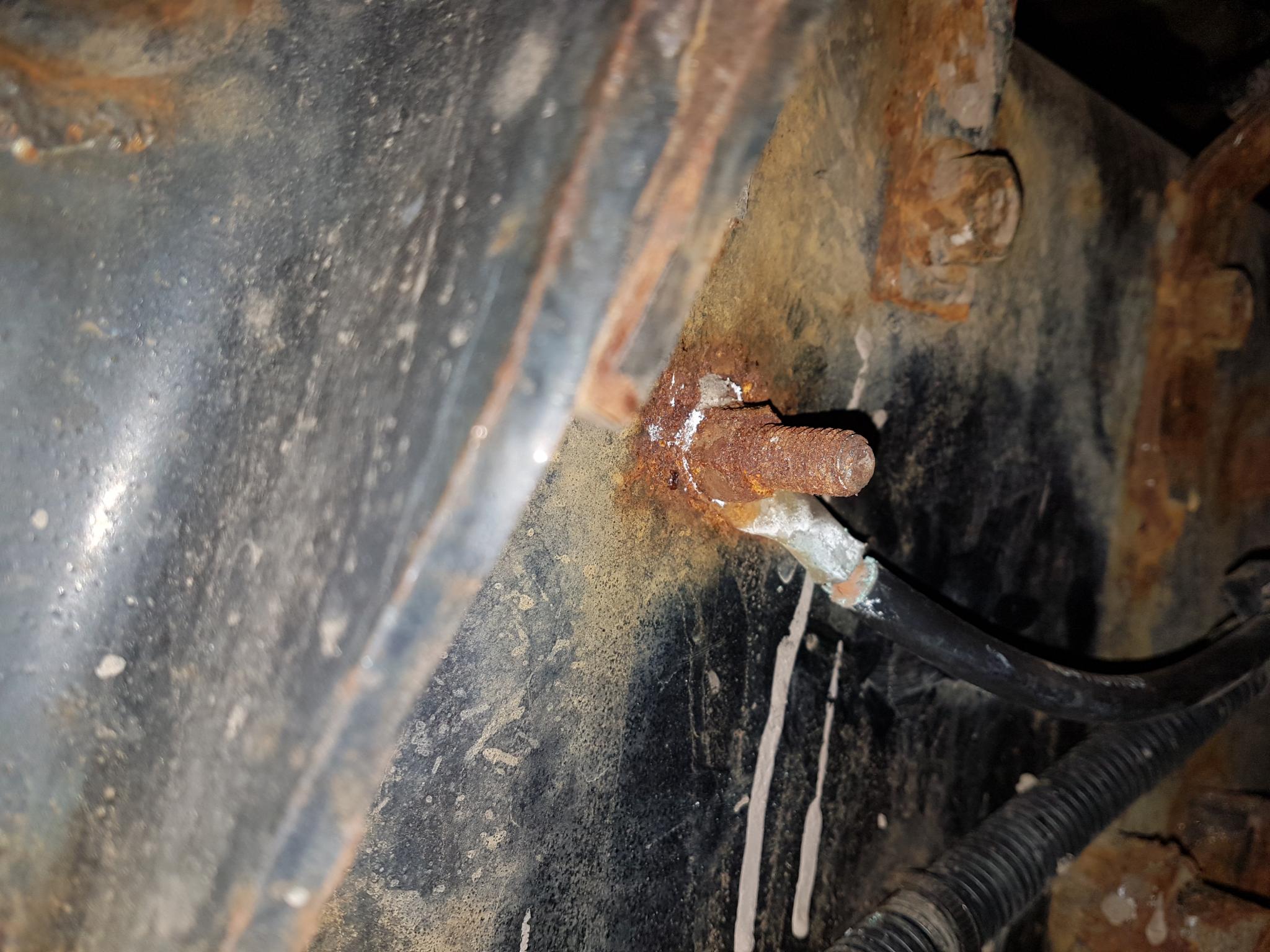

RE: Finally bringing Prostar home to fix.... Gonna try one more thing here tonight. All grounds were cleaned by my old mechanic but looking at this one here, I do not like it one bit. Met with starlight today and he mentioned the firewall grounds so I rechecked these...... These posts are on the firewall and seem to have all sorts of grounds running from/to them as well as the big black one I'm pointing at which runs down to the frame and is attached to the same bolt as the starter ground to inside of frame.... Let's hope this is my issue right here....... User's Signature: I'm no mechanic, I'm just a guy that breaks down enough to know a bit. | |||

RE: Finally bringing Prostar home to fix.... Update to the update Cleaned it up and now everything seems mint. Drove it or 45 minutes with no issue at all, gonna let it cool and come back tomorrow to try again but it's looking promising. User's Signature: I'm no mechanic, I'm just a guy that breaks down enough to know a bit. | |||
04-13-2018, (Subject: Finally bringing Prostar home to fix.... ) Post: #18 | |||
RE: Finally bringing Prostar home to fix.... Those dang grounds. I got the feeling you might have it fixed. Those ground wires look pretty bad. | |||
