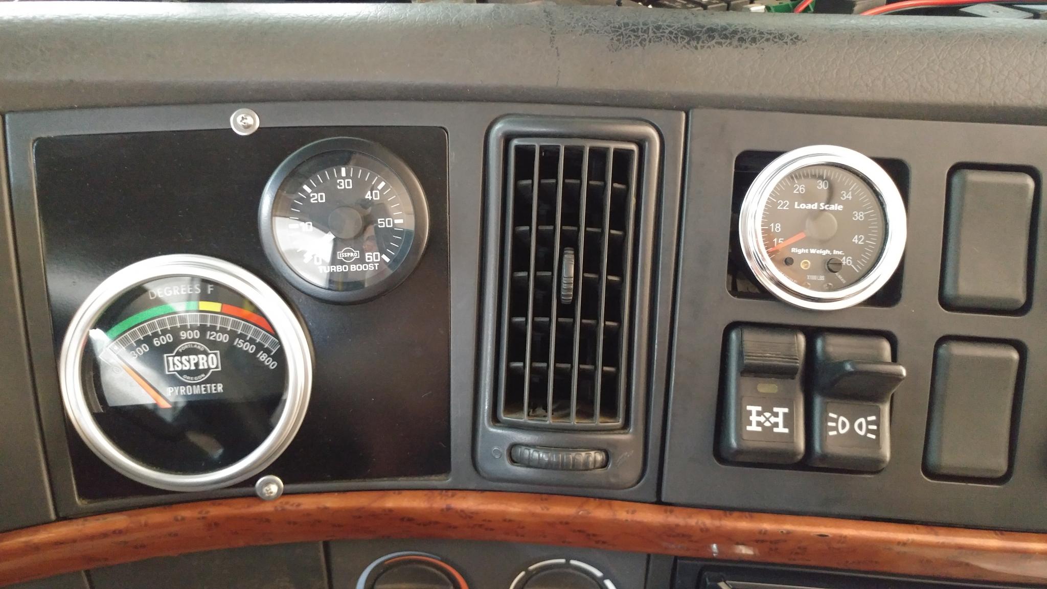

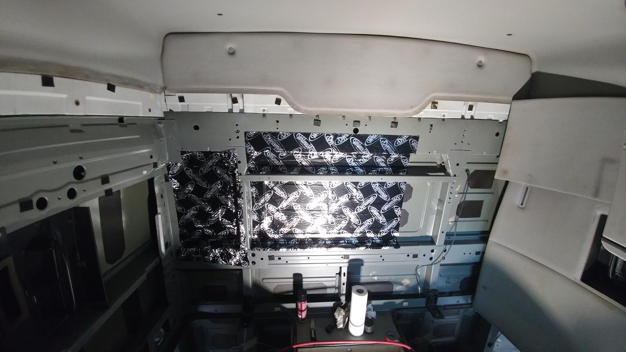

| RE: Getting started with a 2005 Volvo with the ISX. Hi Guy's, It's been some time since I checked in. Been working on the truck and just about ready to hit the road in July. I have pulled the interior and gave it a good cleaning, put in dynamat, replaced the floor mats and seats. I have installed the gauges, Pyro, Boost and Load. I also replaced the air springs and all the brake chambers along with inner front fender wells and rear quarter fenders. I ran the overhead and everything looks good plus replaced some A/C lines and got the A/C going. I also installed a 2000 watt inverter for power and plan to mount some batteries to the passenger side frame mount for extra capacity. All in all good progress | |||
