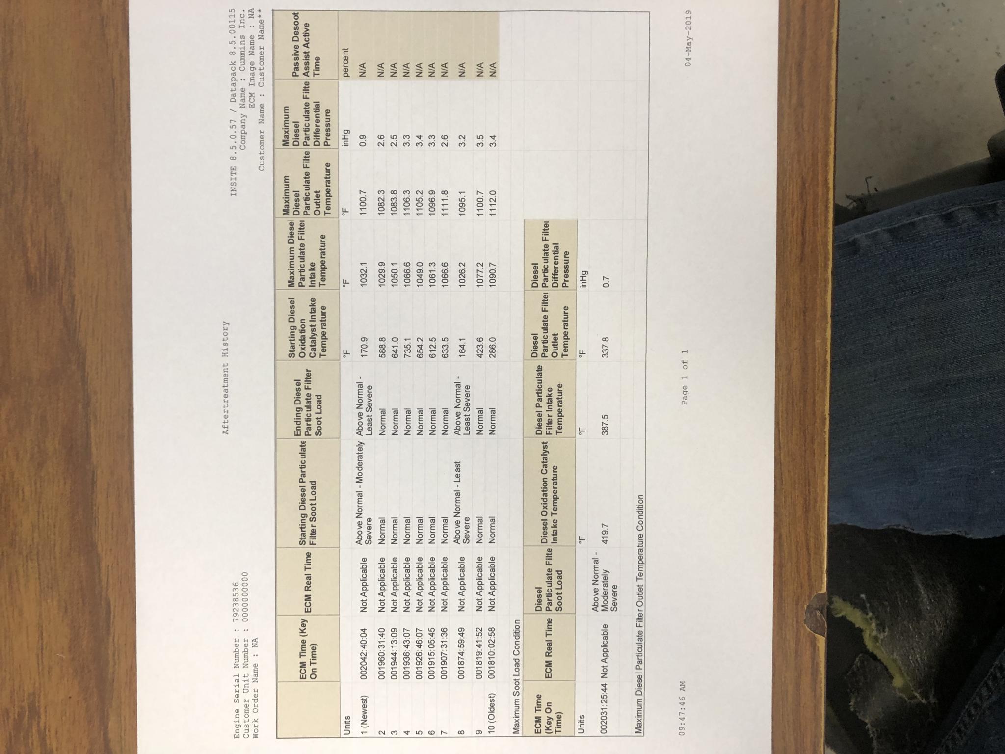

How do I add a photo? I have a picture of an after treatment history I need some explanation on so I can fix this truck not just force a regen and send it out the door.

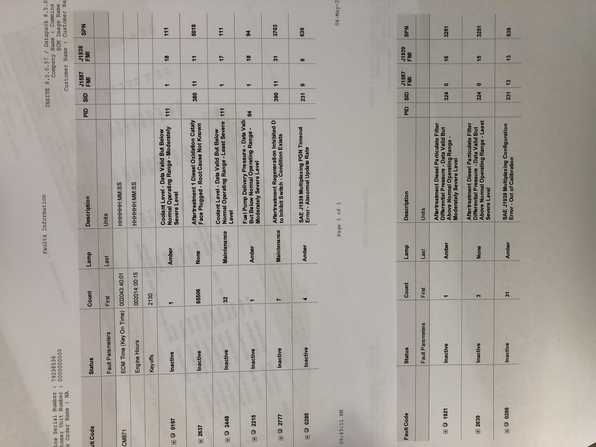

I had an active code for DPF spot load above normal moderately severe, I don’t recall the number.

This is where I need to post the picture of the after treatment history. I will try to explain the results.
Ending soot load “above normal least severe” 2042 hrs. But my DPFDP is .9? This doesn’t seem right?
Also my max spot load history is 11 hours prior 2031 hrs “above normal moderately severe” at dpfdp of .7?
And the regen prior to the one I did was at 1960 hrs! How did this happen?

Well I figured out the pictures at the end but kind of messy I’m learning!

The numbers on the far right column should not be averaging 3.0+... There has been a problem the whole time. Can be a lot of things including sticky egr valve, CAC leaks, clogged cross tubes for the DPF, Bad DPF Delta-P sensor, bad DPF Temp sensor, incorrectly reading IMAP or other sensor,.. etc. etc.
Pull the cans, both the DOC and the DPF,.. take pictures of their faces and post them here. That will tell you a LOT. While they are off, have them baked and flow tested.
-- You should NEVER EVER do a maint reset on the system without having the DPF and DOC flow tested/baked as it will reset it in a partially blocked state and throw off all the readings!. Now, the only way to fix this mistake is to to pull your DPF and DOC and go have them flow tested and baked out,.. THEN DO A PROPER RESET ON THE SYSTEM WITH INSITE!
