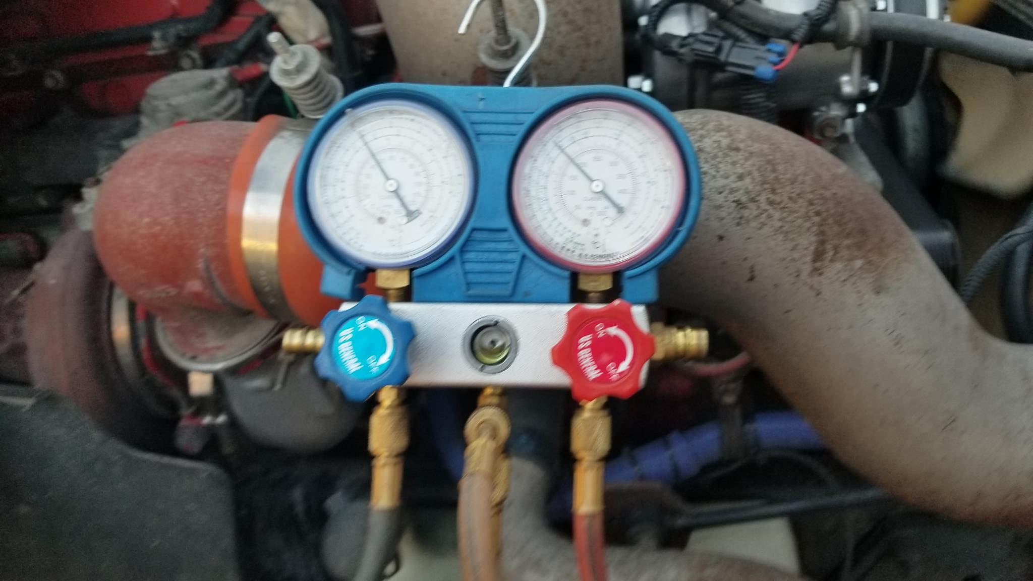

I put a gate valve in the inlet of the heater core...they now are telling me that the valve is causing my evaporator to freeze up...
I hooked up my gauges and the low side looks ok but I'm puzzled why the high side pressure climbs like it does till the compressor kicks back on and the fan hub locks up....all the while the air from the vents is barely cool...certainly not cold...
06-30-2019, (Subject: RE: Prostar ac )
RE: RE: Prostar ac
stop the flow of water to the heater-core and see jhow cold it gets... blend door issues are the most common reason it only barely gets cold.
those gauges show it a bit over-charged if u ask me,.. but i am not an A/
C guy,.
also make sure your radiator and condenser and CAC are all clean, not dirty. If running water into the condenser gets it nice and cold inside the cab, that could be a real big clue that the condenser is not cooling properly.

Low side drops to 20-25 while compressor cycles. The high side is at 140-150 till compressor cycles off then climbs to 340 at which time the compressor kicks back on and fan engages...
