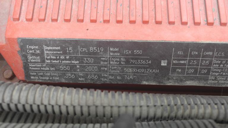

So,I watched the video,looks easy enough. If I can set a solid cam on a sbc i think i can do this lol so I set to what it says on the tag here?

So I turned it to A, and 6 was loose,so I turned again to A and 1 is loose but if you try to put a feeler gauge under were u adjust it's to tight.
So I turned motor over again and again and made sure 1 was loose to do adjustment and again the correct feeler gauge won't fit.
The adjustments on the valve cover match the ones in the video rawze made. I'm just going to go through and adjust accordingly lol

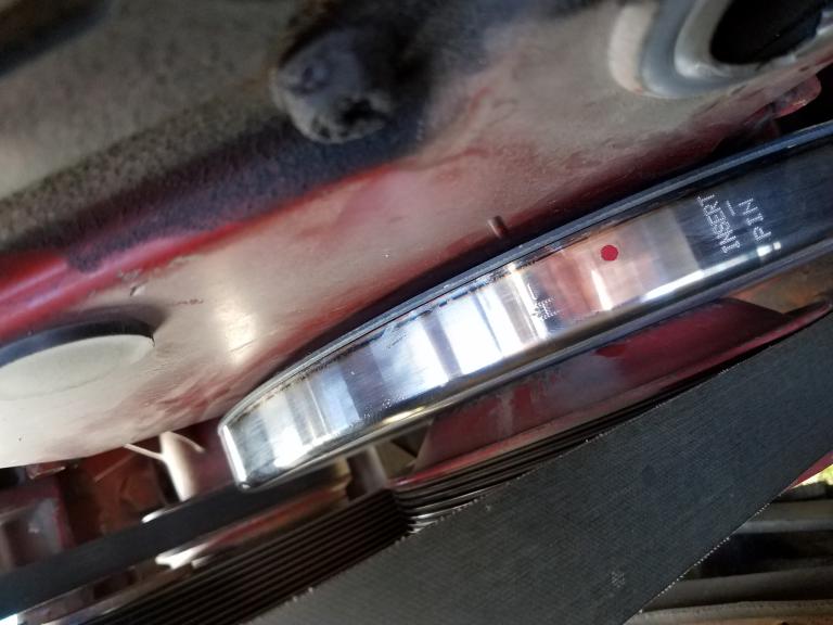

I know I need to paint the damper also lol
