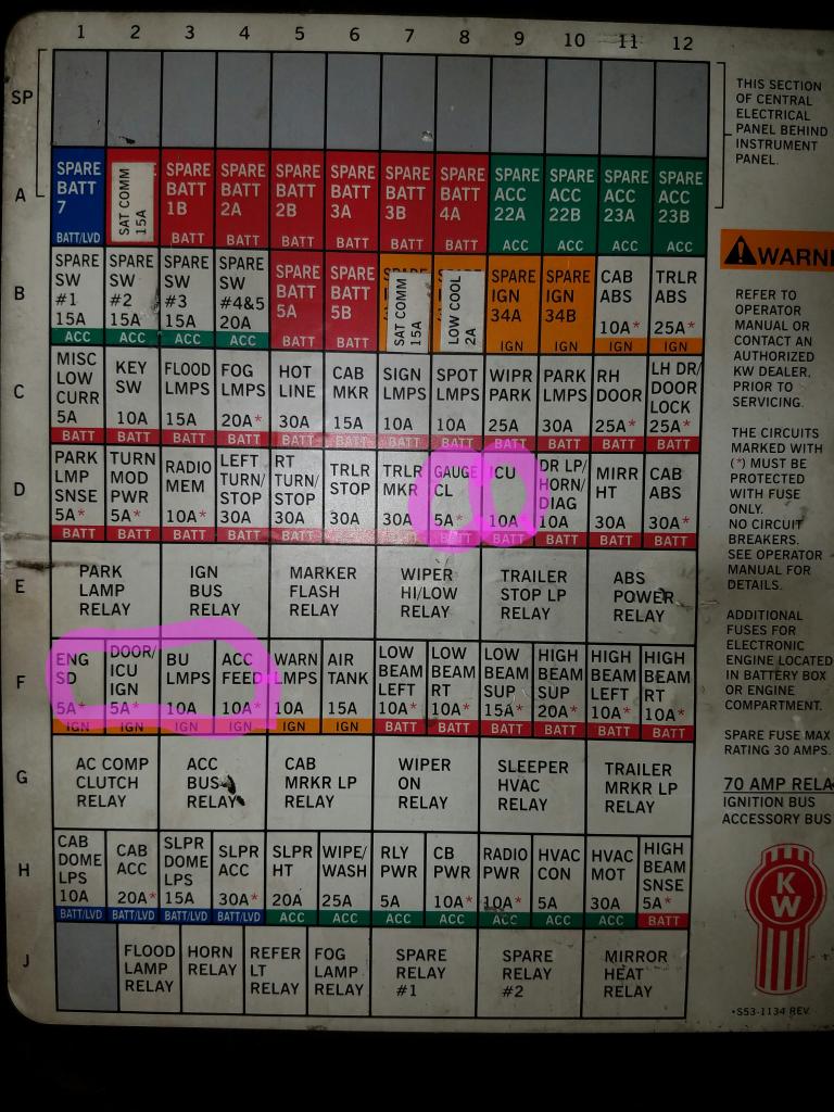

I had this happen to me not long ago. It was one of the fuses, I don't remember which one. Panicked but checked all the fuses and there was one blown.
Check all the fuses very carefully first, very cheap to do this work.

Was it a fuse or relay? You can't remember which one? I looked on my fuse cover and I can't seem to find anything with steering wheel, cruise control or jakes...
10-30-2016, (Subject: Cruise control and engine brakes stopped working?? )
RE: Cruise control and engine brakes stopped working??
I think one of these that are circled. Happened out of the blue no rain or anything.
I think it's gotta be a loose wire somewhere behind the dash.
I've got a 2007 t600.
./uploads/201610/post_2083_1477804714_ed478675f6963c16683732836daa3565.jpg

Cool!! I'll check those out tmrw before I buy the part. Hopefully it's just a fuse.. thanks
