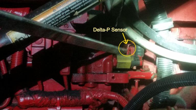

problem is i don't really know its location. let it hang?? explain i really don't give a flying f%^& about the mandate

On the 870 it hangs just above the starter. Look for the tubes (like big brake lines) going into the exhaust gas tube. Those little tubes will lead you to the differential pressure sensor (delta p). What I meant by killing the government mandate is de$ete the EGR "if your using the truck off road".

870 Delta-P sensor Location...
./uploads/201603/post_2_1456931713_0629b18e22b43a4251e4da6400559c87.jpg
its behind the brass fitting in this photo.
