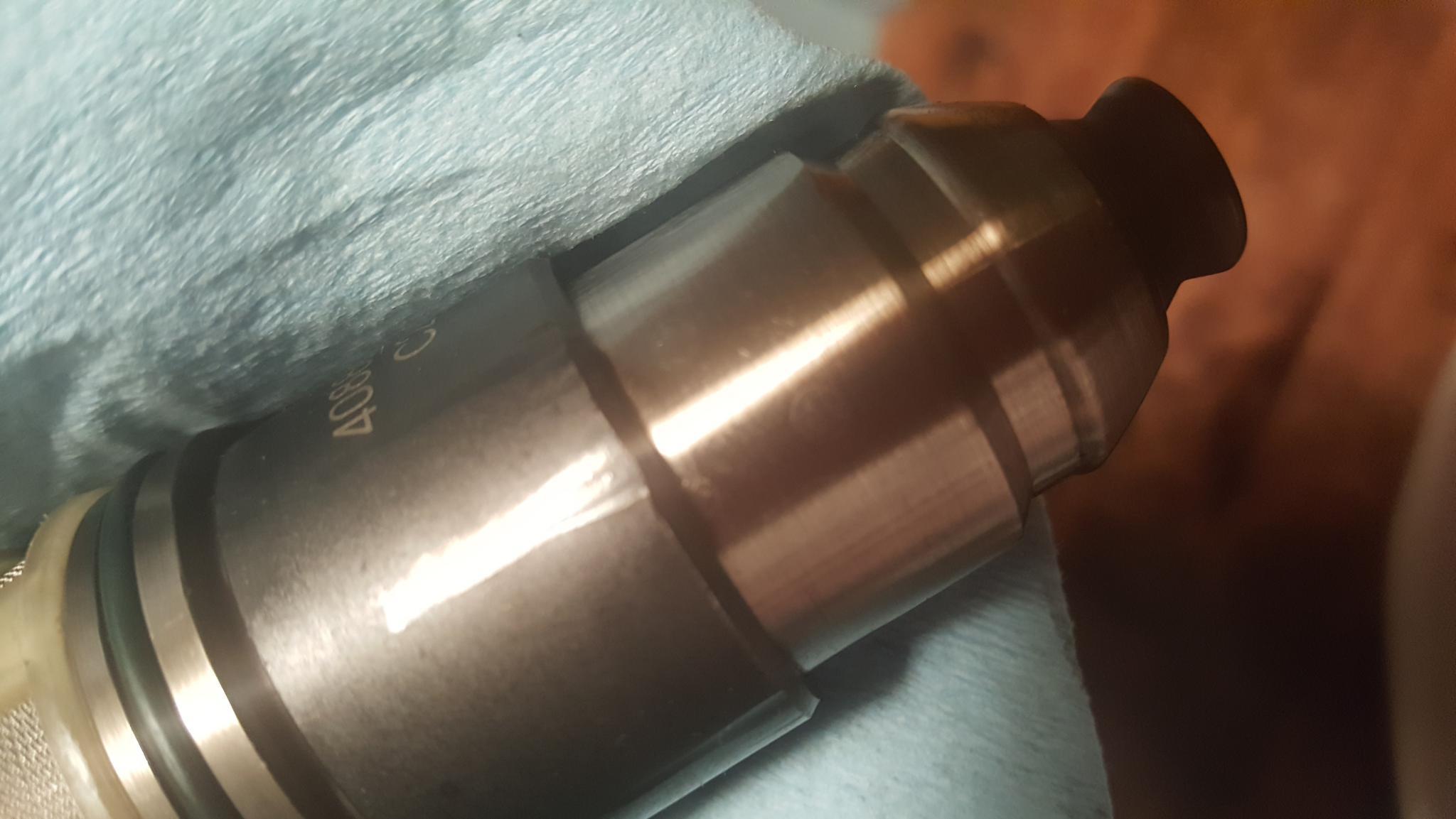

Ok.......so today I'm in chicago at a rail, I shut truck off to get my paperwork then started it up and it started to miss horrible, like an injector went out.
I get it home and put on computer and it had a code for cylinder imbalance several times. Did a cyl performance test and #1 failed. Did a cut out test and as soon as u try to run #1 by it self it dies instantly. And when u cut one by one #1 doesn't make a difference.
Do injectors go out like that all of a sudden?
I'm thinking (hoping ) that this rebuilt injector was bad out of the box and was weak giving me my engine vibration. Proly just a dream though
Coolant is still full, good oil pressure ,runs cool
Here is a pic of #1 I pulled out

Is it missing the ball plug?
./uploads/201703/post_1037_1488503745_582c71041eaf123a532d94db6a83d93b.png
03-02-2017, (Subject: cummins isx injector )
Post: #24
RE: cummins isx injector
No its not missing the plug

Did you do a leak test before you pulled the injector?
If yes, were there any bubbles?
Sounds to me like, yes you got a bad one.
Have you tried moving it to another cylinder to confirm the symptom follows the injector?
You may want to try that to completely eliminate the possibility of some other issue. Moving the injector to follow symptoms is part of the troubleshooting tree, and they may ask if you did that before warranting it. Less than likely though as if it was another issue, it should be the front bank, not just one cylinder.
03-03-2017, (Subject: cummins isx injector )
Post: #26
I didn't do the leak test, I do have fancy plate and hose from cummins though.
I got an injector and switched it out this am. Took truck on a 400 mile run. It was definitely the problem.
