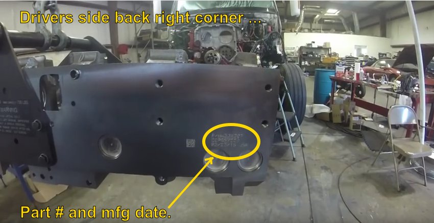

LOOK on the drivers side of the head near the rear of it. You will find out the date of manufacture and if it was a cummins re-man or not. If it is a cummins re-man it will have an RX in the part number stamped on it. As well, if the date on the head is old (more than 3-4 months before it was replaced), it is a good bet that it WAS NOT NEW OR A CERTIFIED RE-MAN!

going back down to the shop will look for that info. it was suppose to be a new head from cummins. but that was the same shop that was suppose to get a new clutch 2 week earler and i already found out i payed for new but it was not new.

(04-03-2017 )linadin Wrote:  going back down to the shop will look for that info. it was suppose to be a new head from cummins. but that was the same shop that was suppose to get a new clutch 2 week earler and i already found out i payed for new but it was not new.
Mr. Hag down at his shop sees about 3 or 4 engines a month with bad heads that were supposedly replaced with new by everything from mom-pop shops the stealershits where they were charged for new, but got some local re-worked POS that didn't last 200k miles.
He has one a couple weeks ago that came in from another shop that was supposedly replaced with a brand new head, and even the customer of that shop was charged for it and it said it on the paperwork. -- The DATE STAMP WAS FROM 2004~!. It was even 4 years OLDER than the engine itself!. -- AND THE HEAD WAS SLAP WORN DOWN TO THE BONE, VALVE SEATS SO HIGH THE ROCKERS WERE RIDING THE CAMS!. -- It obviously was a junk-yard head off an old engine that someone tried to re-work.
