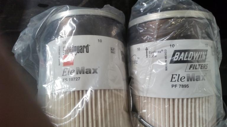

So far I am happy I switched from the factory specified 50 micron Davco filter to a 10 micron filter. Check them every day as part of PTI
03-11-2016, (Subject: Fleetguard fuel filter interval for isx15? )
RE: Fleetguard fuel filter interval for isx15?
Which filter did you switch to?

i use these..
./uploads/201603/post_2_1457788547_d9f2ed40dcdb74496e118b1555828609.jpg
