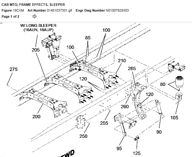

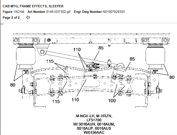

RE: ProStar Sleeper Suspension Modification...
A few months ago Navistar went back to the separate bag and shock system with a cross bar. I sold the truck already but I can take a few pics if it comes back for service before I get some more in. In the mean time I looked it up in the parts catalog and attached the figures. Bags are in the price book for less than $80 ea. Shocks are not priced yet. Probably have to piece out the whole deal unless they decide to come up with a retro kit.
