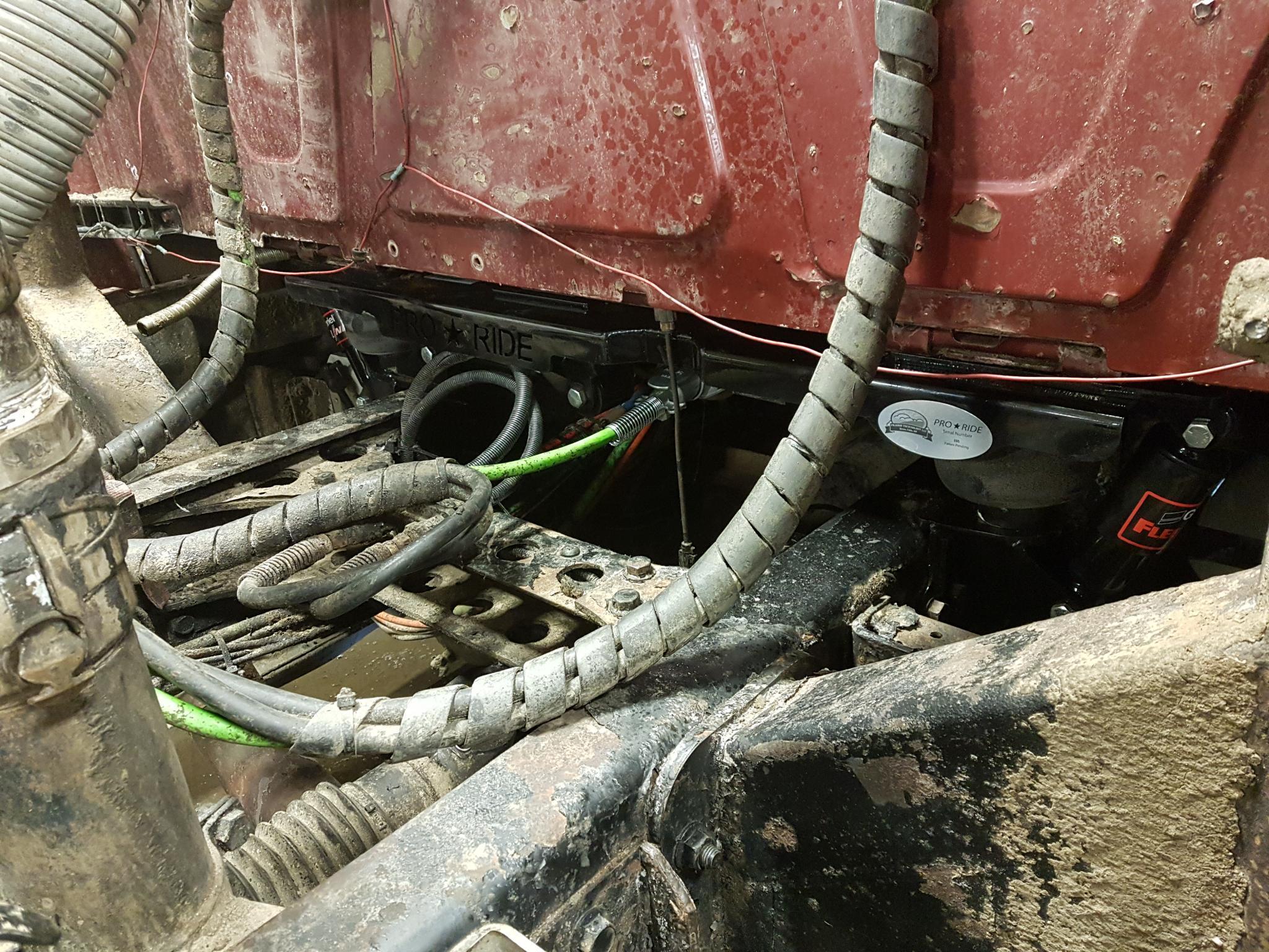

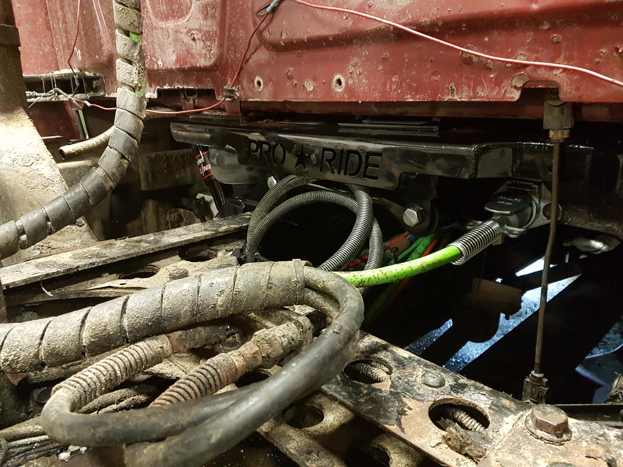

Got it installed. Looks good, feels good inside the cab for the little driving I did but my shocks were screwed so I wouldn't be able to tell if they were better than factory.
02-16-2017, (Subject: ProStar Sleeper Suspension Modification... )
Post: #31
RE: ProStar Sleeper Suspension Modification...
That red wire running across the back is exposed wiring. A D.O.T. violation.
Post: #32
Lol I knew you would catch that! That was a quick 2 minute -40c patch to give my driver work light. It's now fixed after this pic was taken.
