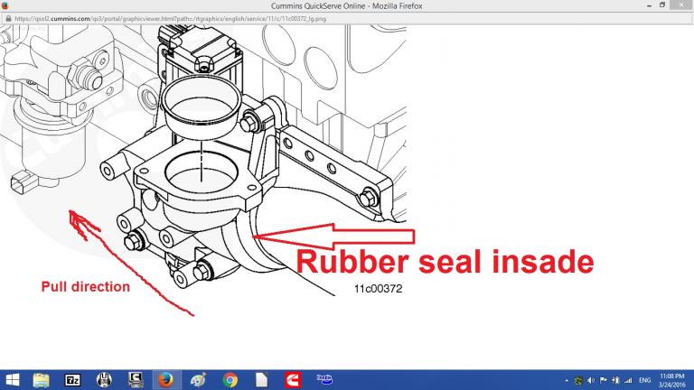

1. Disconnect all wires from battery. It's very important!!!!. EGR will short them on the starter if you don"t.
2. Remove this freaking splash cover. There is two bolts to the rear, one bolt to the frame, two bolts holding to hood support and remove hood release cable.
3. Remove ventury pipe, EGR to intake pipe.
4. Remove heat shield from EGR
5 Unbolt EGR and rock it from side to side simultaneously pull it out toward vehicle front.
EGR is sitting in kinda rubber seal. Some effort required. Once EGR is free slide it little bit down on the starter and turn it around and pull outside.
Side fairing should be removed.
all bolts are metric.

Some pics.
./uploads/201603/post_1794_1458883604_bf26dba113049757da7841671b13e32e.jpg
