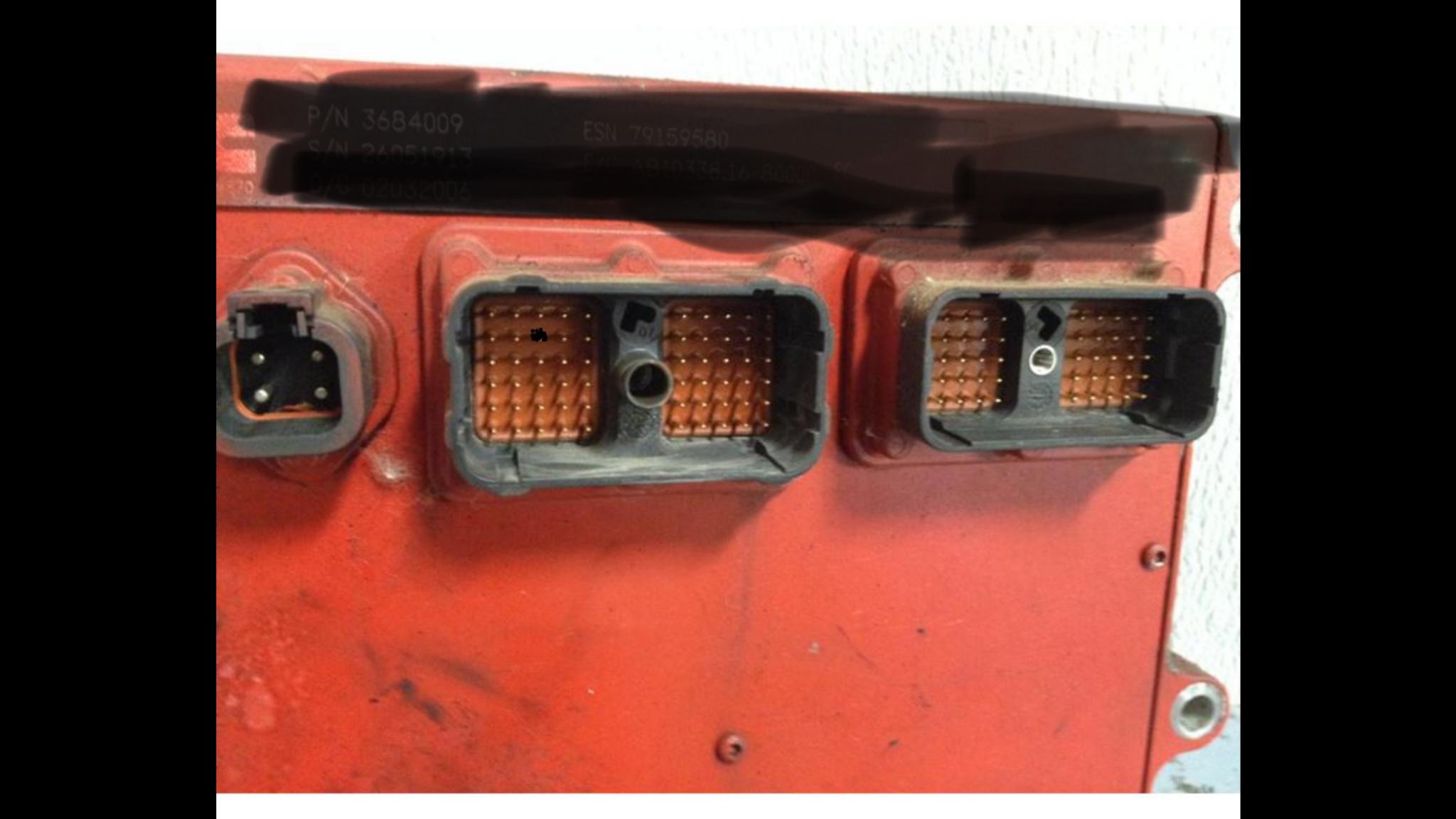

| What pin is this? I attached a picture and marked the pin for clarity? | |||

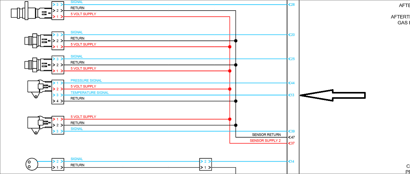

| RE: What pin is this?  I am sorry I don’t have a clue, but If you have a quickserve account set up for that engine number, (it is free by the way), you should be able to find a pin-out diagram for all of the ECM pins!  User's Signature: Anti-seize EVERYTHING, Except injectors...Use Petroleum Jelly!!! | |||
|  02-07-2018, (Subject: What pin is this? )  Post: #3 | |||
| RE: What pin is this?  It's pin 13 engine plug. IMAP temperature sensor signal.   | |||
|  02-07-2018, (Subject: What pin is this? )  Post: #4 | |||
| RE: What pin is this? (02-07-2018 )snailexpress Wrote: It's pin 13 engine plug. IMAP temperature sensor signal. I stand corrected, sorry I missed the OEM side and Cummins side. Like an eager over-achiever, I just looked at left side of ECM, so left side of diagram, hide the crayons, I can't color inside the lines... I don't want to give bad info, so I deleted my posts, thanks for pickin up my slack snailexpress User's Signature: Why? Why do I always ask "why?" Because I can't learn or help teach others with "'cause I said so..." | |||

| RE: What pin is this?  Google search?  Then register your engine serial number . It’s free for up to five serial numbers . | |||

| RE: What pin is this?  Thank you very much On the EOM side pin number 13 goes to inside the cab just behind the steering column and I found out it is not connected to anything. Could be that the reason of shutting down the engine? | |||
