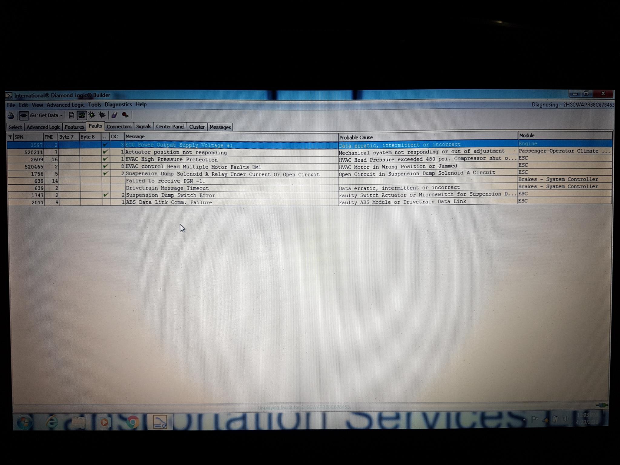

Here are some codes that I have right now, for some reason there is less than earlier today but none the less......
Truck is idling now, in a few minutes randomly it will stutter and kick off cruise and abs traction lights will come on. When that happens, the failed to receive pgn-1 will flash active for a half second.
Every now and then it will stall and if I try and start it, it'll just keep turning over but not fire. During this time the abs data link comm failure will be active and I cannot start it till it becomes inactive.

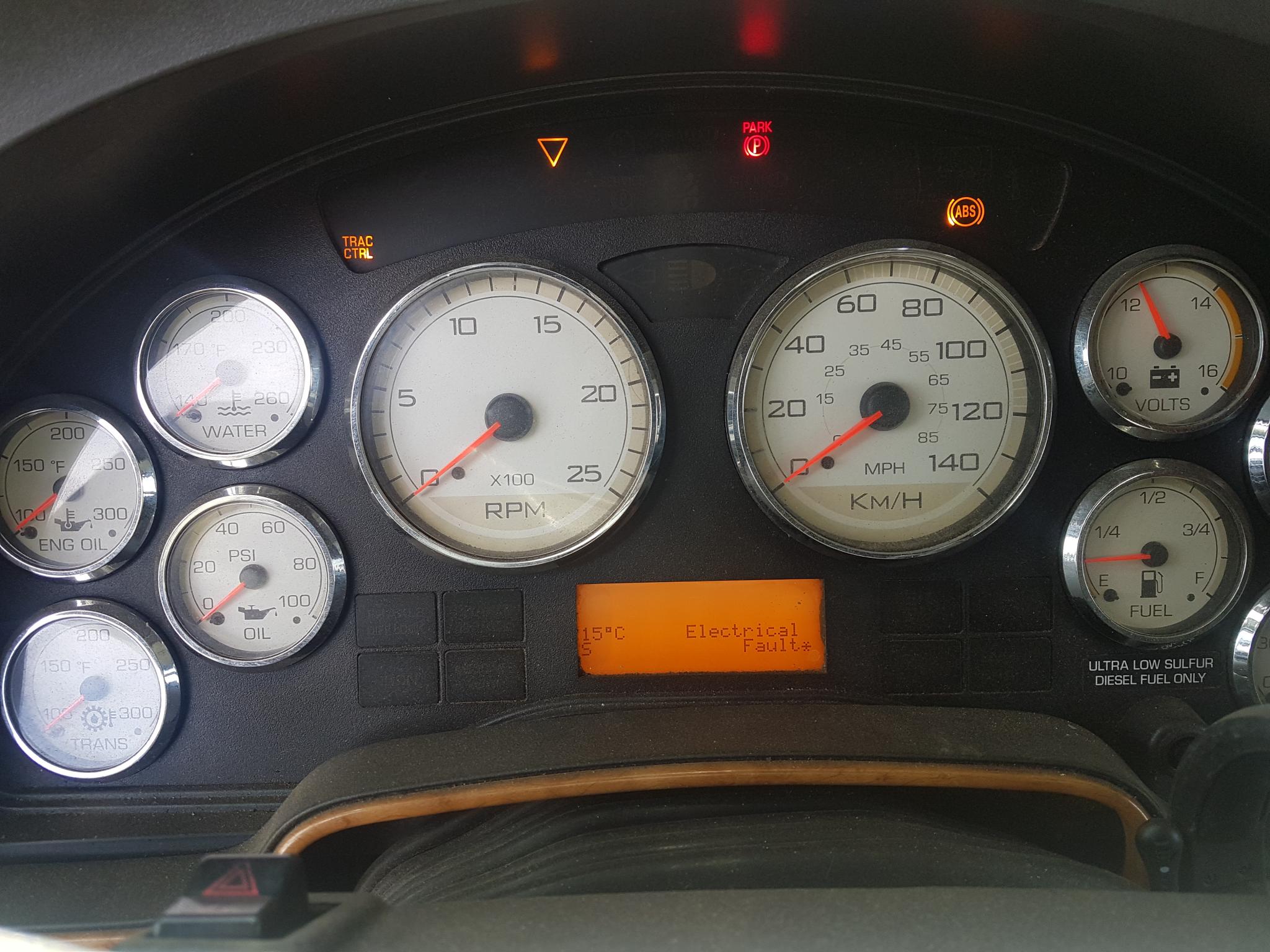

I've swapped all fuses out yes. I just read the post about the leaking roof also, I have a issue with water getting in and wasn't sure if it was a bad windshield job or what. The truck was parked all winter and when I went to pick it up in spring, I noticed my flooring was all warped and my big cupholder had a huge block of ice in it as well my cluster center display wasn't working as it looked like moisture had gotten in there..... the bottom of it has since started working but not the top part which has the mileage and the gear I'm in....
You can see the right side of the screen has some black on it still.

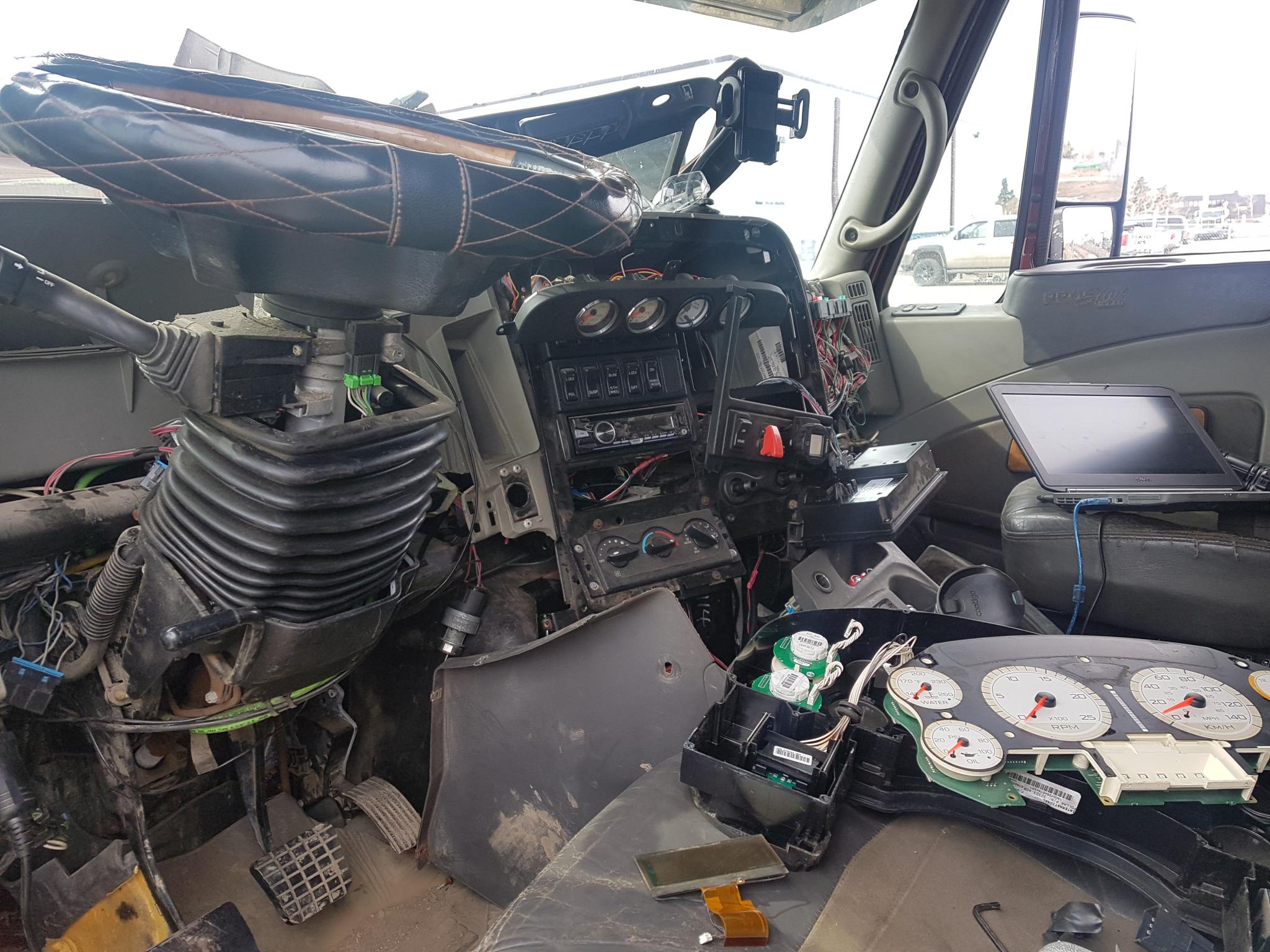

Tore all apart and still cannot find any breaks or signs of water anywhere besides the damaged odometer screen. Keep in looking. Things saying electrical fault so it obviously knows something ain't working right. Maybe the bcm is hooped but I don't know exactly how to tell without just throwing a part at it.

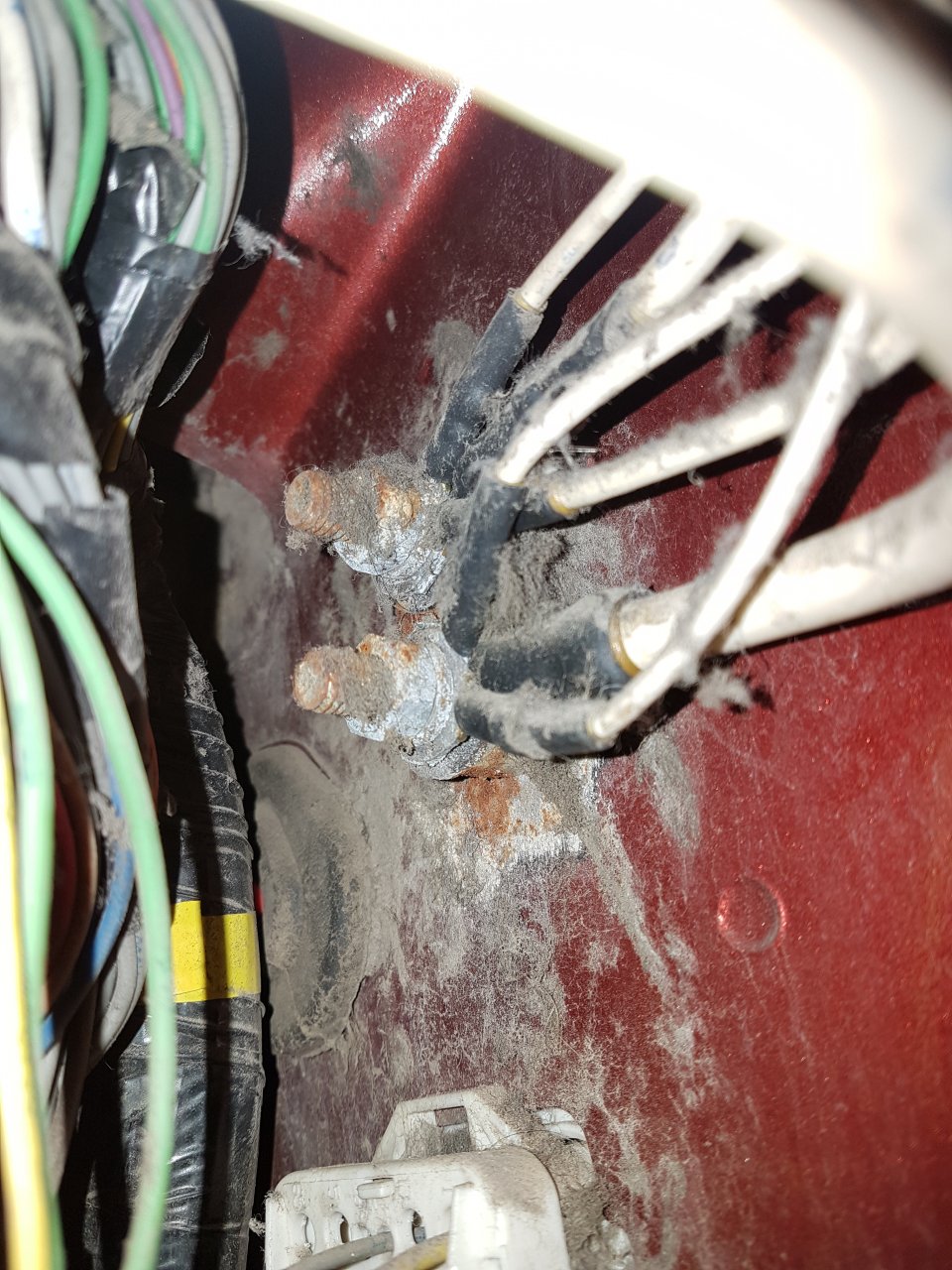

./uploads/201804/post_1367_1524625011_160f6f719aa8ac18ed63c660e48e5d4e.jpg
On the inside of the cab, those 2 posts..... I cleaned them up real good and trucks been running perfect for over a hour now. I don't wanna count my blessings but it's looking promising.
