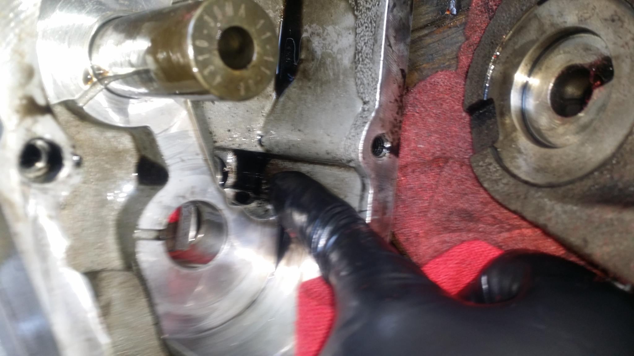

I might have a clue here.
Right one turns.
Left one doesn't.
04-13-2018, (Subject: CM871 oil pressure )
RE: CM871 oil pressure
Well I'll NEVER EVER put dimes in the regulator again. Five in 3 out. Small piece came out from internals of pump. Gears turning fine.
0 psi pressure. Wanna guess where the other 1 3/4 are? I sure would like to know! Hopefully in the rifle before the oil thermostat. Probably where the blockage is. Those dimes can turn right at the passage in the second pic if you aren't careful.
im very confused. you put dimes where and they went where? if you put them where they are supposed to go there is no way than can go anywhere and have done this dozens of times with 0 issues.
Oh boy this doesn't seem good
