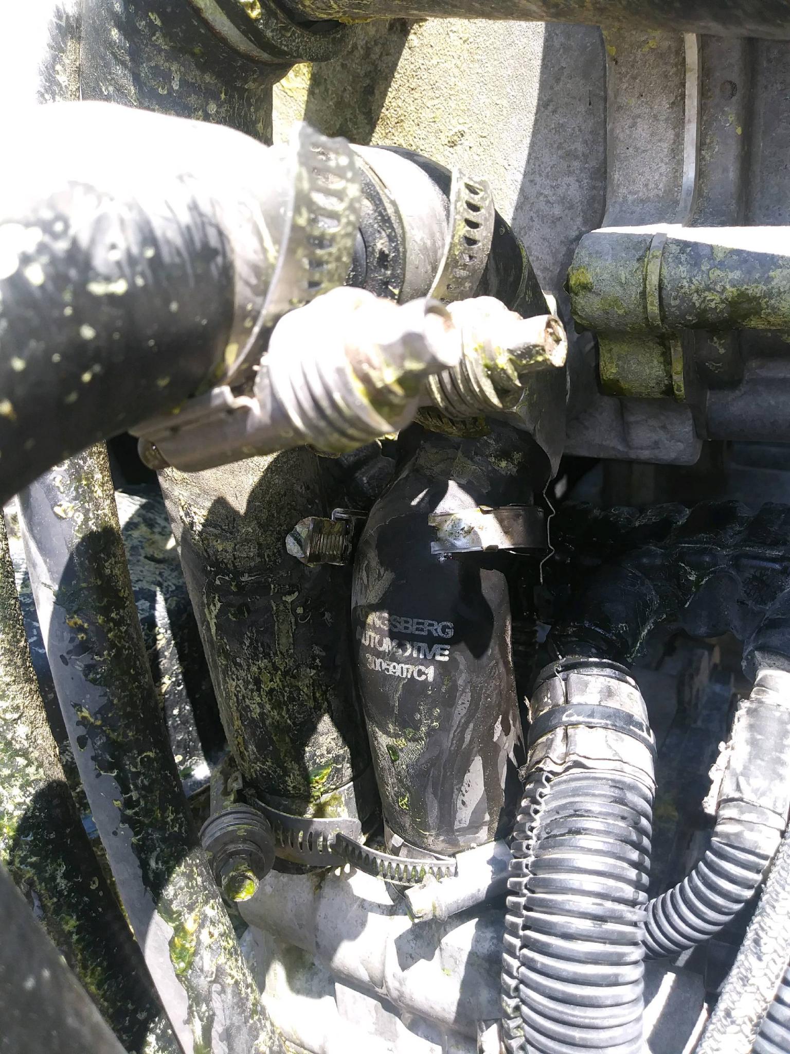

08-10-2018, (Subject: Loss of coolant )
RE: Loss of coolant
Well here was the problem
