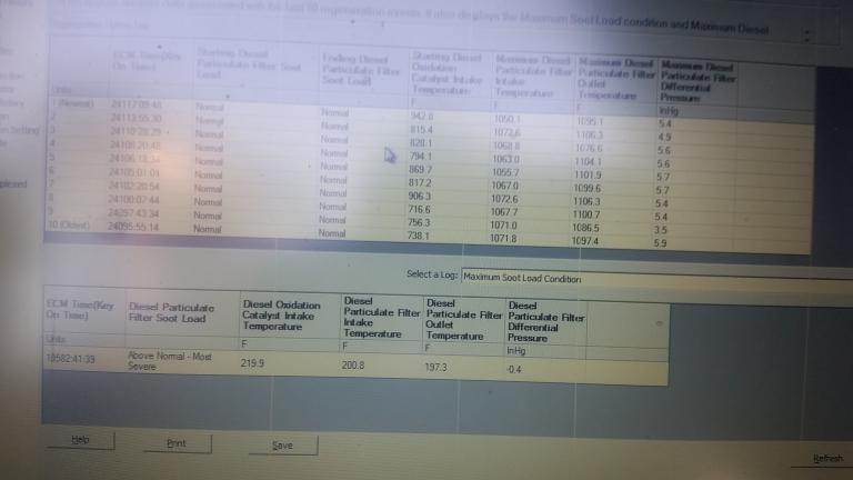

./uploads/201605/post_1367_1463430455_94f348c651c3fa40deefa2bc25bcb830.jpg
Here is my history. seems to be doing a regen every 2 hours....

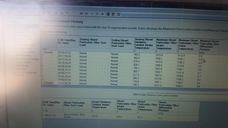

./uploads/201605/post_1367_1463430486_8b7768febbd09902e0775ec55be48ed1.jpg
Here is my history after my regen. The differential dropped drastically so let's hope it helps out.
Regen started at 1:38pm
Doser on at 2:05pm
Inlet and outlet above 1000 2:10am
Regen complete 2:18pm
Besides taking almost a half hour to fire the injector, all went well. the inlet and outlet temps were above 550 so I don't know what took so long to start.

(05-16-2016 )Brock Wrote:  Here is my history. seems to be doing a regen every 2 hours....
Doser on at 2:05pm
Check your below turbo flex pipe and V-clamps down to the doc for leaks or cracks. Its may cause the after treatment fuel ignite too early, clogging your 7th injector and the doc face
HOLY CRAP BATMAN!!!---- That regen history looks HORRIBLE! --- ANYTHING ABOVE 3.0 is not good!!! --- you have some plugging issues and/or a failing Doser injector. Driving around with 5+ all the time can shorten the life of the injectors and pistons. 8+ can burn through valves or crack pistons!,.. you are not far from this point!.
i was gonna say, i hate to tell you this bud but your done. that filter is plugged and is most likely beyond cleaning now. hell 3 is plugged and i see 5.5's and higher in yours every 2 hours.
I just did a egr tuneup including a new doser. this is the first forced regen I have done since.
What I want to know now is my last regen went down to .9
That would mean all is well?
.9 is a acceptable number, hell 3.0 is a acceptable number. if it stays lower you may have snuck through, but experience tells me that this is not usually the case.

One other thing I see is the catilest temps are pretty high I like to see that number around 5 to 6 hundred. What that tells me is that filter is probably toast or at the very least needs cleaning. Also, the doc outlet temp is not in sink with the doc inlet temp,again, may need cleaning at the very least.
Most of the time if doc temp goes over 1160 on most trucks,it will fail regen so watch for that. It's a indication that the doc temp sensor is bad or maybe the doser is over fueling or the turbo is out of calibration.
