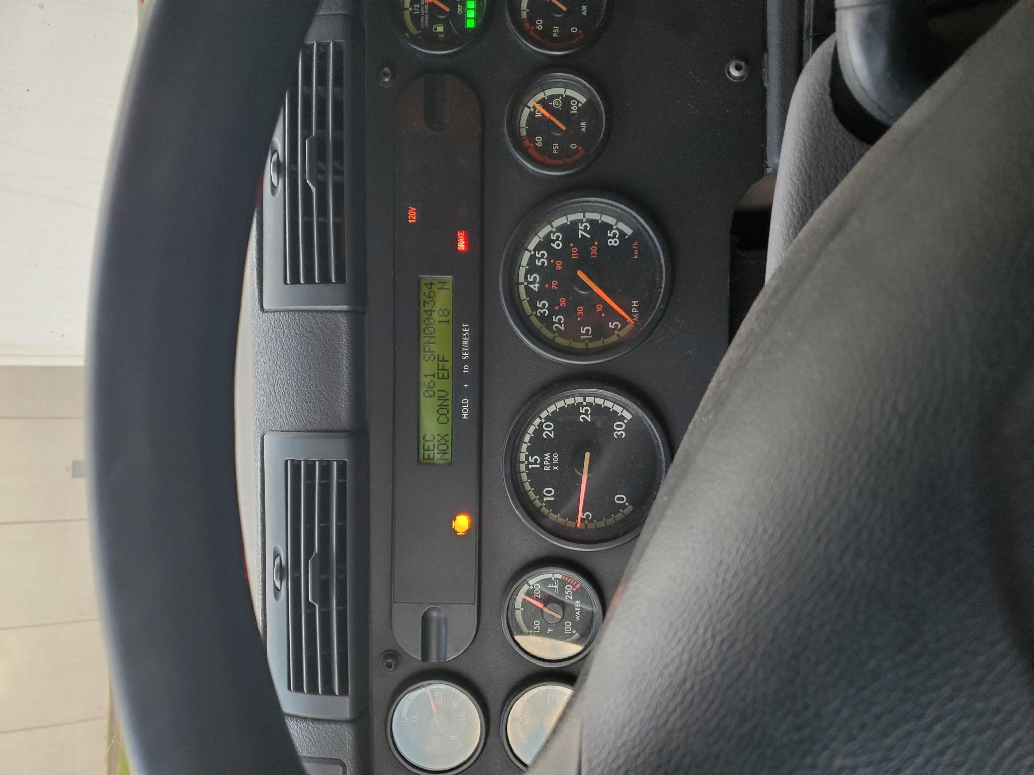

|  This dang freightliner    This is a repost I think I posted the original in the wrong section. Alright guys I'm in Dayton New Jersey at the moment and my check engine light is back on I've got a dd13 with a 10 speed smartshift I just got the truck out of the shop 2 days ago and $6700 later for a clutch, electronic clutch actuator rear main all that good stuff and now my check engine light is on for nox conversion efficiency code spn004364 fmi 18 and the same code fmi 1 I'm cleared out right now I've spent well over 10k fixing stuff on this truck in the last few months does anyone know of a shop nearby that can demandate this thing and if so how much? I don't care about extra power or anything like that I just need my truck to run and be reliable so I can keep a roof over my families head right now any help is appreciated thank you.    |  |||
