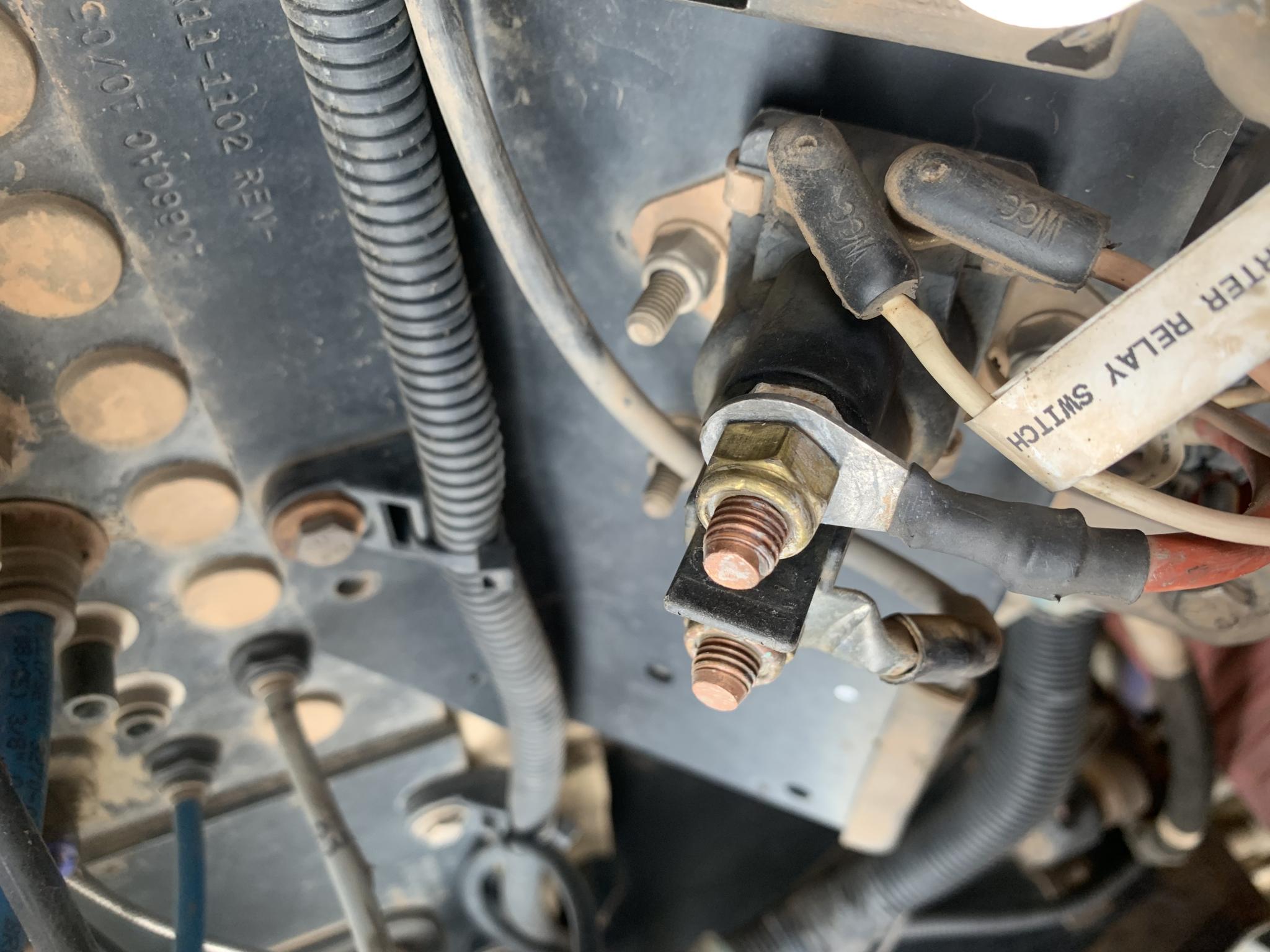

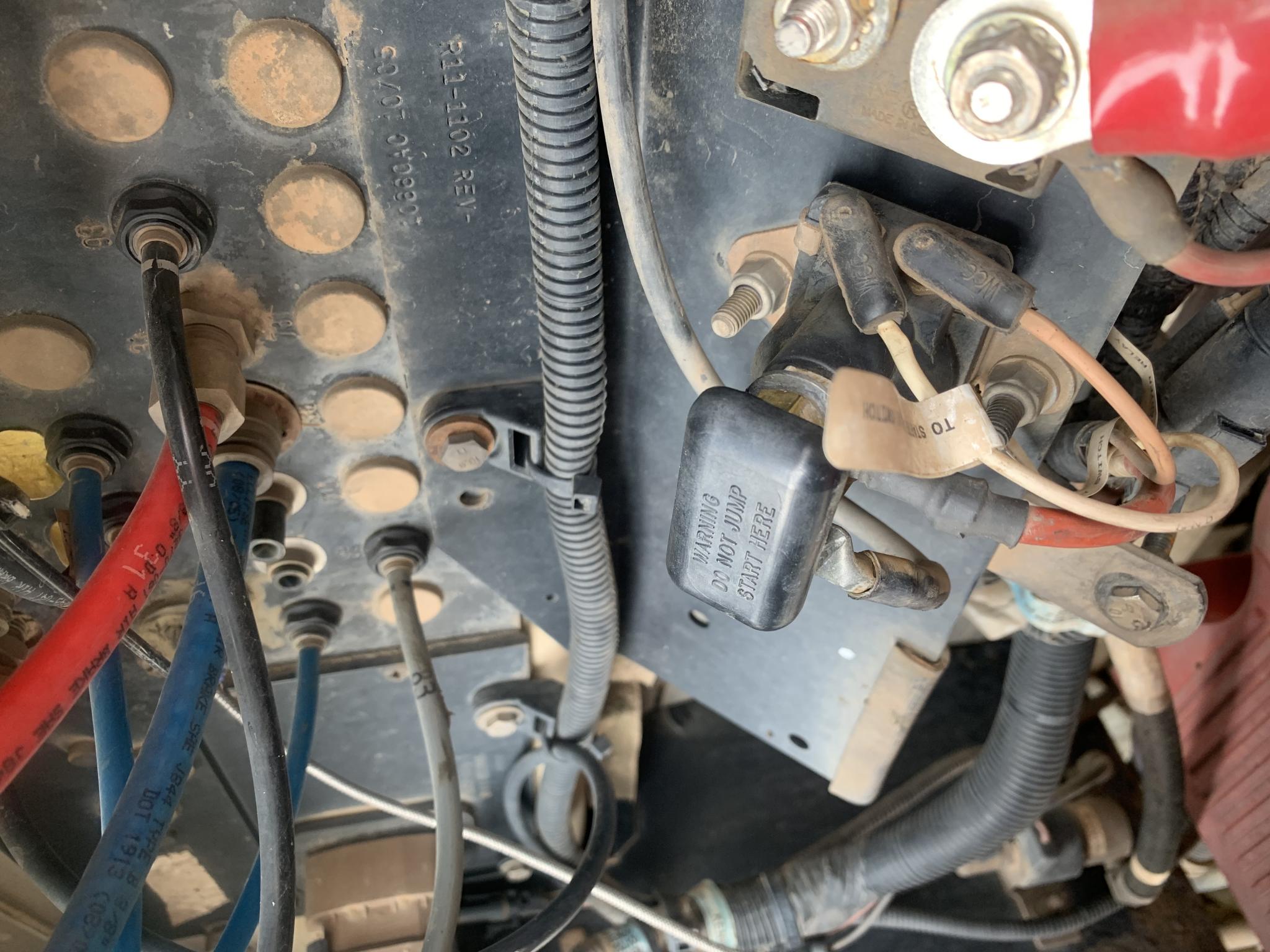

What’s the proper way to test the starter relay switch? Every now and then ill go to start up, I’ll hear a loud click then nothing happens(zero cranking). I key off, wait a bit, then try again and it usually works fine. I’m assuming this is the problem? My starter is only a year old and all of my wires and connections seem fine.
06 KW T800 cm870
Thanks in advanced for any input- Andre

(09-14-2019 )Andre_The_Giant Wrote:  What’s the proper way to test the starter relay switch? Every now and then ill go to start up, I’ll hear a loud click then nothing happens(zero cranking). I key off, wait a bit, then try again and it usually works fine. I’m assuming this is the problem? My starter is only a year old and all of my wires and connections seem fine.
06 KW T800 cm870
Are you sure that is the starter solenoid? That looks like some other power source to the starter. The starter should have a solenoid that engages bendix gear and power the the starter motor.
06 KW T800 cm870
The picture is of the Relay, should I be testing the solenoid instead?
