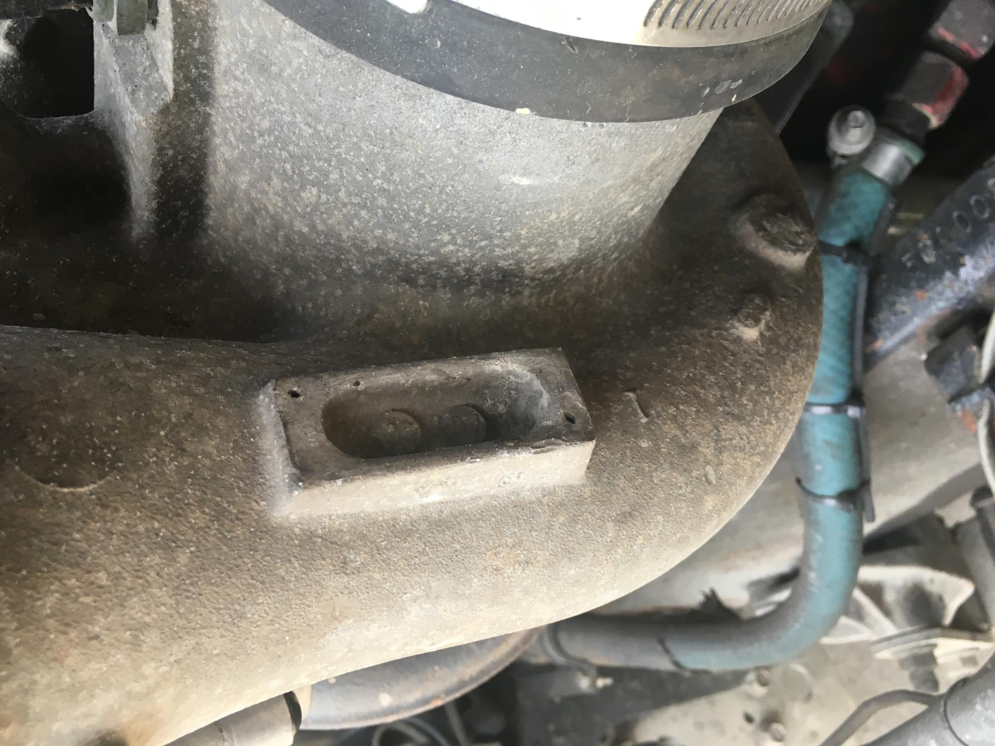

Turbo ID
Is that where the ID tag goes?
If it is, it’s missing.
Any other way to ID this?
11-23-2019, (Subject: Turbo ID )
RE: Turbo ID
That's where mine was, WAS, it came off when I put the turbo on. Been on a couple of years now, thank God it's lasted longer than the tag.
RE: Turbo ID
No, it gives the assembly number and that's the only place they put it.
With the ESN you can say what it should be but you wouldn't be able to verify that.

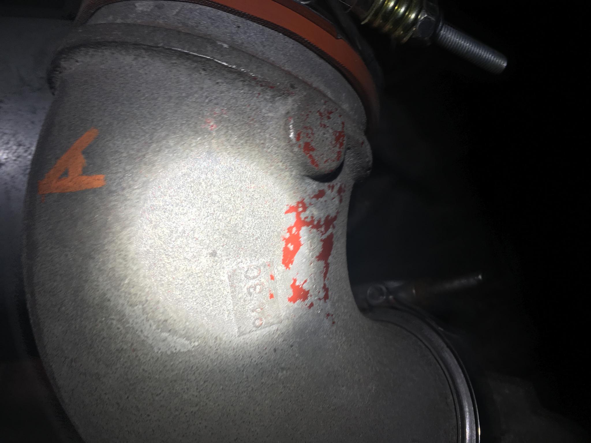

What is the part# stamped into the elbow connector pipe coming off the turbo towards the charge air cooler?
RE: Turbo ID
(11-23-2019 )Rawze Wrote:  What is the part# stamped into the elbow connector pipe coming off the turbo towards the charge air cooler?
Looks like 94 3C
