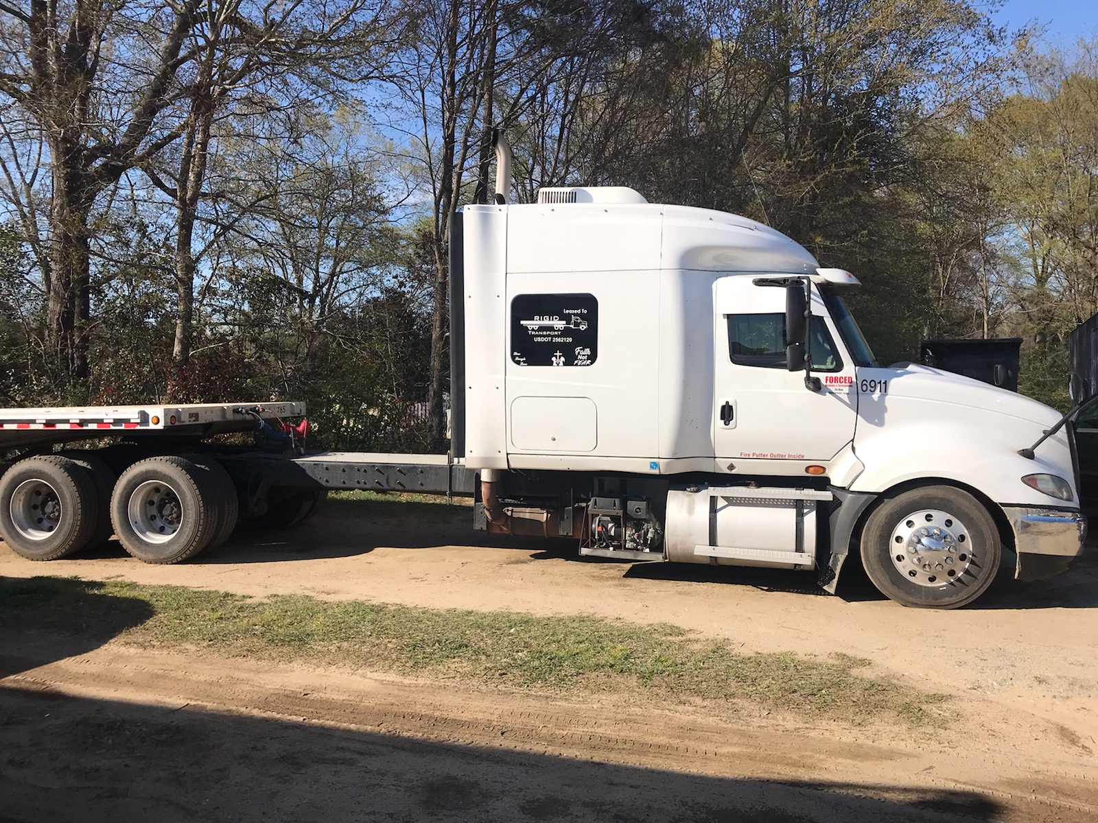

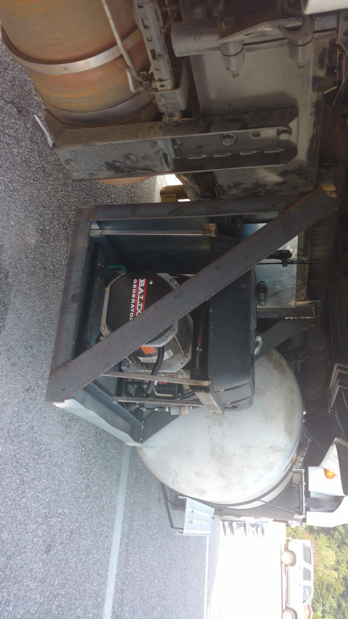

Sorry to change subject,
I see Your APU can you share details!

That's a Hatz 3000 diesel generator, I used it to run my roof mount AC. I had it on there a long time and it always worked like a champ. Never had to do anything but change the oil. But I messed it up, the roof mount was running when I turned it off. I think the compressor was kicked in pulling a lot of power. And it messed the head up, it starts right up but won't make power. I need to take it off and either fix it or put a Honda 2800 I have there. I'm fine either way, I have a soft start in the roof mount so the Honda will run it. The Hatz is a bit loud but I almost always park the job site so it doesn't matter. I just have never been a fan of the tri pack set ups. They cost to much and to many issues.
First picture was when I bought it the other are after I mounted it.
