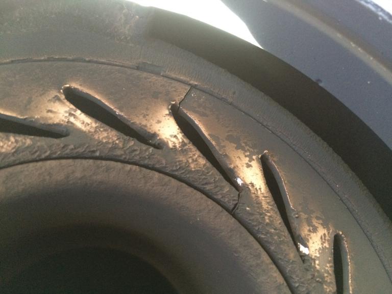

Don't be surprised if upon disassembly you see something like this.
Just pull this turbo and do a real inspection before it's too late!
./uploads/201606/post_1240_1467170995_9563bec48762cdd35ea8c360198e314b.jpeg
And Rawze is spot on .

(06-28-2016 )Wiseman Wrote:  Don't be surprised if upon disassembly you see something like this.
Nice pic wiseman,.. thanks.
No problem . That's why we're here for .

Thanks for the replies. Think I am just gonna have to take it and have someone tear it apart so I can know for sure. Would this also be a cause for the smoke after idling. Also noticed that if rpm is near 1200 there is no pull on acceleration. Doesn't matter if loaded or empty. Ther wow a noticeable lack of power. The best way to explain it if cruising at 1200 and I give it some fuel it's as if pressing on the brake at the same time.
06-29-2016, (Subject: Turbo squealing )
RE: Turbo squealing
Very possible cause for to much smoke after idling is leaking oil from shaft seal ! There's not enough temperature to burn it off during idling and oil accumulate in the housing. Other possible cause is exhaust valves stem seals popped out of the valve guide and oil seeping into exhaust manifold. Both causes are very bad for everything down the line !
I think most likely your turbo is gone . At this point there's nothing to be afraid of . Just pull it off and use it to learn . Make pictures. Ask questions. We're here to help !
