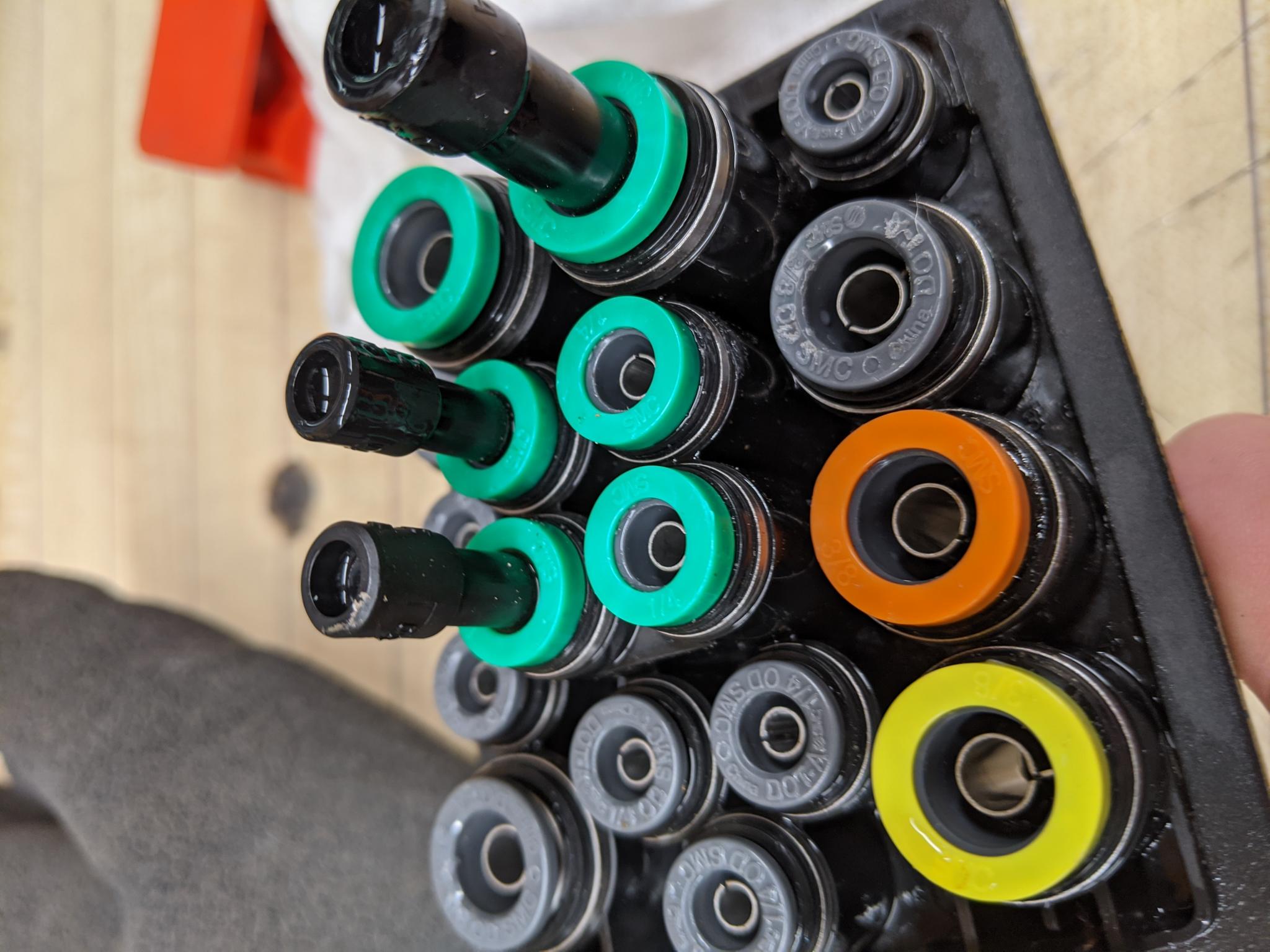

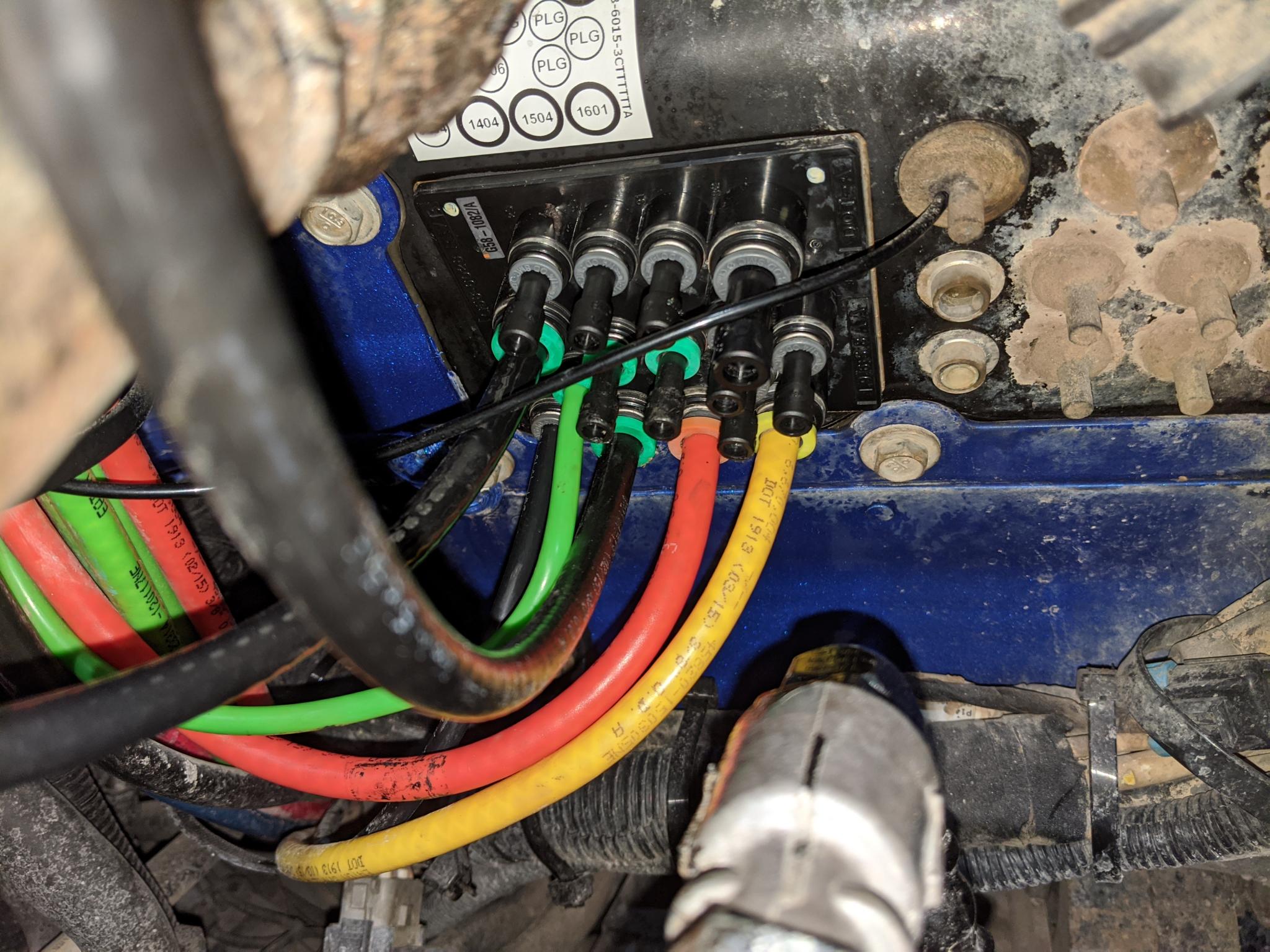

I'm fighting air leaks on this plastic square of push fittings on my t880. Can I replace this whole thing with some compression fittings or am I stuck buying a new one of these? The only thing holding me back from replacing it with compression fittings is that one side of this thing has 6 lines going in it and the other side has 7. So somewhere something must be supplying air for multiple lines.

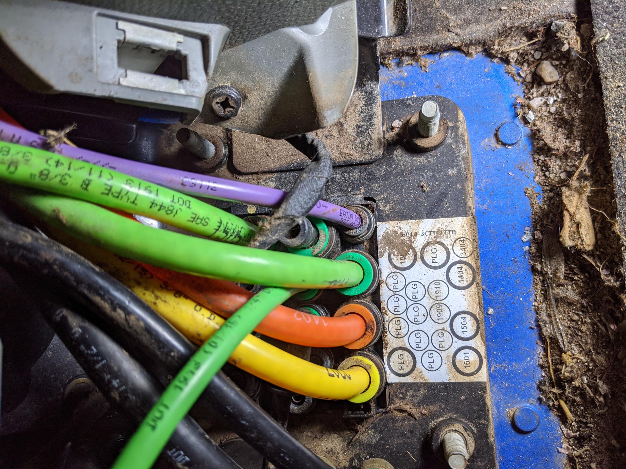

Just replaced that in my 2012 pete 587. Some of them have a common air supply, so it's not just straight through. Also, when I pulled a line out of mine the brass sleeve got stuck in the end. Never could get it to reseal correctly after that. You could probably make your own with a bunch of fittings and T's, but it'd probably cost about the same once you were done.
Just a word of caution, put labels on each line as you take it out. Most are color coded, but there are a few that look identical. When I did mine i swapped 2 black ones. Didn't even notice until I went to hit the air horn during an annual inspection and instead of the horn all I got was air pissing out the quick release. Real easy to get em mixed up. Also found that I needed to snip the ends of each hose because the previous manifold had dug some nice grooves into the outside.
damn thing wasn't cheap either. $200+ from the pete dealer.
On the bright side, one of the unused spots in the manifold turned out to be a great place to pipe my boost gauge through the firewall. I just snaked the 1/8" hose through one of the unused ports.

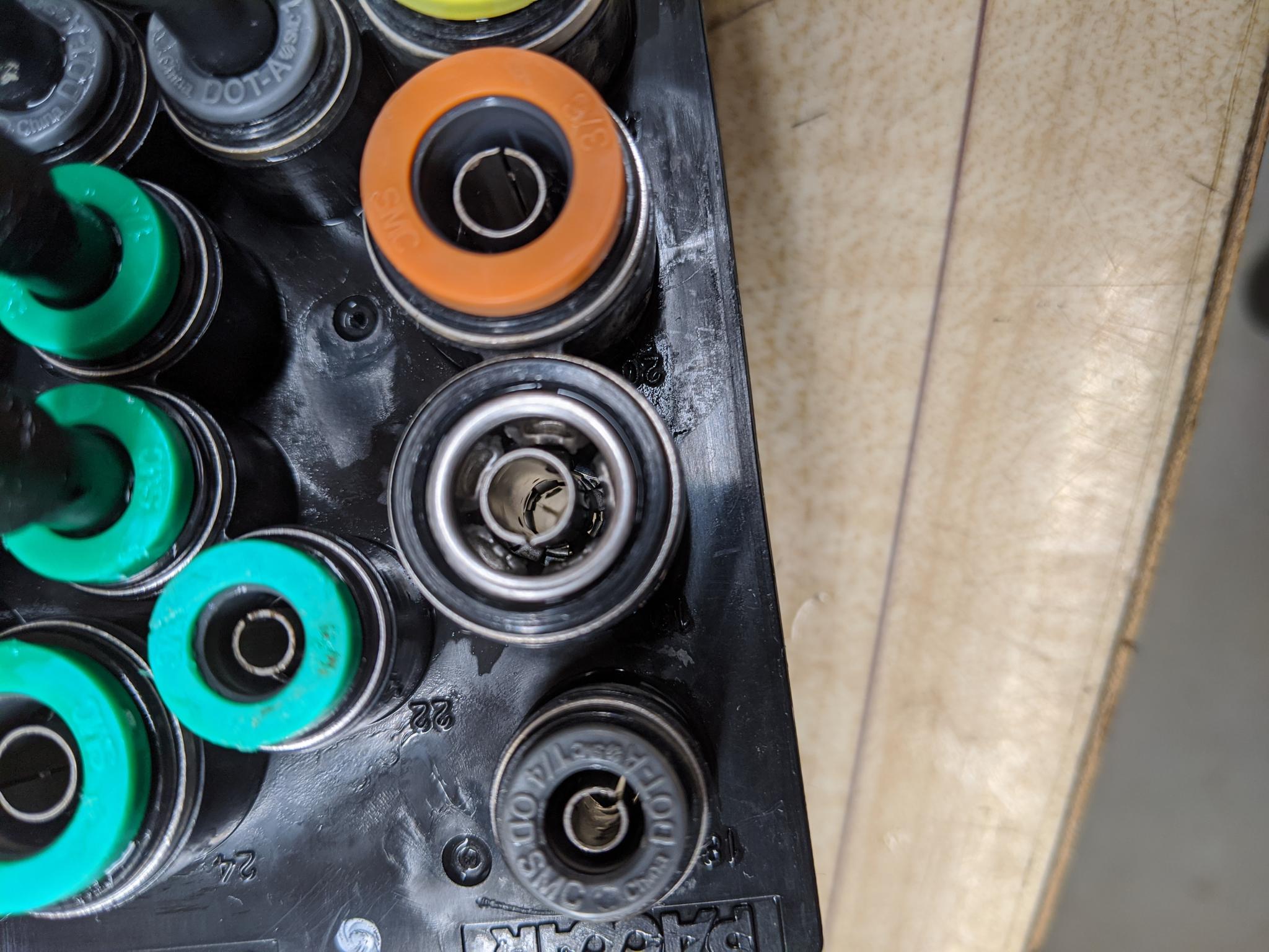

I'm not sure these have the orings I'm used to seeing in push fittings. Got the collet off but the insert seems to go all the way through and I'm not sure how to get it out to get to the orings like I normally do. Might just clean it up good and see if that helps before getting a new one.
I did find the group that seems tied together. The rest look like they pass right through.
