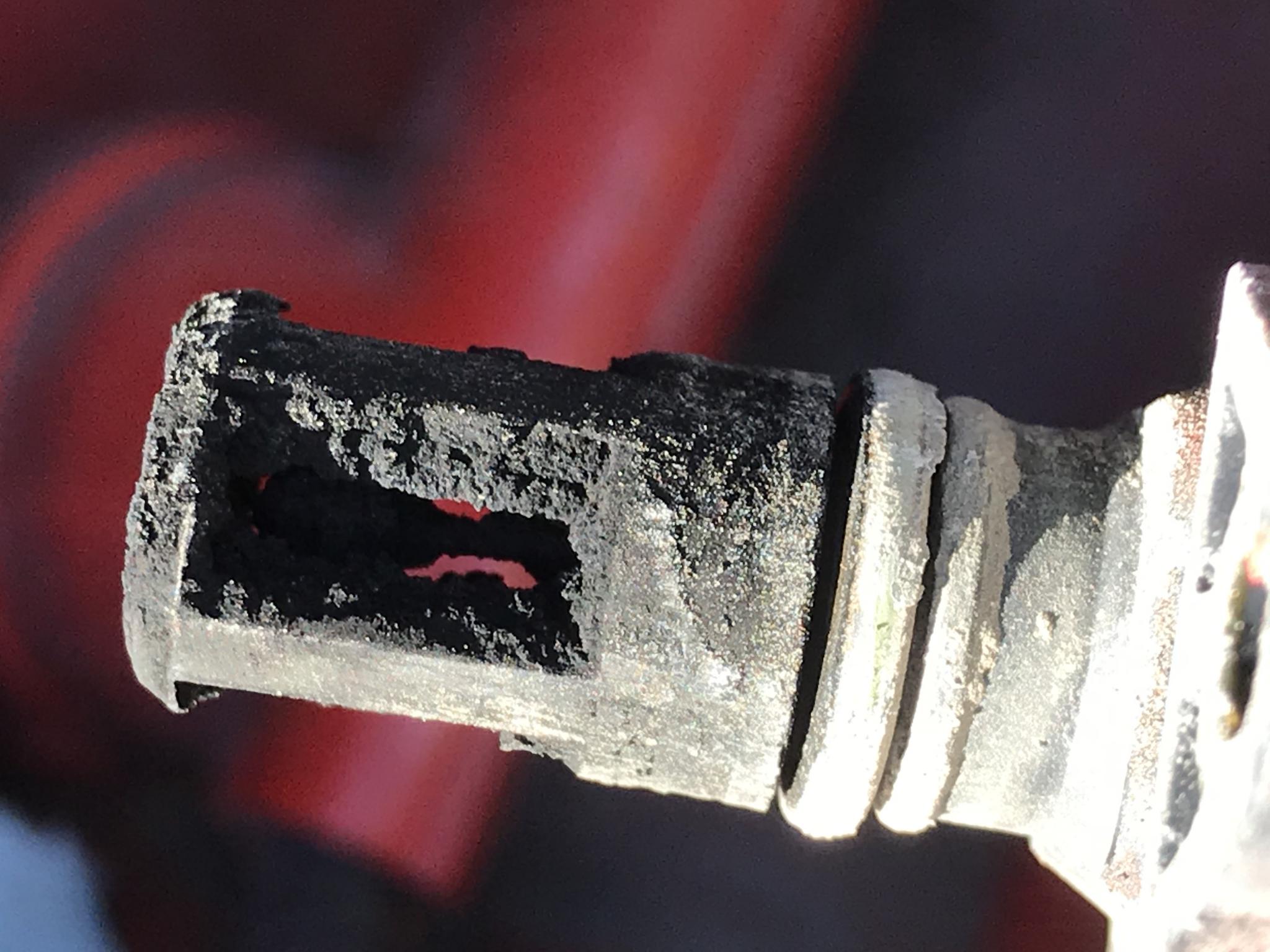

So I just purchased this tractor not long ago.
I finally pulled the IMAP and cleaned it.
This is what it looked like at 295K miles.
How often should I clean it?
Thank you

you should replace it

Put in a new one and call it good.

(02-18-2020 )Unilevers Wrote:  you should replace it
Yeahs I’m sure that's a good idea.
I took a toothbrush to it for now.
Now I have to find out where the rest of the sensors are located on this X15.
IMAP is the only one I'm familiar with.

(02-18-2020 )Mattman Wrote:  Put in a new one and call it good.
Yeah hopefully Peterbilt stocks them or I can locate a cummins dealer.
Thanks.
Would you know where I can look up the location of the other sensors that I should be replacing are located?

QuickServe. Register for free. It’ll tell you everything. And most all kw Freightliner and peterbuilt including Cummins should carry them without issues. I never had problem finding them.

REPLACE IT IF IT IS MORE THEN A YEAR OLD, YOU CANNOT CLEAN IT PROPERLY, IT IS IMPOSSIBLE!
