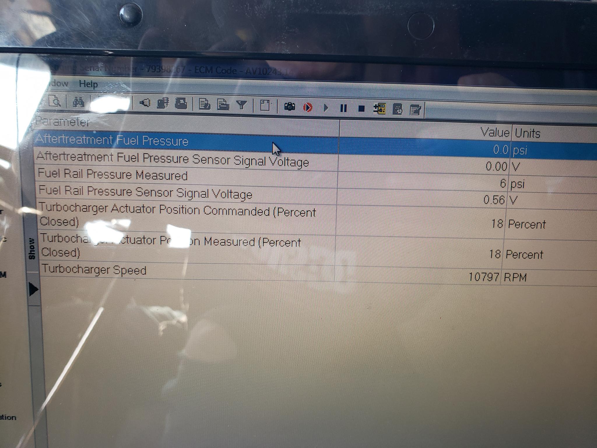

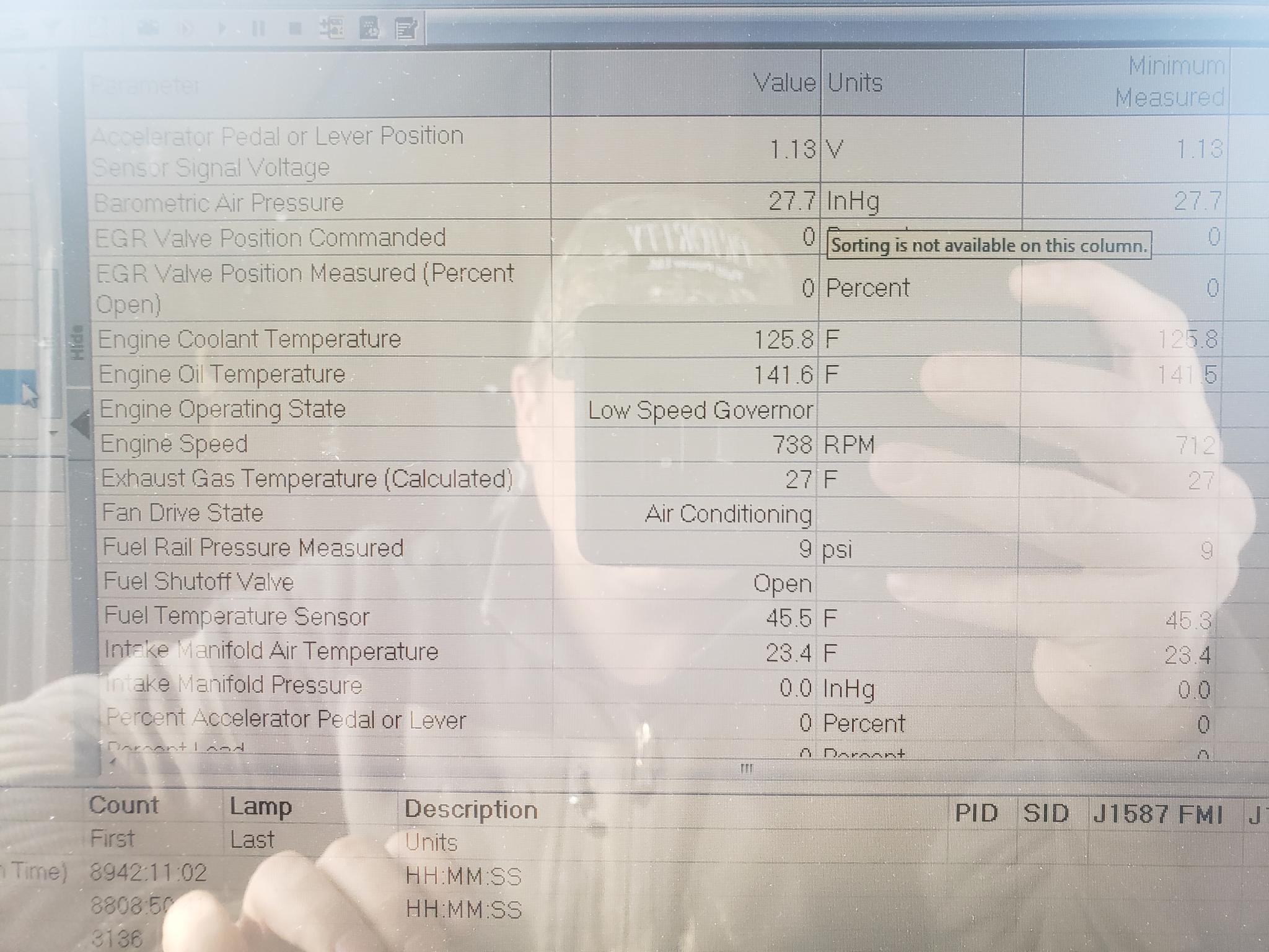

Thanks for the link. The fuel pump was the first thing I was going to check, that thread nicely explains what cranking pressure I'm looking for.
Any idea on what kind of fuel pressure at idle I should be seeing on insite? Mines 9psi... just curiosity

Im pretty sure the truck won't start or run at 9psi my dad's 870 wouldn't even try when his pump went out but still made 30psi . You probably have bad wiring or sensor if it says 9psi and it's running. And that low psi reading is probably pissing the ECM right off causing it to run poor

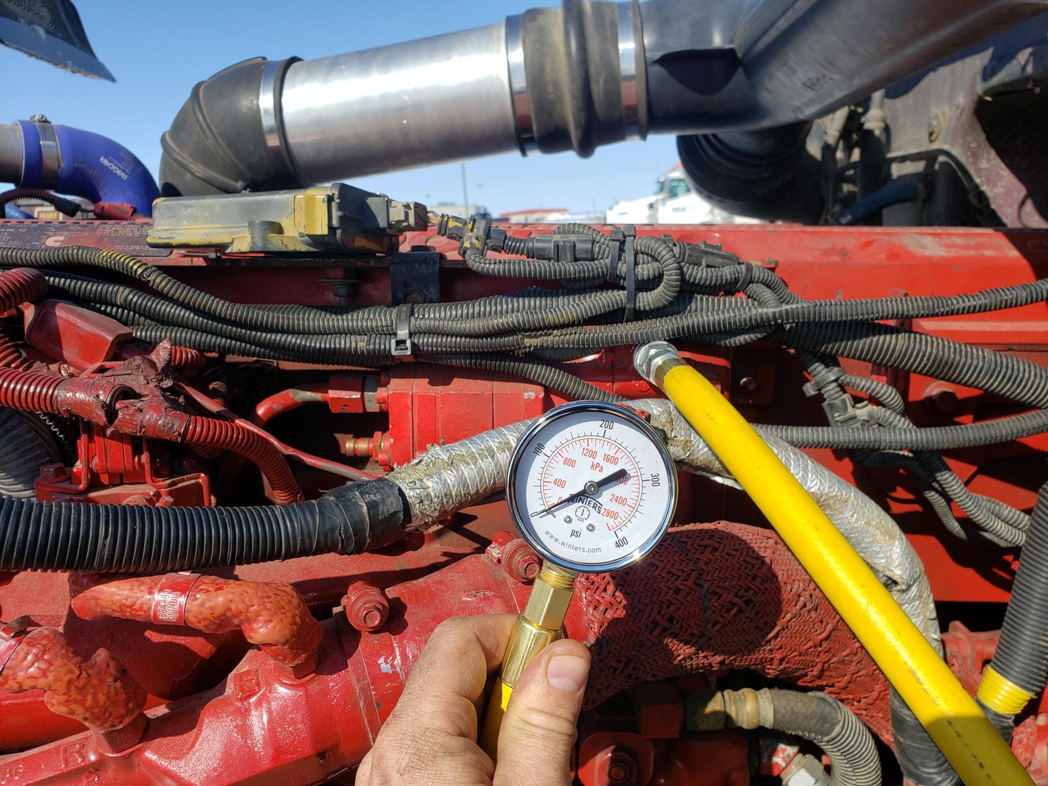

Going to put a manual guage on the compucheck fitting at the fuel pump and see what's going on there....
04-03-2020, (Subject: Code 2215 low fuel pressure )
RE: Code 2216 low fuel pressure

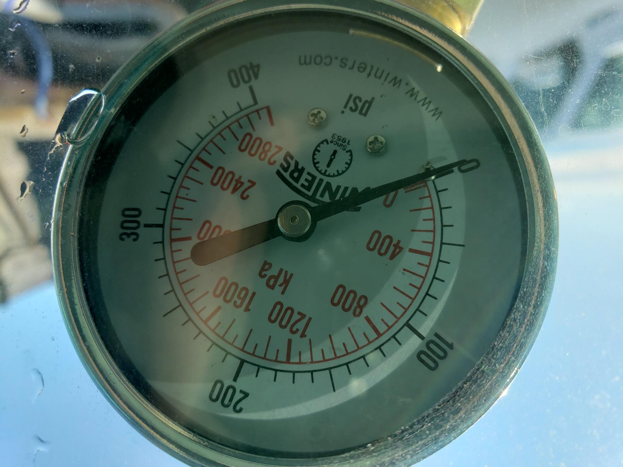

This is with the truck running at 800rpm. It moves a couple psi but that's it, I thought the lift pump was supposed to put out around 20psi?
Gonna go verify this guage on another truck right now. I just bought it and put it together so maybe its buggered or something.
Trucks somehow running on 5psi?
https://youtu.be/qYnJqwoXlcw
This is me measuring at the fuel pump.
https://youtu.be/n-QwD6wRa84
Took a measurement from another fitting and got a reading, jumping around alot though.
I'm starting to think a inlet line restriction or bad lift pump.... onto the next tests!
