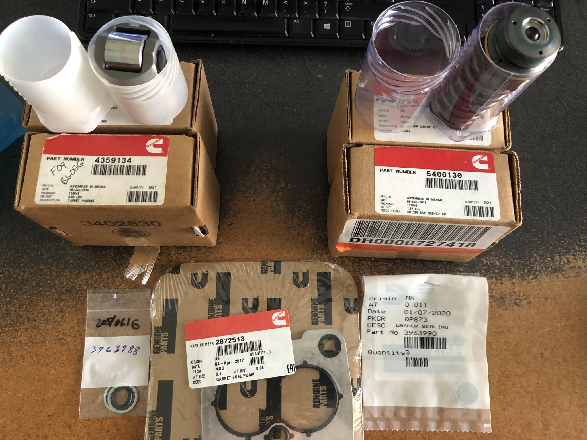

Here are the parts and pricing.
2013 ISX15 CM2350 Fuel Pump Rebuild
$440.93
I asked the parts guy about what many here say that rebuild of the 2350 fuel pump isn’t possible that must only purchase a new Head.
He said and I quote “I have no idea what you’re talking about. We sell these all the time.”
Why some are unable to buy rebuild parts...no clue.

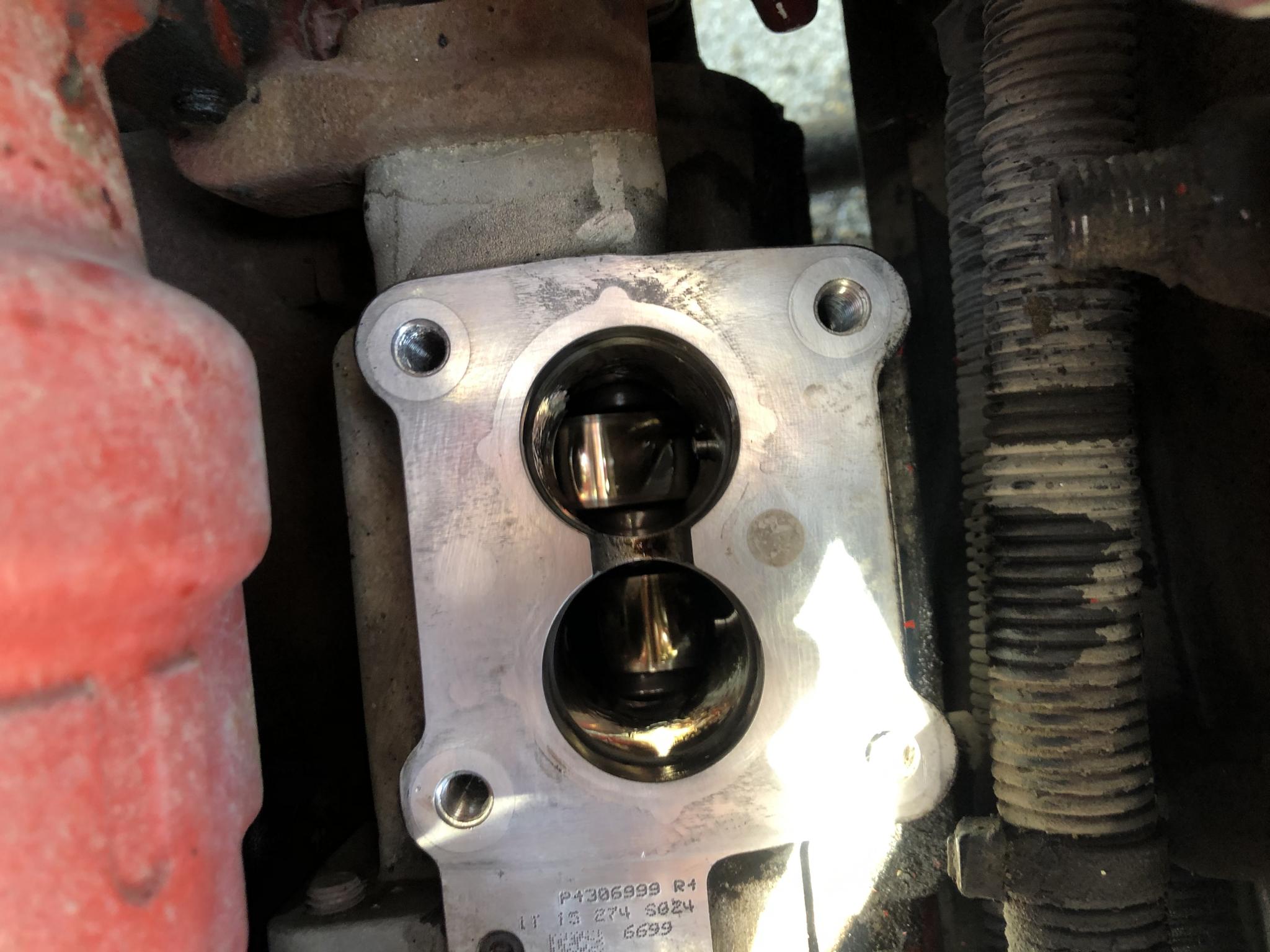

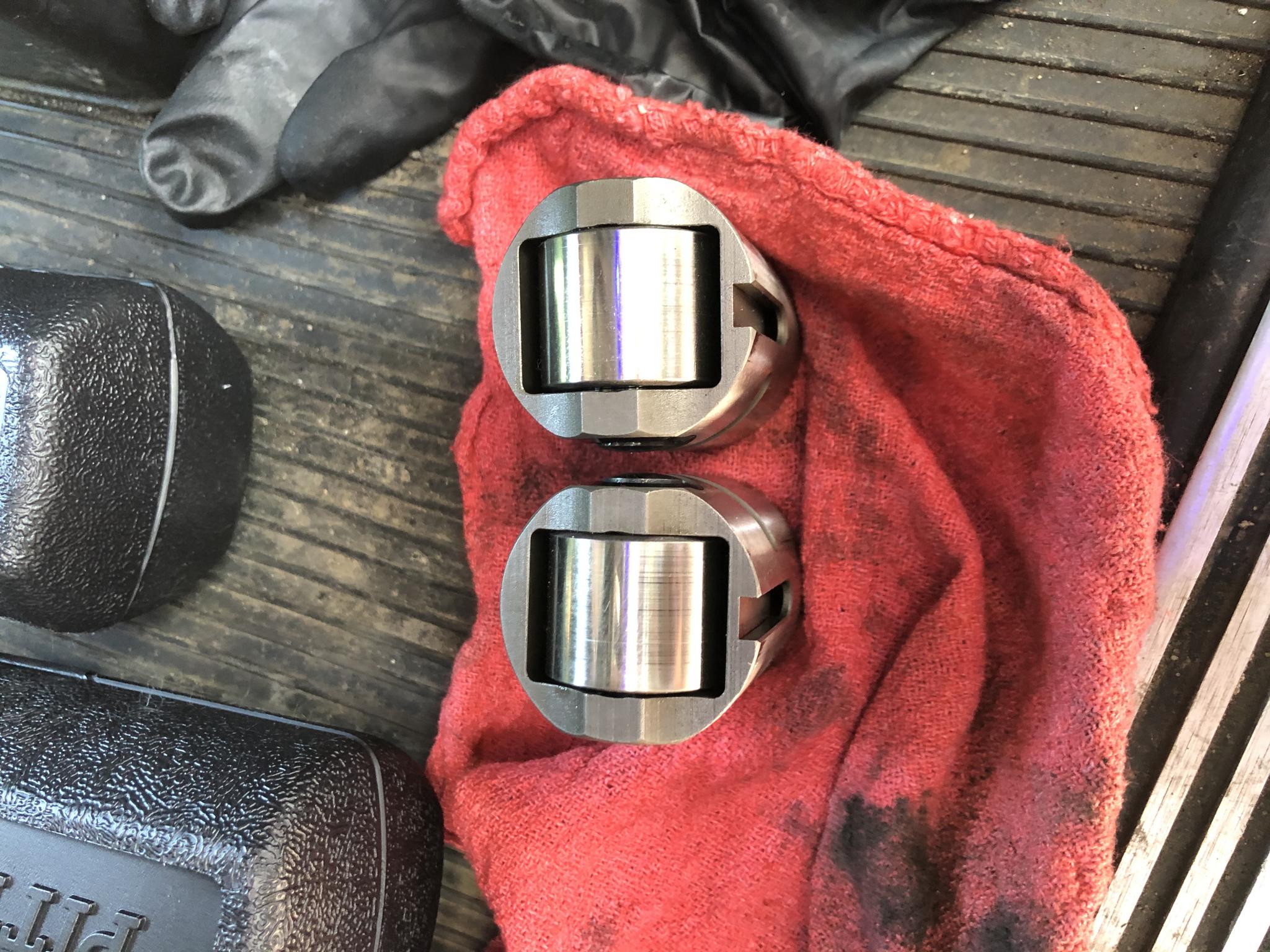

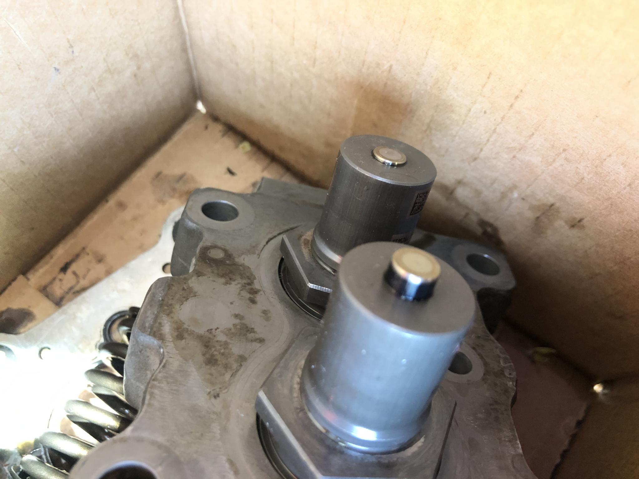

The rebuild is done. I must admit that having never done anything like this before I was sweating bullets starting it up for the first time. I primed it twice and then cranked it for about 5 seconds before it fired off. Let run and brought temp up to 150ish or so. No leaks thus far idling nicely.
Like others have stated all old parts looked great. No visible signs of impending death. There was the slightest bit of polishing just below the roller (see photo closely) but that was the only thing i saw. The cam was clean. Rollers clean. No wear on plunger that i saw.
